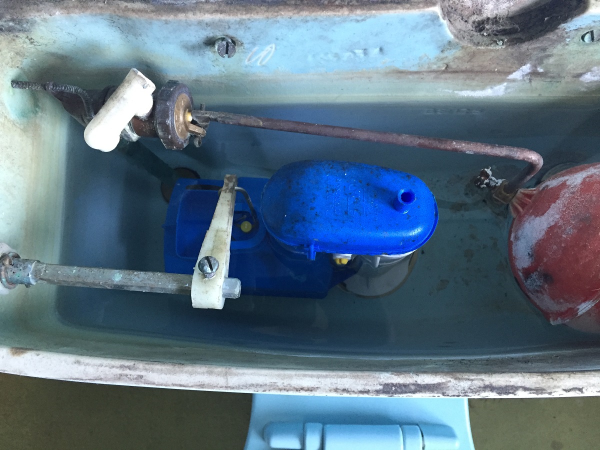

Hi, just come across the thread. We have one of these toilets and had the innards of the cistern replaced about a year ago. As suggested, the toilet now only flushes with half the force and, whilst adequate, really needs sorting. I am pretty sure all the components are there but the flush mechanism is desgned for too low water out. I wonder if there is a recommended replacement part. The toilet is made by armitage shanks. Thanks
Hi and thanks for coming back. We are just about to start renovating the house and was looking to change the bathroom suite. However, the existing toilet appears to be really good quality and we would be interested in fixing it if we could find the correct parts. A local plumber fitted the part shown below which can be set to 4l or 6l - I think this cistern needs 9L but not too sure?

There should be a special valve (which plumbers call a bomb) in the throat where the cistern and pan join. About half the size of a small coke bottle. It might be worn out. Spares are still available.
John D is right and luckily you can take the syphon out by pushing out that yellow pin - look down the tube in the cistern and you should see the bomb. If it's there then replace the syphon making sure there are no holes unplugged in the square part (6l. flush with hole open) put it back and adjust water level as high as you can without it running down the syphon. See what happens then.:notworthy:

From my limited D-I-Y experience the 'bomb' itself can't really wear out as it is just a circular piece of plastic.
HOWEVER the rubber washer/grommet that seals the bomb to the toilet body will wear out and without the seal you will not have syphonic action.
I did source a complete bomb for one toilet only to find that it just needed the washer.
On my other toilet I just purchased a washer from 'Tool Station'.

I know next to nothing about them, but I understand you need a traditional syphon, not one of the modern quiet flushing valves. One of my relations had a flapper fitted, and the syphonic WC never worked properly again. It should suck the pan and trap empty first, then perform the wash-down and refill (perhaps they are others that work differently)
You're right John - the syphon fitted is OK and easy to replace the diaphragm - awaiting report from O.P:notworthy: The wash down is constant with the flush if you're a pedant like me;) pretty much all the same principal with a vacuum between 2 traps - even ones from the 1930's with a lead trap on the floor.
