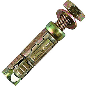

I want to insert a 'screw socket' into the wall, so I can screw and unscrew smaller screws or bolts in.
What should I be searching for?
I found grub sockets - but these look too small.
I also found 'wall fixing anchors' is this what I need?
Else... what should I be looking for?
What do you want to do?
Threaded insert/bush springs to mind
If fitted to timber, Tnut would do what you want
Yes, Hollow Wall Anchors for plasterboard.
You need the tool for fitting them; you will ruin the board by trying to do it with a screwdriver.
or
Wallbolt (shield) anchors for masonry
