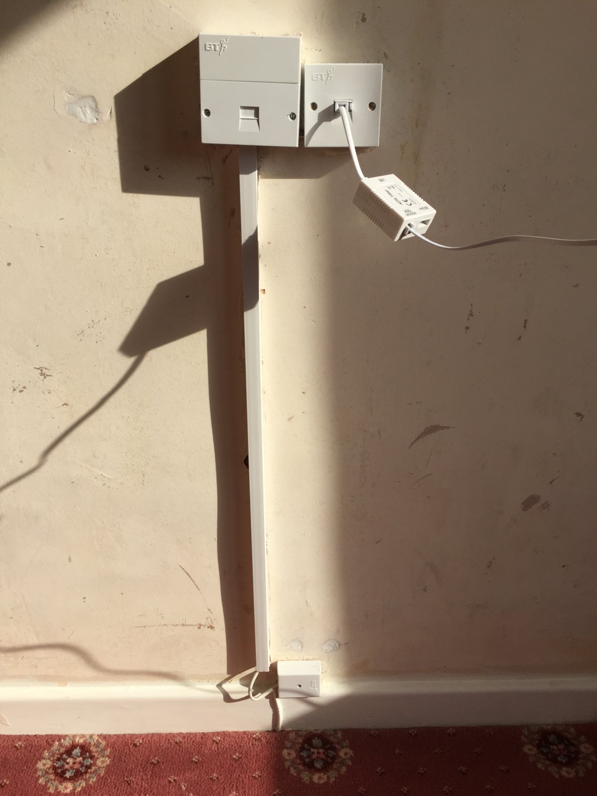

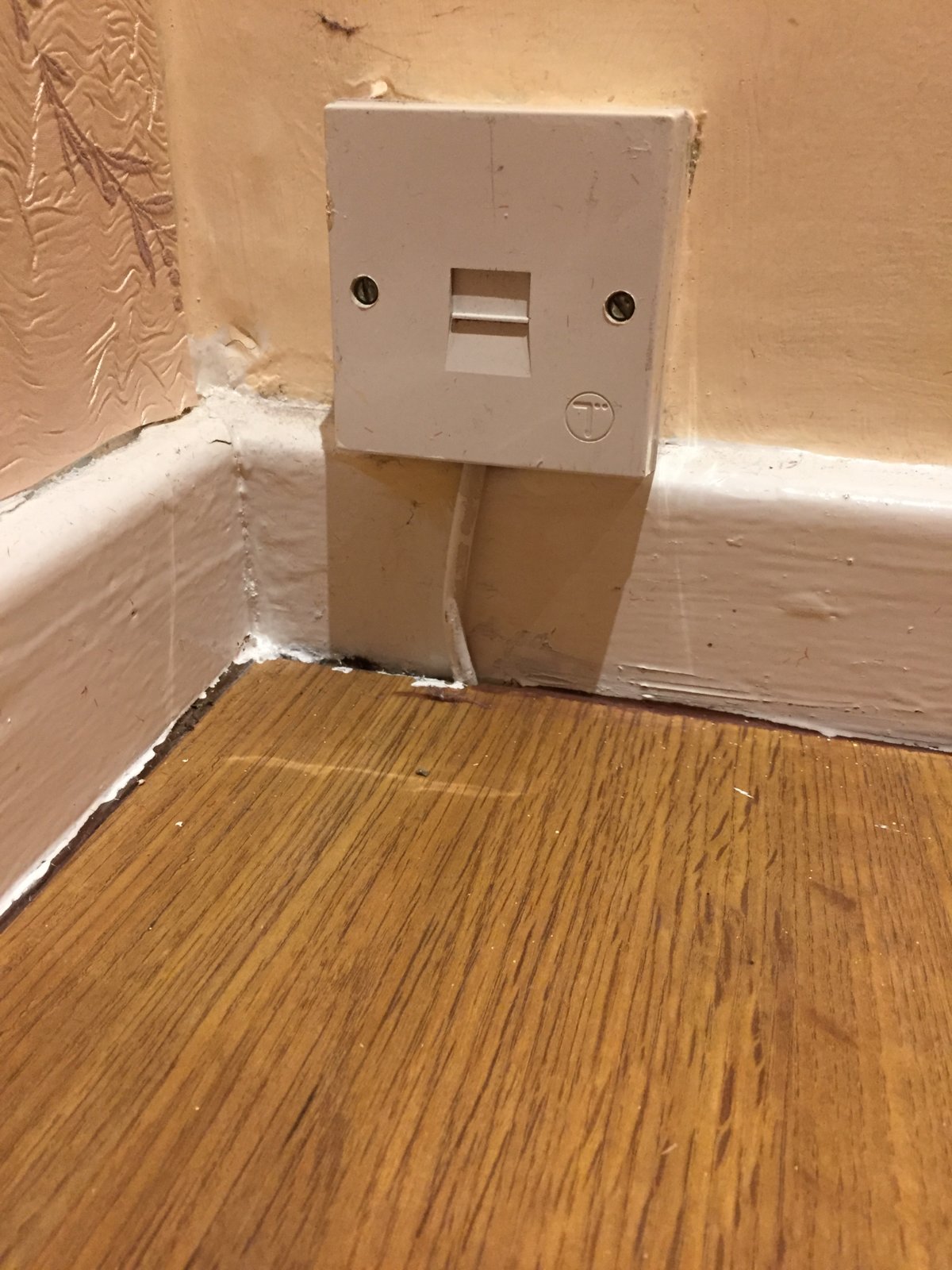

Hi all,
Just moved into a house and am trying to work out how the internal telephone wiring is done. Had cable at my last place so done very little with BT wiring in the past.
Facts:
There is a master socket and 3 extension sockets (though 2 of the exts are in the same room... I'll get to that!)
Our alarm system is somehow wired into the phone as the previous owner had a subscription for that. We don't and would like to disconnect it if we can as it still tries to dial out now and again, causing small call charges.
So the master socket in the main bedroom has two visible cables coming out of it, suggesting its extended to 2 different points. One of these must be the bottom of the stairs, where there's an extension socket. Haven't had the front off that extension yet but will update when I have. Here's the outside of the master:

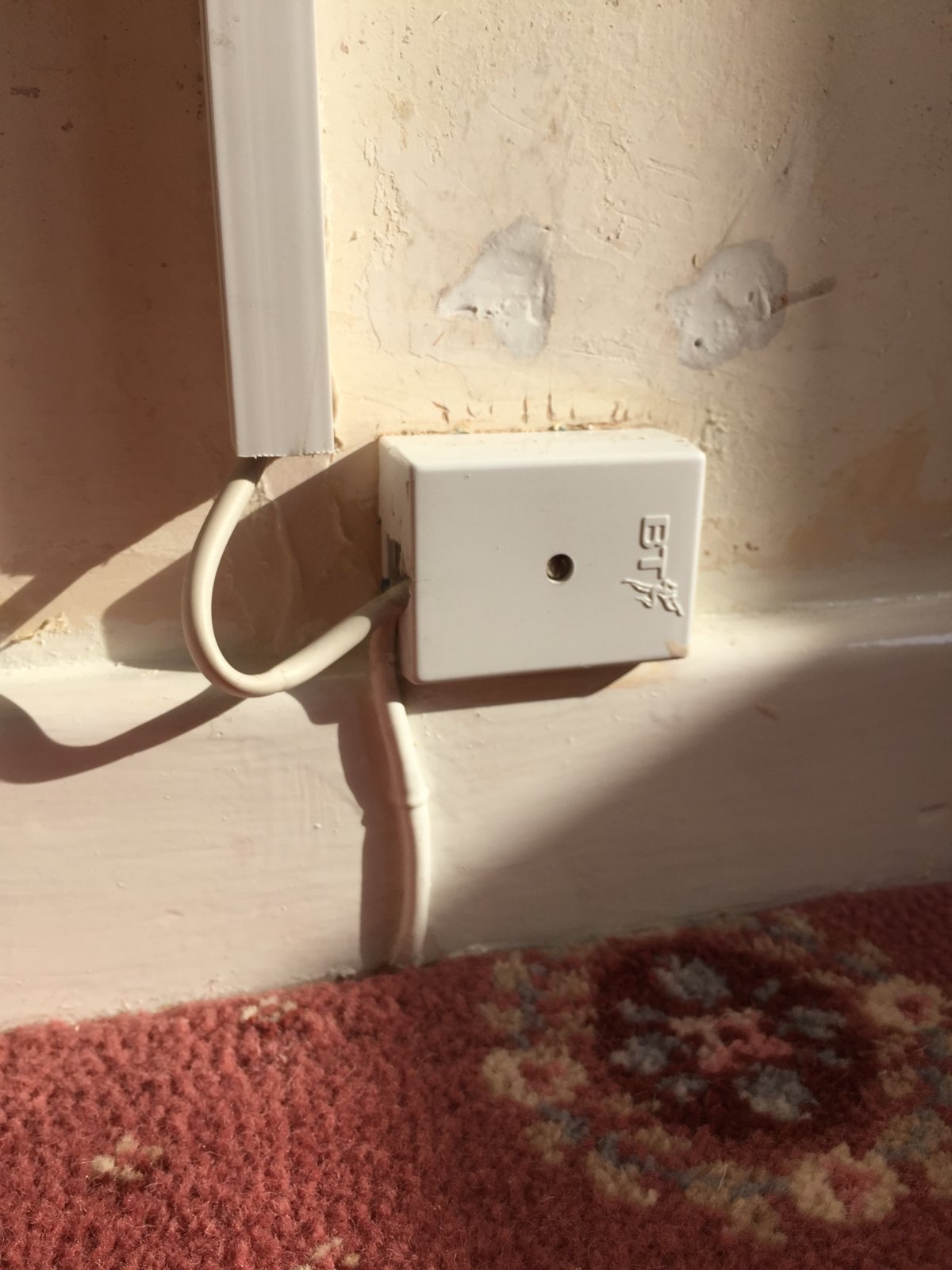

The second extension must lead to another bedroom, where there's a weird arrangement going on:
A cable comes up from the floor to this small box, which from looking inside appears to just be a "one in one out" junction - the coloured wires from both sides are terminated in the same points:
From the filled holes on the wall, I think someone has decided they want the phone socket at desk level and put this junction in to do it (they'd also done this with a mains socket nearby)
Above, at the top of the trunking, we have this:

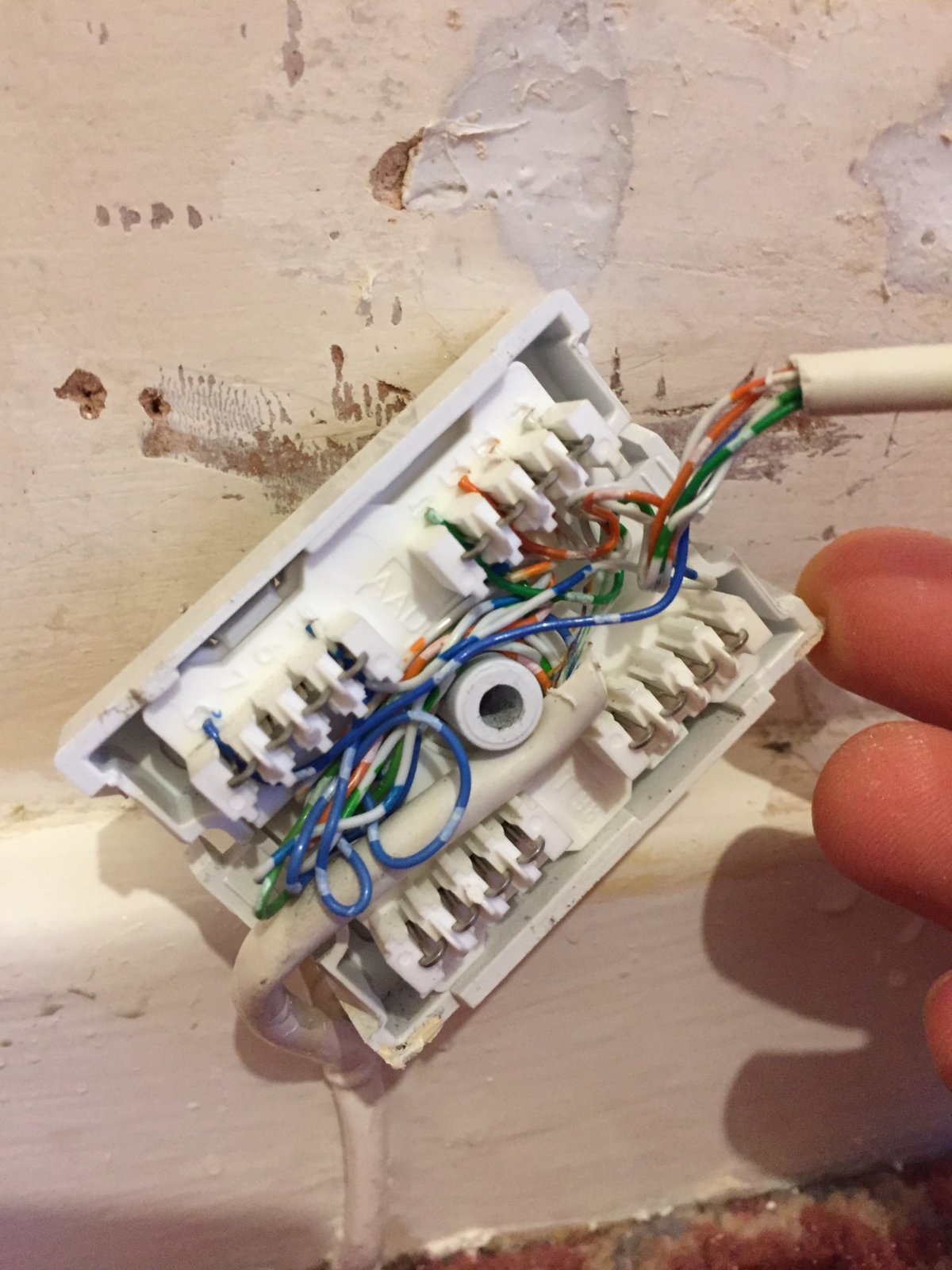

The larger socket (NTE5 I think?) has a removable lower half with no wires connected, and then further removing the faceplate reveals this:
Just two connections, blue with white sections to B, white with blue sections to A.
The other wires are punched through into the neighbouring extension socket, which looks like this underneath:
I've been able to read that terminals 2,3,5 connected is normal (though there's an argument for disconnecting the bell wire for better broadband speed), but the colour coding doesn't seem to match what I've seen anywhere else, and I've certainly not seen the A and B connections in the other socket anywhere! I know the colour coding doesn't necessarily matter if the same thing is done at both ends, but there must be some standard?
Does anyone have any suggestions? Could the A and B in the large socket be related to the alarm system?
Our router works when connected to the master socket or the smaller socket pictured above, but NOT in the larger socket with the A and B connections. This makes some sense as it's unconventionally wired (as far as I know) but I don't know exactly why!
Please let me know if more details are needed. Thanks everyone.
PS don't judge the decor.... we're redecorating!

No, looks like the previous owner probably had a fax on a different number connected there, with the broadband connected to the normal house phone number on the smaller socket. If the alarm is making calls on the bill relating to your normal phone number, then that second phone line is unrelated.

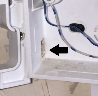

The master in the main bedroom, how certain are you that it is the actual 'master socket'? Does it have a black cable coming through the wall from outside directly into it?
Pics of the alarm and associated wiring?
Gaz :)

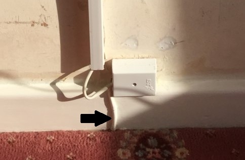

This is probably the incomer drop wire and the box is jointing the drop wire to internal for the two lines. Possibly as a retro fit.
Edit Two holes in the wall that have been filled in suggest the master socket was originally fitted here. Black marks on the wall through the holes of the master socket suggest the proces of moving the master socket was not completed.
and the incomer came in here.

Looks like the socket in the main bedroom (first picture in my original post) is indeed the "master socket" (at least it is now) - it has a black jacketed wire coming into it from the wall.
Also, if I take the front cover off that main bedroom socket (to reveal the test socket), the broadband, which is plugged into the second bedroom's smaller socket) stops working, and the alarm complains about having no phone line connection. So it seems that the second bedroom sockets and alarm's phone connection run from that front panel. However there are some other wires going on in there I can't claim to understand! I'll try provide pictures soon.

Correct.
There will be a pair of wires coming out of the black external cable joined onto a pair of the white cable which goes to the second bedroom, which is feeding that other line. So, not connected to the main master at all, just somewhere to hide the join.
So, the two white cables in the first picture, one goes to the second bedroom and the other will go directly to the alarm.

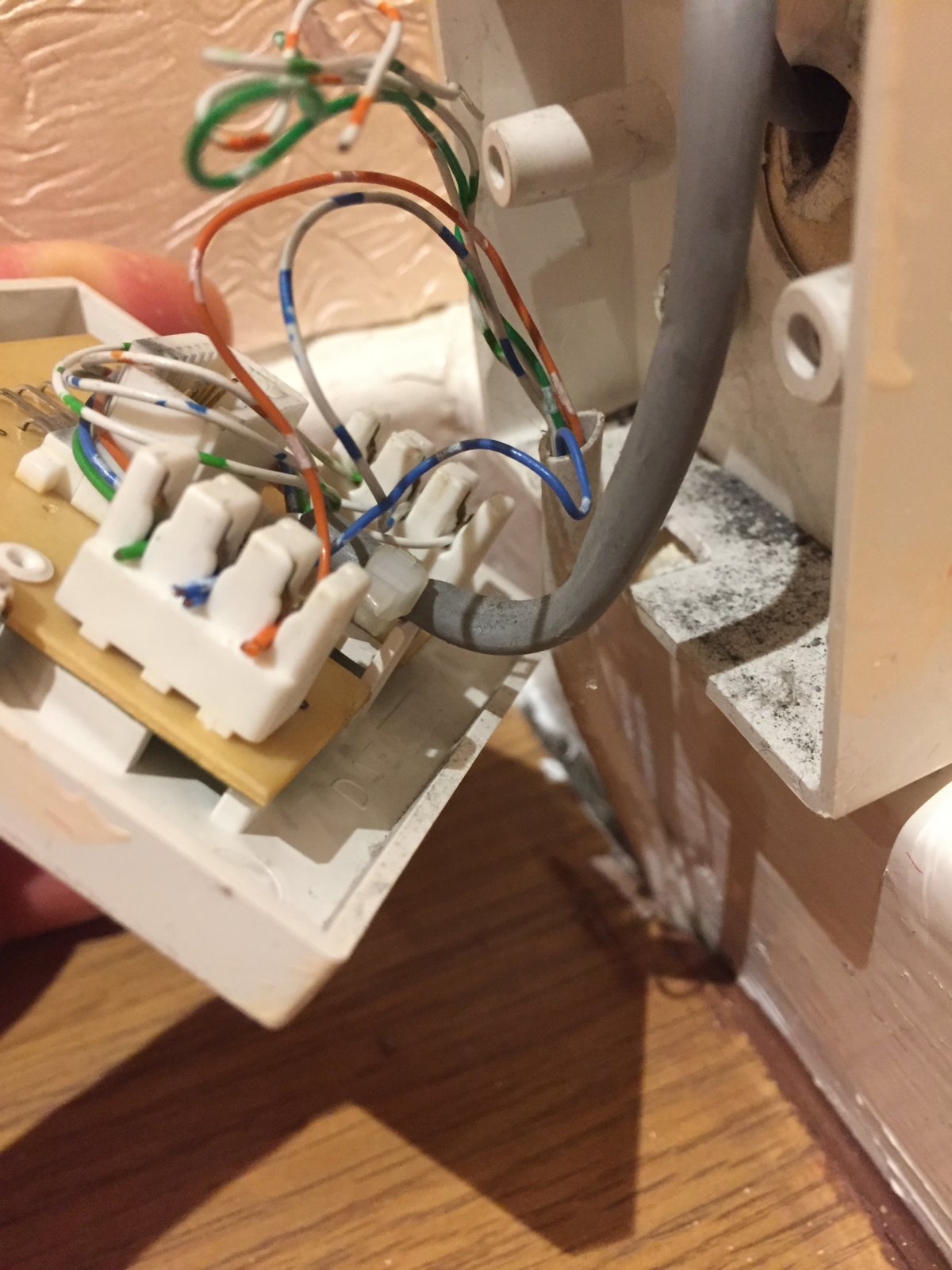

Sorry, yeah, didn't have a picture of the front door socket before, but here it is:
Just one white cable visible from outside, but behind the panel there's a grey jacketed cable too, which goes into the wall:
i do seem to remember a cable running down the outside wall to somewhere around there (I'll check tomorrow when it's light!), and I do remember seeing a grey cable behind the main bedroom master socket too. Is it possible an extension has been done to the front door socket externally, hence the difference in cable?
If so, presumably the white cable from the front door socket goes to/from the alarm. But as you say who knows! Still, interested in anyone's input on that!
On the front door socket, pull out the white/blue and blue wires that come from the white cable which have been put in second in the IDC slots. The alarm should then be disconnected and not make any calls.

Certainly seems that way. I assume it's the closest socket to the alarm panel, seeing as it's by the front door?
This extra grey cable has thrown a spanner in the works though, you have too many cables for the number of extensions you have.
Under the master, you can see that one cable is thicker than the other. The left one looks like a "2 pair" cable and the right looks to be a "3 pair". The grey cable is also a "3 pair" cable.
So, the white 3 pair is going to the other bedroom from the master.
The grey 3 pair goes to the front door socket and then another white 3 pair goes to the alarm.
So, that leaves the white 2 pair from the master, which seemingly goes nowhere! (another old socket that's been cut off in the past probably)
