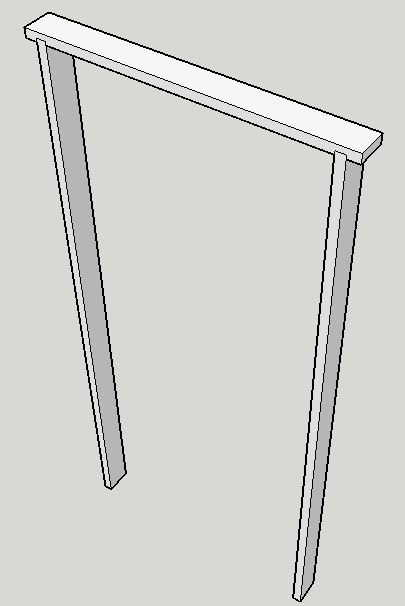

Sounds like the housed joint you often see in a door lining:
The joint is called a housing joint. For a rebated casing the joint is essentially the same.
