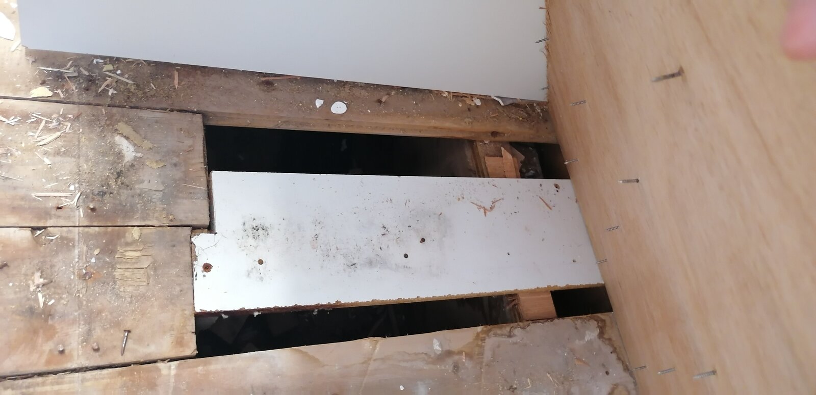

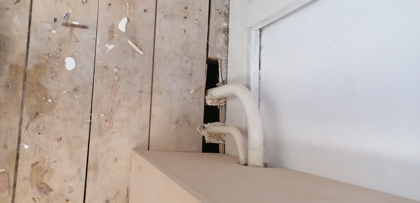

Guys can you just confim that these missing bits of floorboards should have been replaced with some new sections of pine planks with the same thickness and grade...
New flat who ever installed the new heating system butchered the old floor then juat walked away no idea what he did with the white bit aka photos just some radom bit of scrap wood he found which was rotten and falling apart it was like chipwood the cheap fake wood you get on kitchen cabinets definitely shouldn't have been uses to bare weight or am I wrong.
Why wouldn't you just screw the sections you removed back in...? Seriously asking what is the mentality here just to leave it like that?
Guess just some radom bit of wood he found lying around and thought he would just slap in instead of doing a proper job like who does that cowboys thats who...
Am I fair is saying thats bad as my washing machine goes ontop of that i understand that its mostly the joist that take the weight from the floor but aren't floorboards meant to then go ontop to spread the weight evenly?
Photos attached

Wood can bust up when removing so you need to buy new timber and at the correct thickness.
Also need to add supports for floor or take up more to reach joists, plus you won't get the tongue and grove to lock together again. Some trades include the cost of chippy to fix after they have finished while other say that's down to customer to organise.

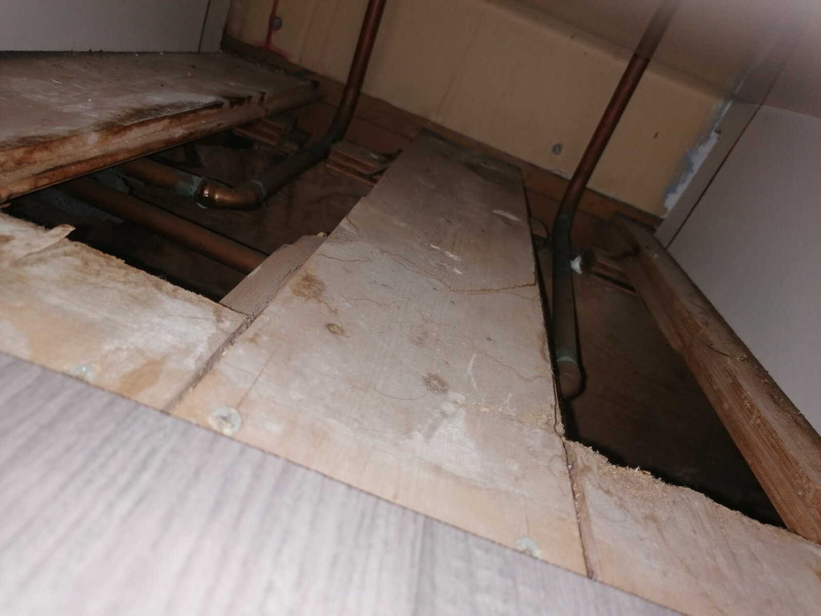

I know this was caused by the who ever installed the new pipe for the boiler they didn't replace the floorboards instead hid it away under the sink and then used some what random white plank thats like rotten and not meant to be used like that.
As you can see the joist running parallel in the bigger picture the angle for under the sink you cant see so but the joist are there

They guy who ripped them should have replaced them but the lanlord doesn't care and just covered over the issue with 6mm ply instead of using the same type aka thickness of pine floorboards and grade.

Well, my house is 1880s and has T&G flooring throughout, or did you mean timber yards? T&G is readily available, but for small repair pieces it is faster and easier to use square edge boards or plywood, and pack-up level from beneath, partly because you can struggle to find matching thickness boards off the shelf.
My own house has T&G boards which finish at 1-1/8in (circa 28.5mm) and that is not an off the shelf size in my area any more, so after we bought it, when I was going round making good all the "improvement works" done by plumbers and sparkies, I had to resort to lifting the horrible broken, often loose boards, adding extra 2 x 1in support strips to the sides of joists, then cutting and screwing 22mm plywood pieces over the holes. Fortunately I had some 22mm left over from a job, the floors were all being carpeted afterwards, and I wanted to ensure that if I ever needed to gain access I would only need to lift the carpet and unscrew the access hatch. So far that has only been necessary once, but I amkess than impressed by the tradesmen who thought it was OK to walk away from a job like this - it is such a common complaint

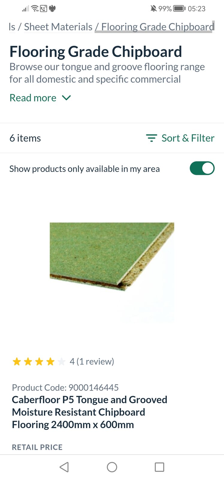

I thought you were referring to t&g chipboard flooring that seems alot of new builds are getting instead of planks again washing machine sits right ontop of that big whole and was covered over with 6mm ply but only as overboard for the vinyl sheet flooring to be neater so it has so strength to it at 6mm.

Plywood (18 or 22mm) is a far better material, but from past personal experience on piblic housing can take a bit of arm twisting to get hold of
Chipboard is not an ideal material for repair work unless the repair pieces are pretty large and thr operstive can gield a plunge saw and rail IMHO - seen too many gash repairs with chipboard, but despite saying that it can be done right - but probsbly not by a lot of the guys they employ (they often pay lowish rates - I have to admit I only worked on that sort of stuff during recessions because the alternative was not working)

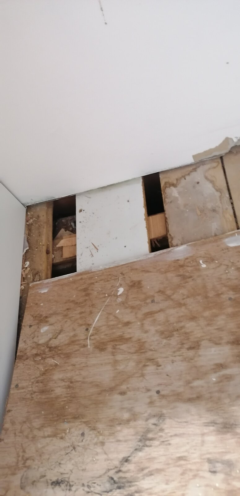

Like I said the 6mm ply put down wasn't to act as a semi replacement for the missing sections of floorboards but just as a flat overboard for the new vinyl flooring to lay ontop.
When I pointed out the whole to the lanlord they just ignored me and told the boys to carry on.
Again yes I would say no less than 22mm ply could be used ontop of joist to support the weight and I'm sure its been strength tested but I would have just replaced the planks and then overboarded as then the full joist is taking and even out the weight in that section instead of one little section.
With reference to the chipboard I know in some new builds or some other homes people now use high grade toungue and Grove chipboard as floorboards I have never came about this and have heard its a nightmare to then lift up again if you need to run new pipes and wires as its often glued and glued wrong also.

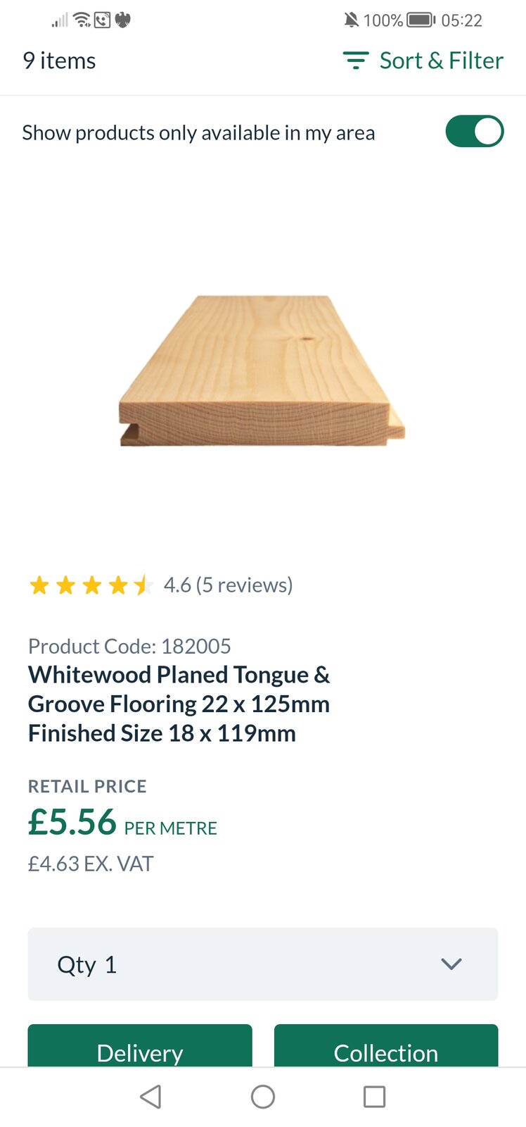

I'm aware that you can get toungue and Grove floorboard planks also but again this isn't what I have and have never seen it apart from a soild hard wood floor thats been polished sanded and stained mine are just plane planks nailed down to the joist with a few mm gabs all the way around as they aren't the finished floor that being either vinyl carpet or tile.

I would never use 6mm ply as a main support source over joist instead of floorboard / subfloor as 6mm is just to thin and can't take the weight especially in a kitchen as foot traffic is high and the most heavy items go in the there in most uk household eg cooker fridge (washing machine in the uk)
And I have 6mm apparently taking the weight of my washing machine now lovely
Its known to lift bow and buckle its merely a cosmetic ply used to level out the nip and dips over floorboards to have a flat surface for a finished floor
Mine is the last pic
