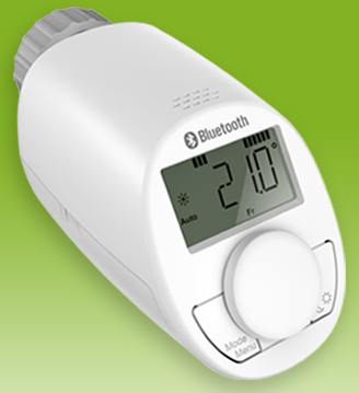

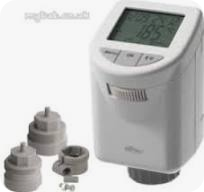

Most electronic heads come with a kit
so they can fit a range of TRV bases. The eQ-3 and Terrier i30 are stand alone, ⁣⁣ but61dmtMm13BL.jpg1742439835449.png many need a hub as well, home Wi-Fi needs a lot of power, so most battery powered items, need a hub to make the batteries last longer, in the main over a year for TRV heads, I did a quick look for cheap electronic heads, and the SONOFF does seem cheap, and has a great Compatibility Guide which shows all variations.
It will fit, lots would but just to check does it does actually turn the rad off, if so then sorted.
