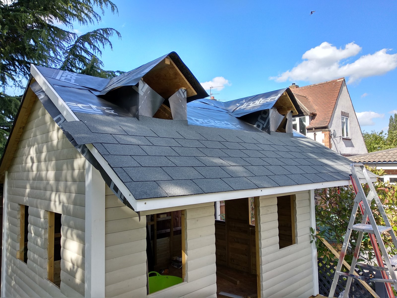

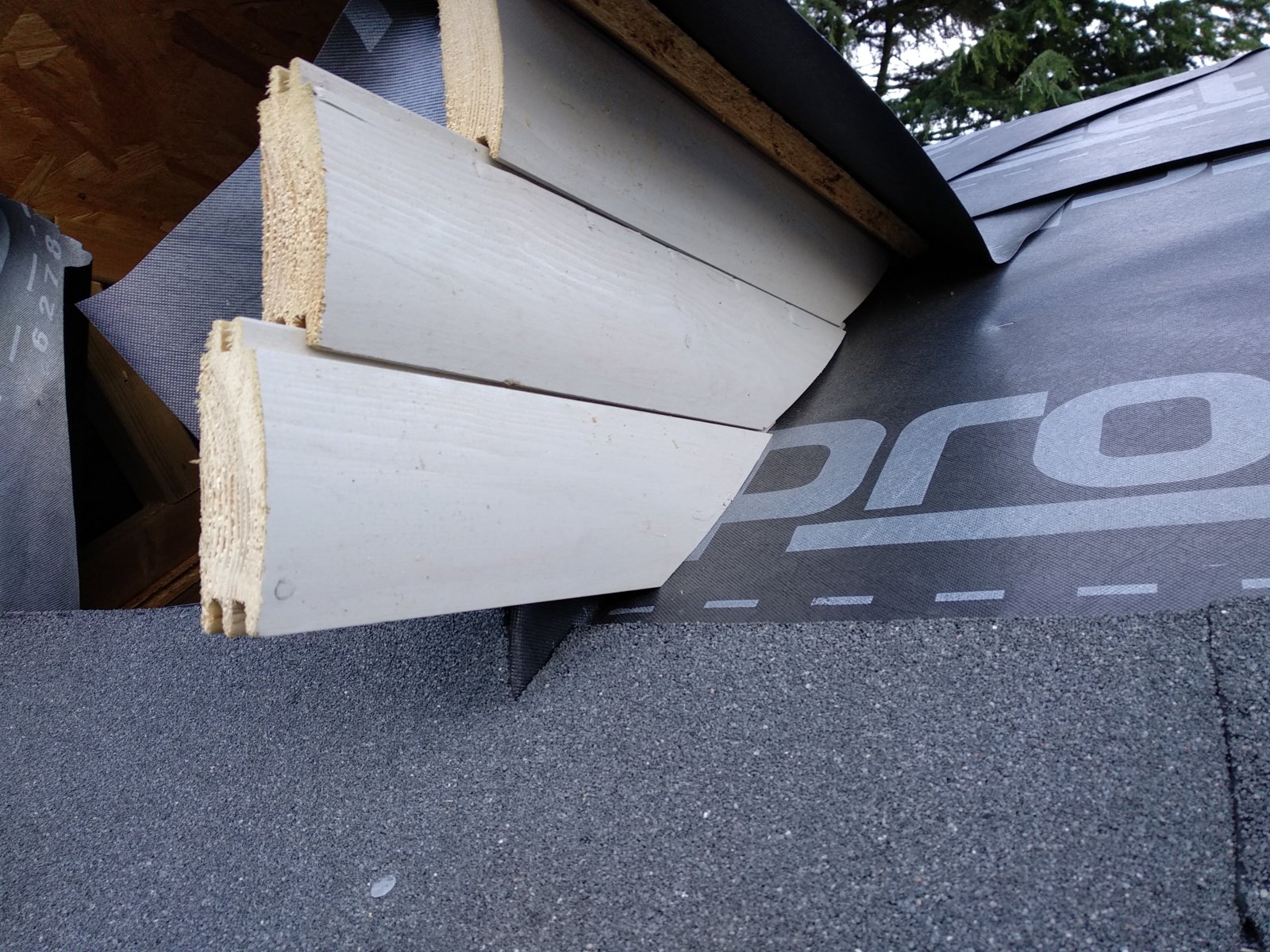

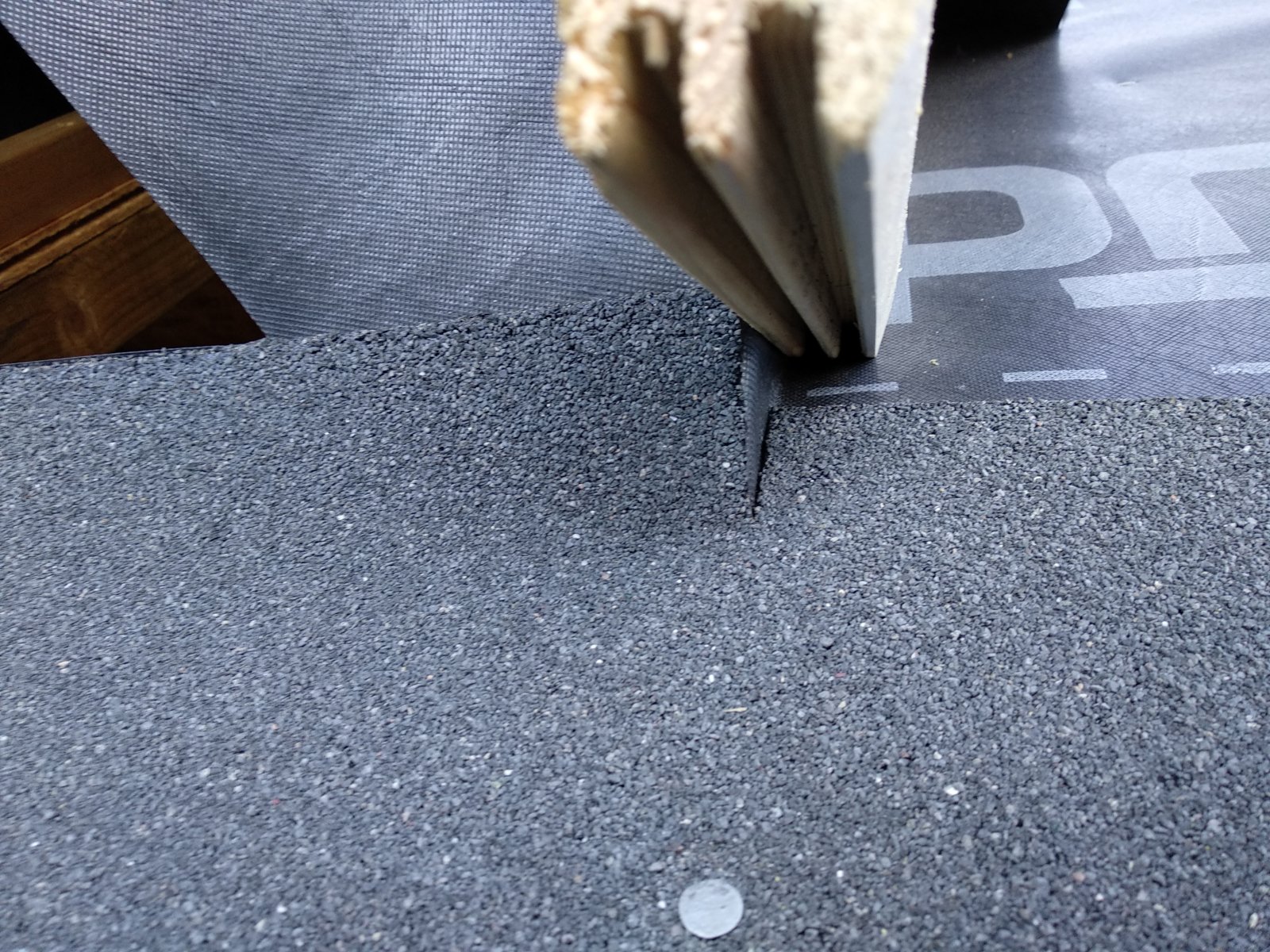

Update, so I've started the tiling today, and have gone with a 20mm overhang on all sides. If it looks daft I can always trim but the instructions on the net for theses shingles say to oversail by 50mm on the front! Which is madness.
Struggling now with the dormer windows, I've attached a photo mocking up how I aim to clad them after the tiling is done. Do I just tile upto the wall, seal the perimeter and then seal under the cladding whilst fitting it?
How do I finish the front? I've seen that the Americans use L shaped aluminium sheet and upstand it against the front, this is then wrapped round the side and up the roof.
The window isn't lined, framed or fitted so I've got some leeway.
Thanks.

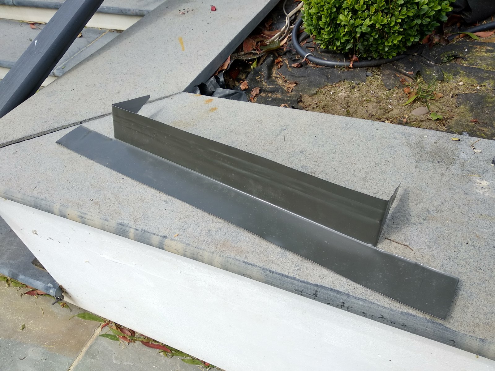

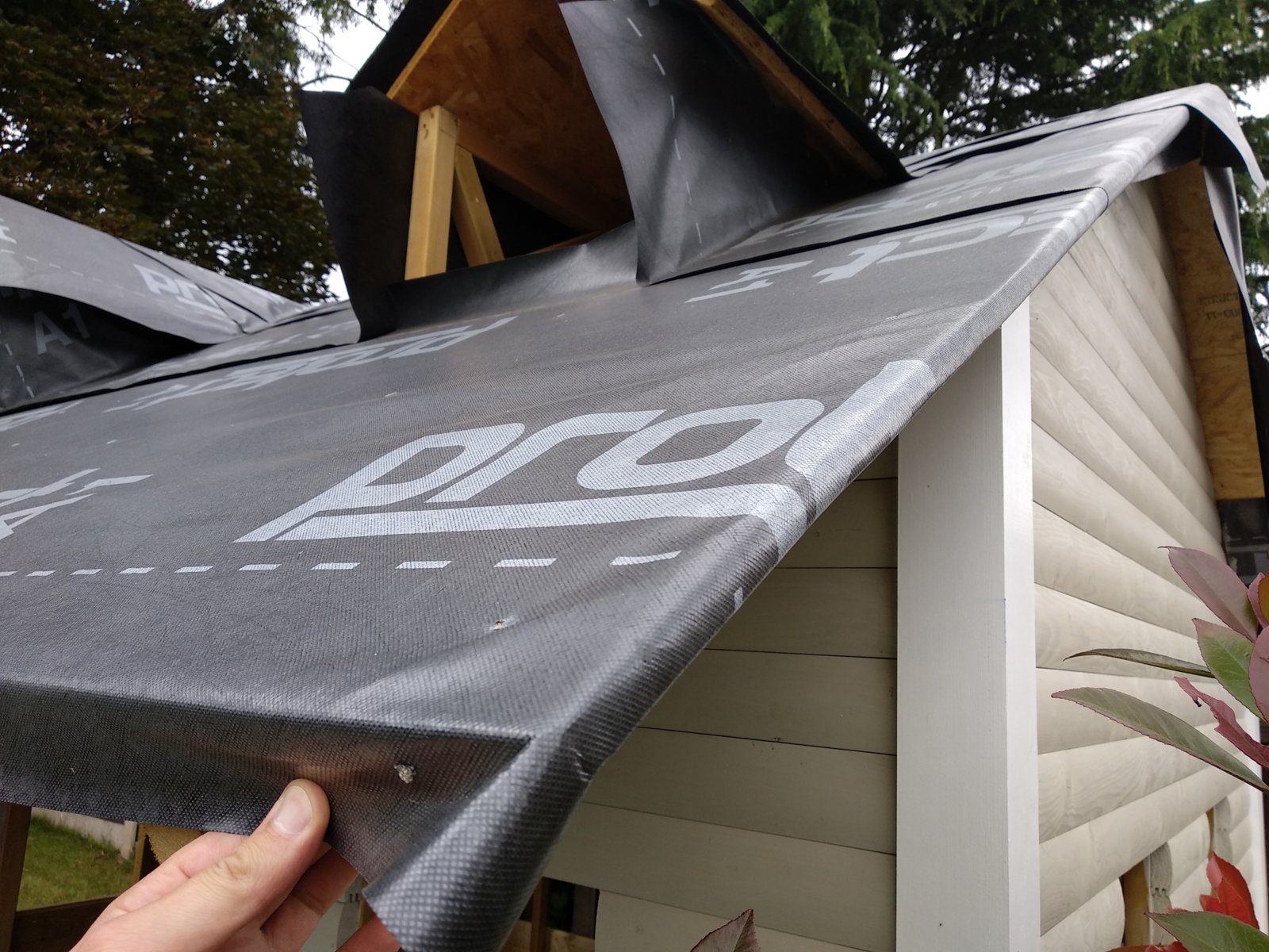

Thanks for the reply, after looking at the instructions and following your advice I've been and purchased some lead to do the flashings. Did think of flashband but seeing as I've already spend a fair chunk of money £30 on a roll didn't seem too bad.
Going to make the upstand as you say and form around the corners of the dormer. Then make some lead soakers for the angled section. Have no idea what I'm doing but wish me luck!
Watched some YouTube videos which might help or hinder, but we'll see.

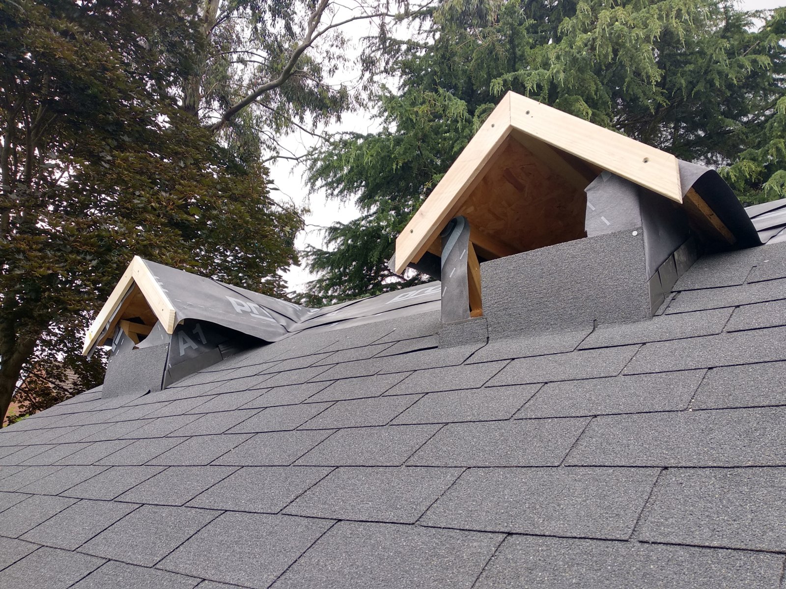

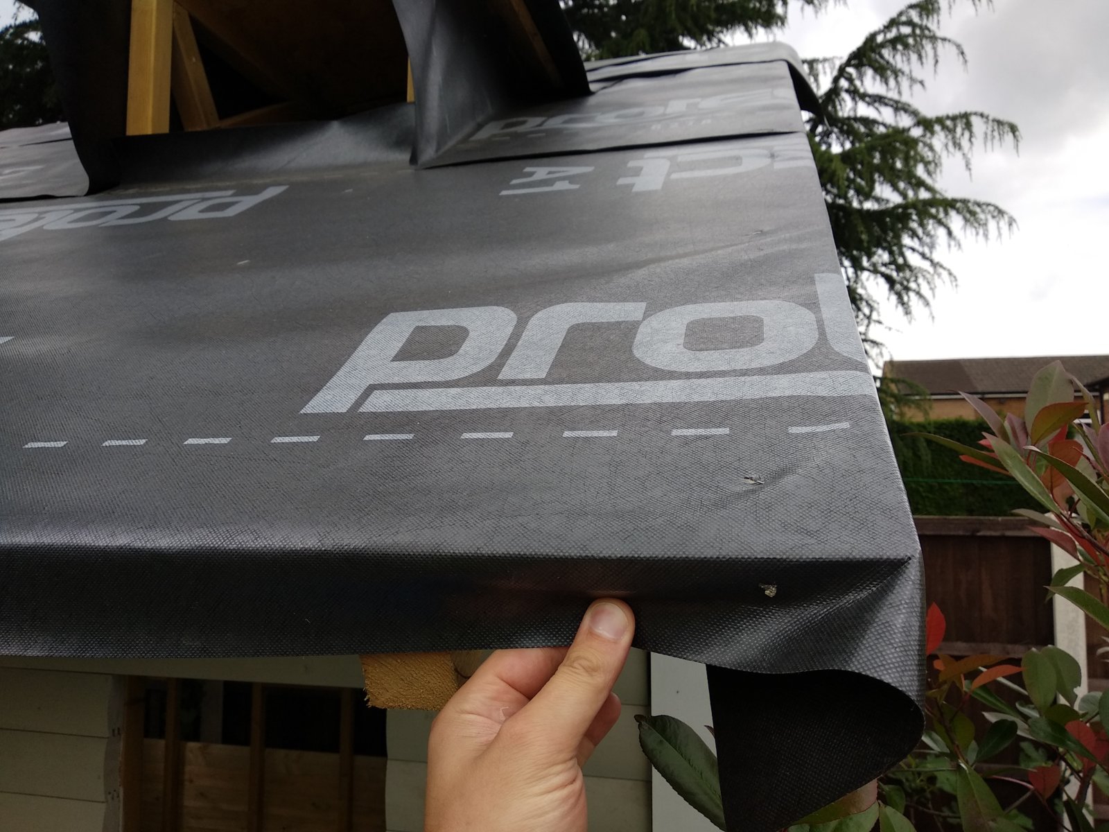

Continued tiling the roof and have made flashings out of some spare velux roofing trim that I had sat in the garage, I made soakers from this aswell which saved me using the lead.
Got upto the valley section but am unsure how to continue as I've seen three ways of doing it. Overlapping, open valley and closed valley. Anyone got any tips? Should I put a lead valley in? How do I cut the membrane so that it doesn't cause issues?
