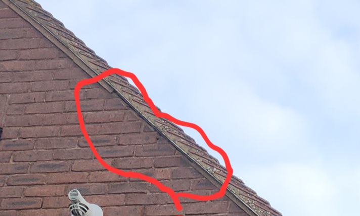

What's this bit of my roof called?
14 Jun 2005
349
3
Worcestershire
Hi,
Wondered if anyone can tell me what this bit of the roof is called? I've circled a bit that's missing and wondered if it's important.
Am I right in thinking it's not the wet verge, as that's the mortar above?
Thanks for any help.
Thanks for the response. Looks more like a strip that gets stuck to the side rather than something that goes underneath, or do you stick underlay on the side?
Thats the verge. The missing bit is undercloak.
Edit: the undercloak is there. Its just a bit of pointing that is missing.
Excuse my ignorance, but is that something that needs to be fixed to stop rain penetration or is it just a cosmetic issue?
Its a fascia (wood/plastic/cement board?) thats come away, replacing it and adding sealant should reduce/prevent water penetration.
Blup
The roofer has pointed the joint between the undercloak and brickwork. A small section of that pointing has come away. You could get up there and redo it but it unlikely to cause any problems if you left it as is.
That's perfect, thanks.
It's good if it is more of a cosmetic thing then a defect as I don't much fancy getting up a ladder and doing that, plus I assume a decent roofer would be too busy for such a small job.
Still, at least now I know what I should be asking for.
I would be tempted to hire a tower scaffold because moisture has a habit of getting in over time. You could also inspect more closely the general condition of that part of the roof.
Blup
It's purely cosmetic pointing, applied to hide the rough cutting of the bricks.
There is no significant water penetration issue of that joint in that location of a cavity wall.
