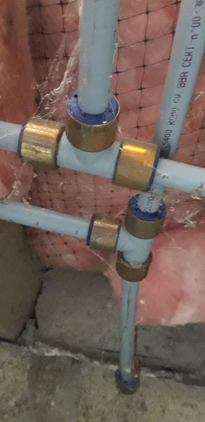

Hi everyone
Whats this old push fit fitting and how do I dismantle it?
I want to replace the tee with an elbow as one leg of each is now not required.

OH dear you have Osma gold fittings, they need a special de-mounting tool, they are expensive and absolutely crap fittings, you will constantly chase leaks, cut the lot out and replace with something more reliable
If I chop close to the tee and replace with hep2o elbows would that be ok?
Yes, but reuse the inserts from the pipes you are removing. Best to use the correct ones for the pipe.

It isn't hep2o pipe though is it, outside diameters tend to be the same but not the inside. You can use whatever fittings and inserts you like but you did ask for advice.

If the internal diameter is different between different makes of pipe, using the wrong insert could lead to a loose fitting and potential failure later.

I have always found that Hep2O with metal inserts are fine , but do not keep those Osma Gold fittings, you will chase leaks all over your house they are absolutely dire
Do they not release by simply pressing that plastic collar in, evenly all the way around and easing the fitting a little more onto the pipe?

nope the collar has small indendts in it and you use a tool that grips the collar and you unscrew it, they are horrible fittings
They use a “M” ring rather than an “O” ring, once they have been depressurised / demounted then struggle to seal again.
You can buy a Demounting tool, bit like a circlip spanner, but better cutting it out and using either Hep2o or compression fittings is the way to go.
