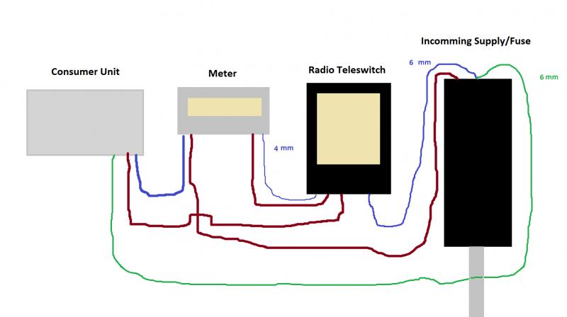

Whats this setup? 4mm from meter!?
28 Jul 2012
1,357
56
Surrey
Hi all, while visiting my grandma in the midlands, I noticed something a bit unusual - at least by todays standards!
Aside from having a radio teleswitch between the meter and the consumer unit, which i have never seen in person before than at her house; the wiring arrangements and the cable sizes used seem a bit unsafe!
4mm between the radio teleswitch and the meter, whats going on !?
As for earthing arrangements, T-N-CS from what i can figure. (shurley not T-N-C)
Below is a picture of how it is wired up from what i can work out, along with some other pictures including the radio teleswitch.
(Cable sizes that are not quoted in diagram are at least 10mm, what seems ok for the era when this was installed.)
(Notice how PE and possible neutral conductor share same exposed terminal block as shown in my diagram.)
Regards: Elliott
It is a switched neutral which when the teleswitch says it's time, sends a signal to the meter and tells it to change from "normal" rate to "off peak" rate.
So out of the main incoming supply/fuse holder, how come there is only 1 thick cable. Does it carry both line and neutral conductors inside this thick cable coming out?
Yes it's a concentric tail. The live is in the centre, with the neutral surrounding it. It's a tamper proof connector to prevent the abstraction of electricity before the meter.
Not seen that thing under the meter before, presume its some sort of meter fiddling prevention
Sort-of, I'd imagine. Is it not within that 'thing' that the concentric cable splits for connection to what looks like a standard meter (which could not accommodate concentric cable directly)?
Kind Regards, John
It's a concentric anti-tamper cable, designed to prevent electric theft. Fully moulded with a set size at the meter end to fit most meter centres, and the other end has a fixed moulded live and a longer neutral which is formed and cut (too many variations in cutout sizes).
Not seen these days, but used extensively in the 80s and 90s. Quicker and neater than tails too!
