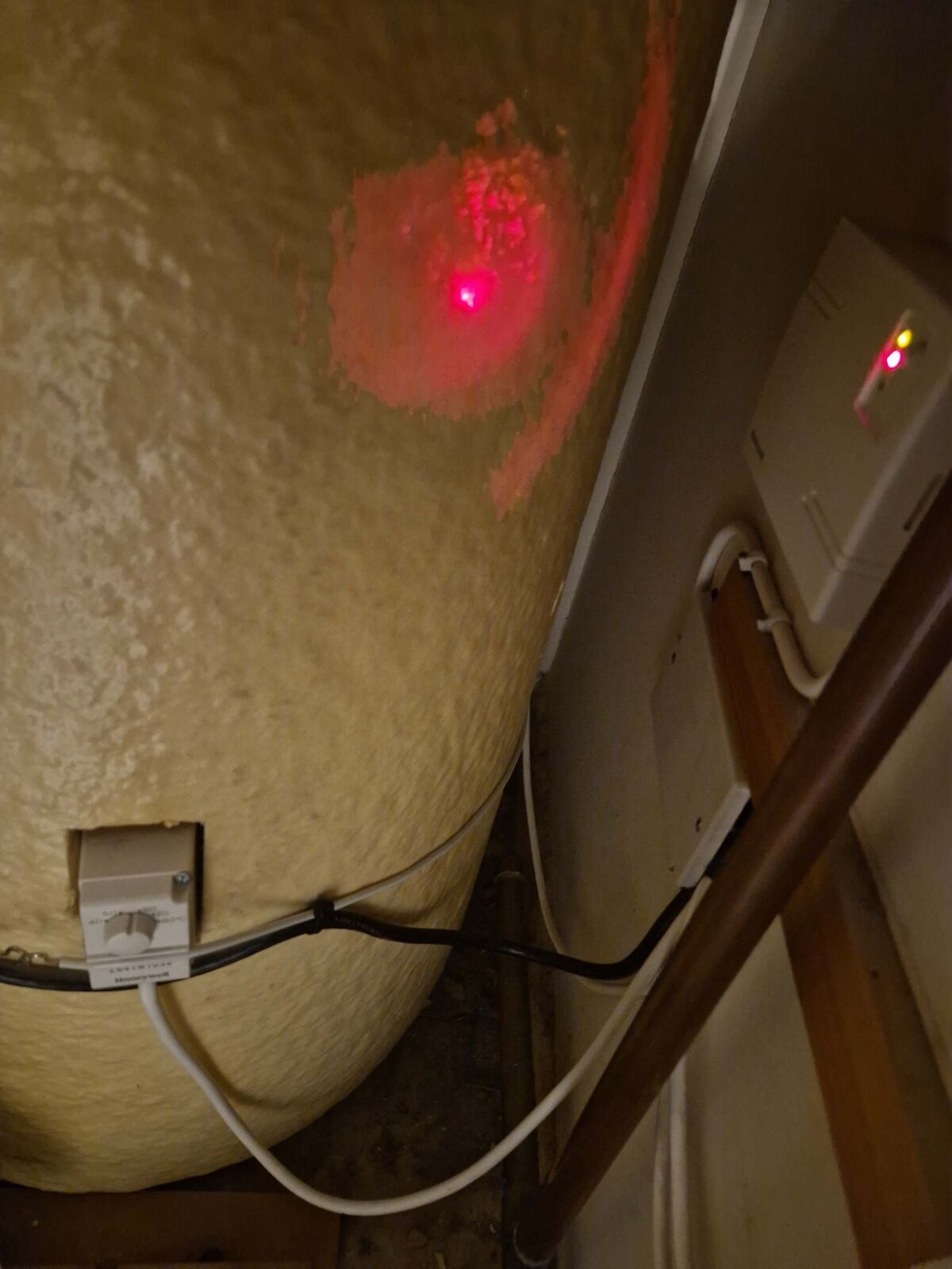

Recently moved into a new place. I have a baxi solo boiler, hot water tank in airing cupboard and tanks in the loft.
Heating and hot water is controlled by a honeywell 9400c.
There is a honeywell Hcw80 room temperature controller and then a HC60NG receiver in the airing cupboard.
Basically the controller and receiver have seen better days.
So I plan on putting in a new smart thermostat and receiver, nest, hive etc.
My question is looking at these pictures would it be a straight swap?

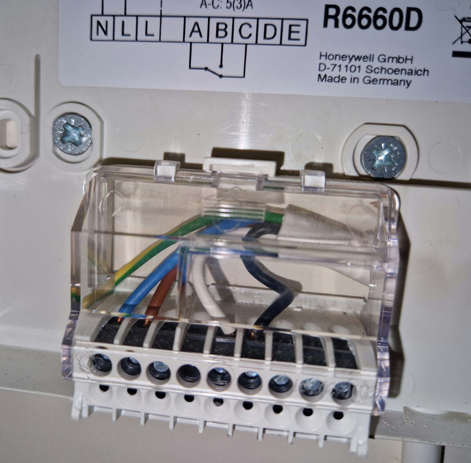

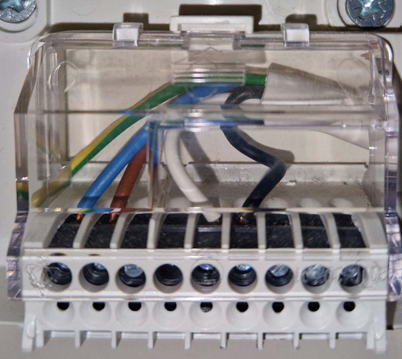

In the first picture brown and blue, live and neutral. But what are A and B?
Reciever wiring
Picture show wiring to the receiver
Just to add I'm not worried about controlling the hot water. Just the heating from smart phone etc. Want to leave the house. 9400c programmer in place.
If you want the new smart thermostat to control the hot water and the central heating, it would replace the Honeywell 9400c as both the heating and hot water control wires are present here. With some smart thermostats eg. Hive Dual Channel, the wiring connections are exactly the same and would be a straight swap. Other types will use the same wires, but they will need re-positioning. eg. Nest 3rd Gen.
The Honeywell R6660D room thermostat receiver in your photo becomes redundant and is removed. The white and black wires in terminals A and B would need to be connected together to complete the broken circuit caused by its removal.
Alternatively, as you mention, if you are happy to leave the hot water control as it is and not controlled via an app, you could have a simple smart thermostat (eg Nest-e) that does use the wires currently going to the R6660D. In this case, the heating time control at the Honeywell 9400c would be set to be permanently 'on' 24/7 to allow the new thermostat to take full control, but the 9400c hot water channel would still be controlling the hot water.
The wires in A & B are the switching wires that actually control the heating. The other wires in N & L are just to provide the 230V mains for its operating power.

The Honeywell R6660D room thermostat receiver on the other hand, as you correctly state does have volt free contacts. However in this instance it's connected to the ST9400 which can only supply 230V, so it will be switching the 230V from that anyway.
Would you like to reconsider that statement based on the below? They look the same to me ;)
I went by the diagram posted, and the wires fitted, the white and black wires seem to be to contacts, no link wire, so from what is shown can't be sure 230 volt control, likely it is, but can't be sure.
I think you have missed my point. That's the R6660D. But I was talking about the ST9400 being identical to the Hive which it is. Both are 230V only neither have a voltage free option.
Thankyou for your reply everyone how would I go about testing which wire is which with regards to the black and white wire?
You don't really need to. When the heating is 'on' the wires in A and B are electrically joined together, when it's 'off' they aren't. It's just a simple switch, on or off.

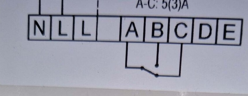

Looking at the backplate, is it not self explanatory that A B and C is a switch element?
I am surprised at the post.
Look at the markings on the backplate, A, B and C are clearly a switch. The contacts you need are the common and normally open, A and B.
