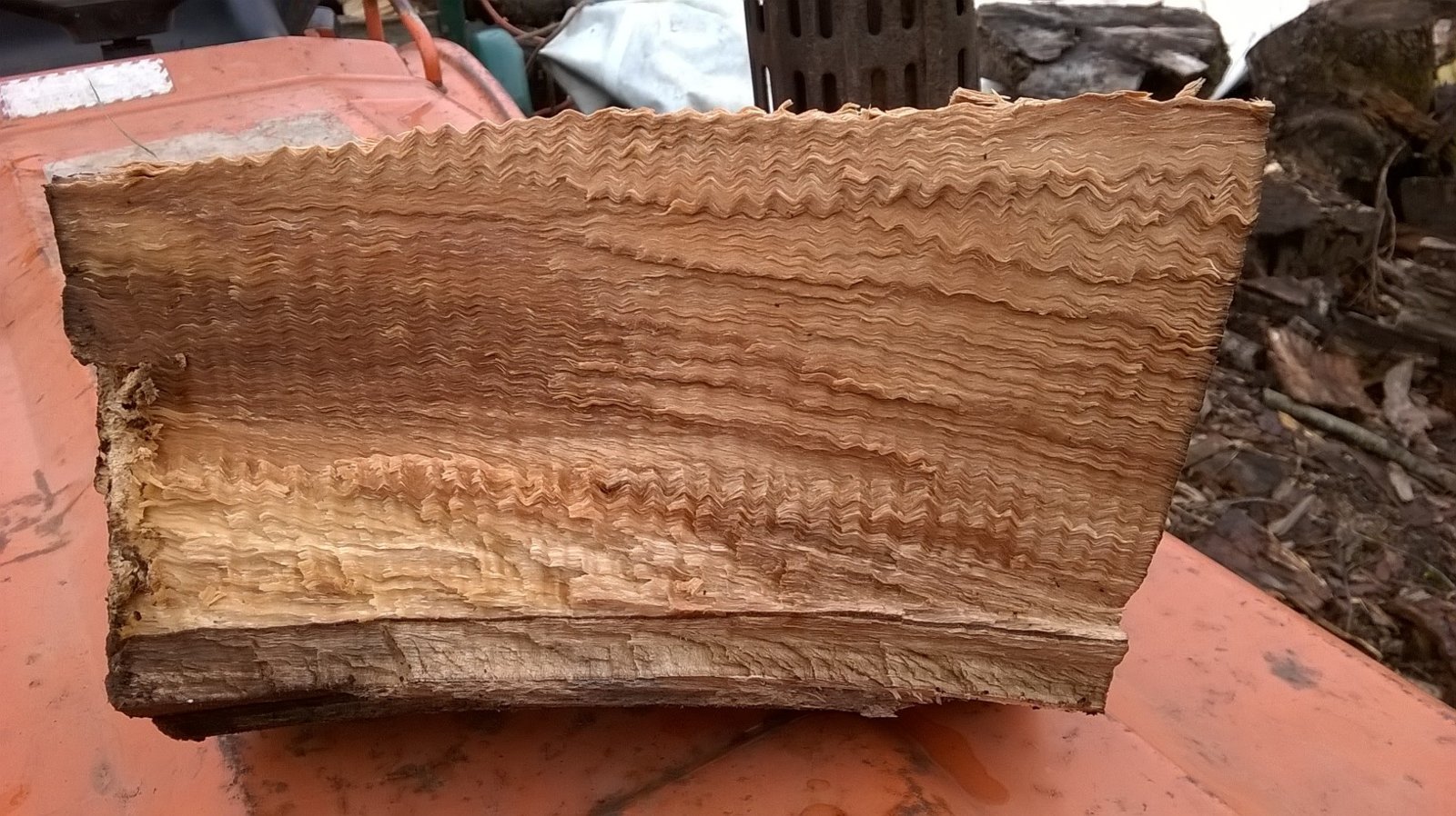

It took a 10 ton hydraulic splitter to crack this Euc which was fresh felled , who knows what would have been required if it had dried out?
