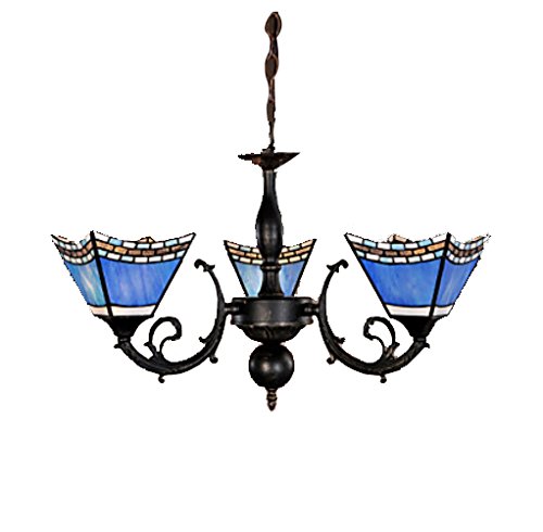

OK so I'm hoping to fit new ceiling pendant lights in several of my rooms and I order some lovely fittings from Amazon UK and one or two other UK-based online electrical suppliers.
Sparky comes around and hanges them but refuses to connect them because the chandeliers are metal and their wiring is not (according to him) double insulated. The wire coming out the lights is a sheathed twin cable (ie on the outside appearance there is one cable which is dual core as it sheaths around an internal blue and brown cable). I expect you know what I mean.
There is no kitemark on any of the light fittings to say it's dual insulated. I spoke to one of the lighting companies who contacted the factory in China who told them to tell me that of course the light is dual insulated as it has a sheathing cable around the live and neutral. Sparky says that's not good enough.
So either I have to send them back for a refund (unlikely as they have been opened and hung in place, just not connected) or Sparky is offering to rewire the lights with an earth cable, but he tells me that he has to charge me several hundred pounds as it's really fiddly difficult work.
What should I do? I'm reluctant to send them back, not least because I rather like them and there is evidently no guarentee that I won't be in a similar position in a month's time if I order other similar looking lights, I gues they all come out the same factory.
Incidentally as far as I know the wiring on the lighting circuit is earthed.

Several different light fittings but all fairly similar, like this one:
http://ecx.images-amazon.com/images/I/41d3R67+cZL.jpg
ie metal frame, three or five arms with bulbs on the end.
The cable going out from fitting which needs to be connected to the existing wires in the ceiling looks like this:
http://3.bp.blogspot.com/-AN1dydsmsWE/UGwTdRoahaI/AAAAAAAAAEE/JlP9dHN2RkM/s1600/2+Core+Cable.jpg
Sparky says each light fitting needs an earth cable too so proposes to strip out the cable for each light, and fit a three core cable, drilling a hole somewhere in the metal frame to connect it to. And charge me a bucket in the process.
All 230 volts, standard SES or ES light bulbs.

What it should have is a CE mark, and if it's double insulated it will have this symbol on it somewhere:
Double_insulation_symbol.svg
If it doesn't then it is not double insulated, no matter what the maker or the seller say. But even if it does have the symbol, it might be fake - the light may still not be DI.

Purely from experience, that looks like a class ONE lighting fitting, where an earth MUST be connected, if wired in the UK.

It isn't good enough, since that only means the flex / cable is DI.
Other considerations are where connections are made between the various wires (typically in the central section of the light) - for DI, these must be totally enclosed in an insulated container.
All of the wiring internally must be DI, including where it passes through each metal arm or stem.
The lampholders must be plastic, and a plastic insulating sleeve is typically used at the point where the plastic lampholder is screwed into the metal arm of the fitting.
I would have expected lights of the style shown to be class I with earth connection. The cost of properly manufacturing such a thing to be Class II would be significantly more than Class I, and would serve no useful purpose.
It should be easy enough to unscrew the lower centre section of one of the lights and see how the wires are connected inside.
