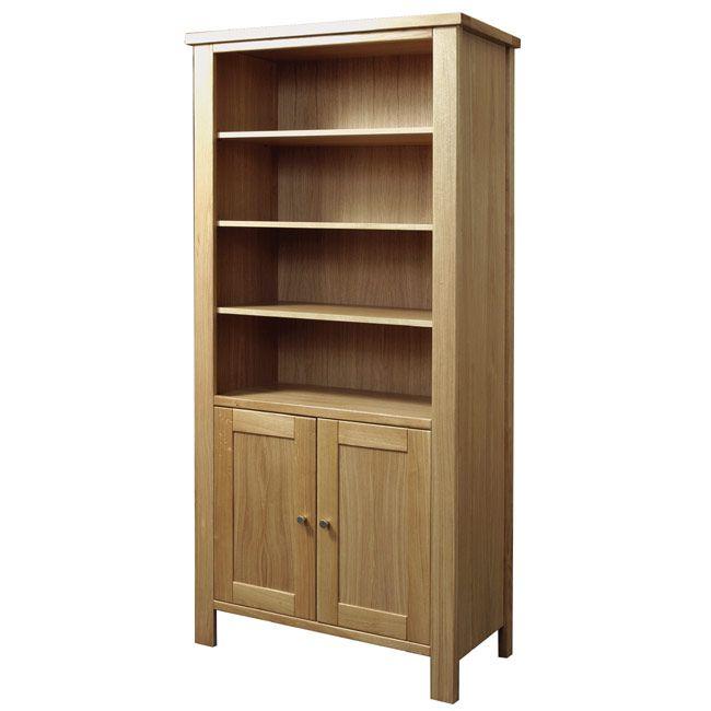

I'm building a cabinet and I'm stuck on what hinges to use for the doors.
Rather than the hinges going from 90 -> 180 degrees, they need to go from 180 -> 270 degrees.
The cabinet has a 70mm strip running down either side, to which I need to mount the hinges. Like this:
I know I could use conventional hinges mounted in various ways, but I'd really like to do it the neatest way possible.
asssuming you are trying to fold the doors round the side
no hinges will work that i know off
the kitchen type are designed to work with 18mm wall thicknes so wont span around 70mm
if you are trying to mount the hinges on the inside edge of the 3" side
then you need to be aware that the hinges wont work on much more than around 38mm thickness [frame and door]
