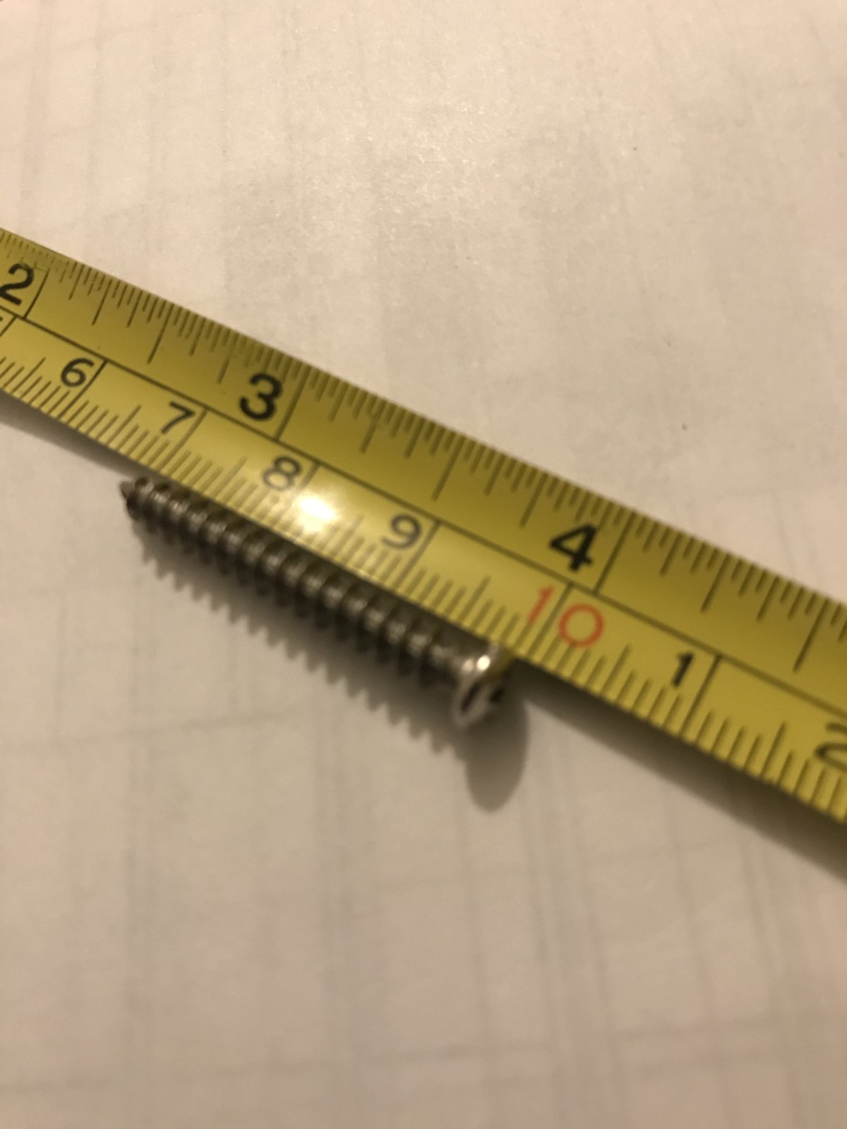

Sorry not sure where the best place to post this was.

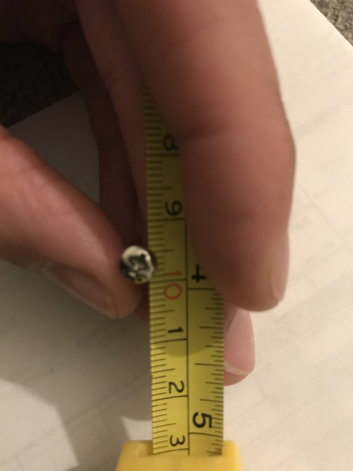

So I bought some curtain tie back "hooks" and the screw that came with them appeared to be made of cheese as I ended up stripping the heads of several. Therefore I need to find a replacement. I would say they are broadly pan head self tappers of 4 x 30. However the screws included have a head whose diameter is much smaller ( around 6mm dia) than those I seem to find readily available on the market. So wondered if anyone had stumbled across any?
Images attached.
it looks more like a chipboard screw to me, probably intended for plastic wallplugs.
It might be your photo, but I can't see the Pozi X on the screwhead, perhaps they are Phillips intended for the US market. Might be why they didn't fit your driver.
Are you going to screw them into plasplugs? or wood?
can you show us the hole in the hook?
I just had a look but can't see a match.
32mm long is probably 1¼"
Is it a number 6?
JohnD,
I can confirm there is no posi x. I was using a Phillips head though.
For screwing into plasplugs and unfortunately I don't have a picture of the bracket at the moment but it's just a clean clearance hole without any significant countersinking. Just very very close to the edge of the bracket hence why they were provided with the screws they were I guess.
The major diameter of the screw looks more like 4mm so a gauge of 8 would be my guess. But my eyes could be on the wonk so could be 3.5mm so size 6 could be valid also and most likely workable.
