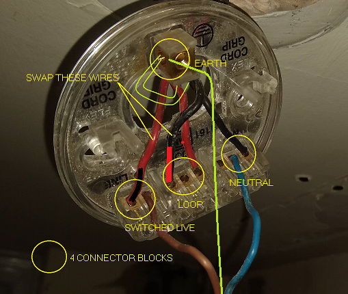

Removed wiring for ceiling rose to fit downlight..
I put all the live wire in one terminal strip, then did the same for the earth and neutral.. I extended the cable using 1mm two core and earth straight to my downlight
I turned on the electrics and it tripped...
Is it my dodgy wiring? Please be gentle guys :mrgreen:
The previous installer simply wrapped/twisted the earth from the two cabled in ceiling rose together. Should I separate these?

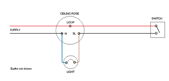

Pic 3 is not connected the same as Pic 1, when it worked, is it?
However, in Pic 1 it would be more conventional to have the two reds in LOOP and the blacks in N and Live.
Although now you have altered it, you won't know which is which.
https://www.diynot.com/wiki/Electrics:Lighting-Rose
You really should get some understanding before doing these things.
I'm not an electrician but excluding the Earth, you need at least three connections in a ceiling rose. Live, switched live and neutral. You only have two in the last picture (excluding earth) so the switched live is going to either neutral or earth.
Here what I plan to do.
Please correct me if I am wrong, but this is the end of the lighting run as there are only two 1mm cables being fed into the light?
I also noted the loop, live and neutral wires..
One black cable was in the loop, so this is a switch live? Being a switch live, I will add this to the other live wire? Then feed this into the live terminal in the downlight.
The neutral wire will go into the neutral terminal
Would this sort my cock up? :D:D

Here's what to do.
The two reds. They go in a separate junction block. NOTHING ELSE CONNECTS TO THIS!!
Then you have two blacks.
One will be neutral and one will be switched live, you need your test device to find out which is which.
The switched live needs marking with a bit of red or brown sleeving or tape. That connects to the neutral
<edit>. This should read
The switched live needs marking with a bit of red or brown sleeving or tape. That connects to the live on the lights.
The other black is the neutral, that connects to the neutral on the lights.
And earth to earth.
Now, about the junctions. You cannot just leave them hanging there. If they are not going to be accessible, the junction must be MAINTENANCE FREE.
No, that is the Neutral.
The red in Live is the switched live because the switch cable is connected the wrong way round.
Being a switch live, I will add this to the other live wire? Then feed this into the live terminal in the downlight.The neutral wire will go into the neutral terminal
No, you still don't understand.
Have you looked a the link in my first reply.
No - that IS your cock-up.

@EFLImpudence from the link you sent https://www.diynot.com/wiki/Electrics:Lighting-Rose
why are the switch cables both red? Shouldn't one be black?
They have used a cable with two reds.
The colours actually mean nothing.
I don't like the twin red cables as obviously you can't tell which is which by just looking, although with a one-way switch it doesn't actually matter.
