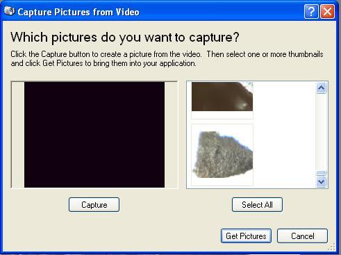

When using any paint package to work with Microscope images going to import and selecting microscope opens the following screen.
All well and good until I realised I can click on an image I have captured and deleted a week ago and it's still there.
Tried a search for resent pictures but failed to find them.
I have a partitioned drive and there is limited room in E drive used for Windows XP and I don't want to fill it full of pictures.
Looked in temp draws still no sign.
Any idea where it may be storing these files and how do I empty them once the microscope use is complete.
Using a Video player like Media Player Classic I can assess Microscope real time but not with paint packages.

I have emptied the trash. I have run disk clean-up. I have used control alt delete to check what is running so I can find folder only shows paint program as running and all the pictures are available to both Paint Shop Pro and Adobe Paint shop.
The window has Move, Size and Close plus Capture, Select All, Get Pictures, Cancel. Once I click Capture it puts live picture into right hand window and once done nothing seems to remove it.
The driver comes under USB Video Device in System Properties but it also will run through video programs so not the driver as such which is storing information.
It came with Photomizer SE from Engelmann Media takes up 1.44M so photos can’t be in that.
Each time I start the transfer program it takes longer to start where it seems it is reading the images already captured so unless I find out how to delete it is going to get worse and worse.

I now think the images are stored in the microscope adaptor not on my computer. I will try loading on another PC and see if same photos are there!
No wrong but using the Scanner and Camera Wizard I have been able to find Name: Picture 231 etc and they are JPG Images so trying again.
Well still not sure where stored but the draw was labelled "USB Video Device" and is accessed from "My Computer" and is displayed together with scanner and webcam.
So job done all unwanted pictures deleted. I hope this helps someone else!
