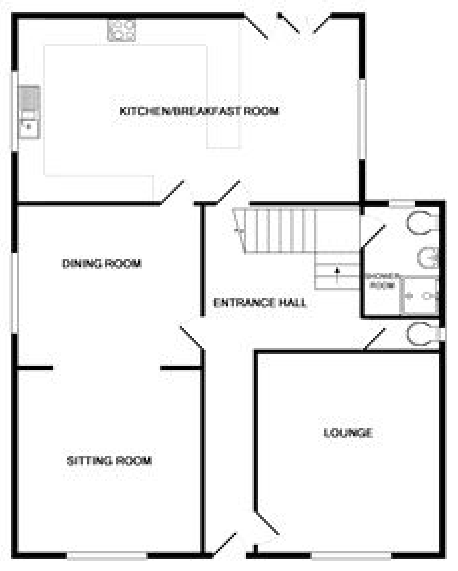

In the process of renovating our house. We found a number of rotten joists in all downstairs rooms, including the hallway.
As well as replacing the joists, that run front to back, we need to install some air bricks (it currently has none) but there's already an extension across the rear of the house which has a solid floor so can't easily duct vents through there to provide full front to back ventilation.
All internal walls are solid so cross ventilation is also a problem if we go for side to side ventilation. Unless we fit air bricks to the internal walls too?
What's the best way to proceed?
have you found the water leak yet?
how old is the house, and who blocked the airbricks?
The property was built around 1880. It has no existing air bricks. There's no obvious signs of any leak, the soil its self is bone dry, at the minute, so we believe it's been caused by a mix of the soil moisture content increasing in winter (where the joists are resting on the soil!) and the lack of ventilation over the last 140+ years more than anything else.

Lifted one of the problematic floors this morning. Started to look into where I could install some airbricks to realise the joists were actually sitting at ground level, so there's no room beneath the joists outside to install any airbricks!
What are my options? Lower the outside ground level? Raise the inside floor level? Any other ideas?
I'm beginning to see why a builder I spoke with said to pour a solid floor instead...
either periscope vents, or reduce the level outside.
It is very common for paving and flowerbeds to be raised against a house wall, leading to damp.
In some cases you can use a redundant chimney as an exit point for air to rise up from under the floor.
Poured floors and Wet ufh (y)
Builder's coming around this week to discuss exactly that. We were already digging out the sub floor to allow for better ventilation so we now have the required depth to do it.
