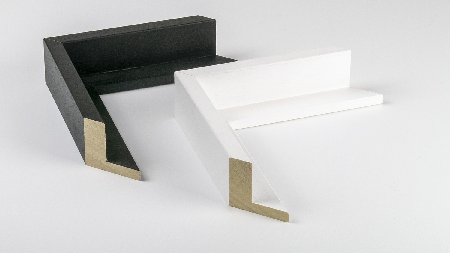

I'm just wanting to create my own handmade (simple) frame for a painting.
I can find places online costing a fortune (£55 a metre FF) but I just want to buy some angled wood and do it myself.
Does this type of wood have a special name (to help my search abilities)
Or anywhere in London (south/central) that sells it/similar

Buy some pine or ramin beadings from Wickes and glue and mitre to the size required
Blup
Ramin and beading arent L shaped so it won't work with what I need to do. Thanks for the suggestion though
Check out
£7.50m ex vat (and bar postage)- it was the first site that I came across- others might be better quality.

This is perfect thanks.

They do a cutting services have which is great so I'll use that to save my hassle
