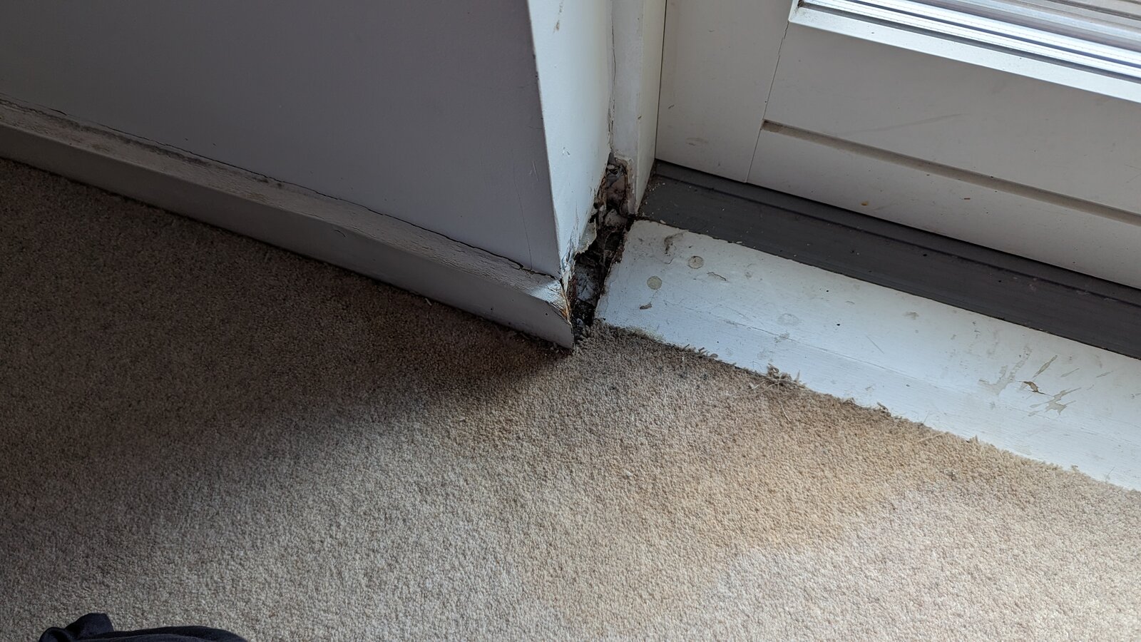

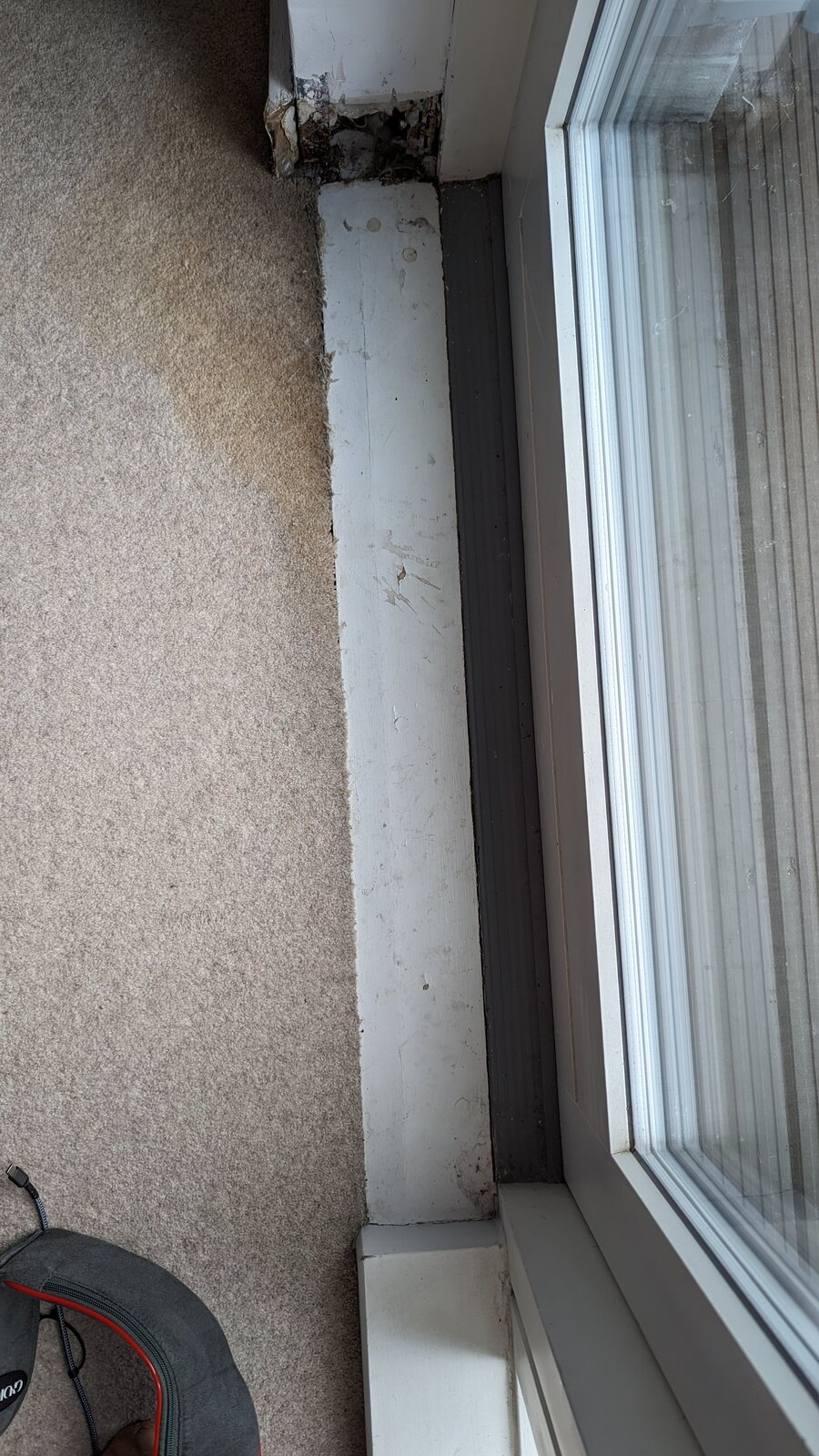

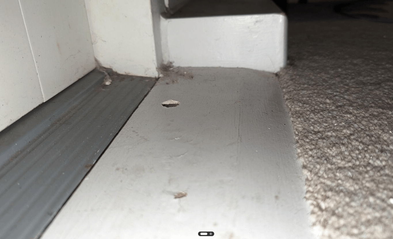

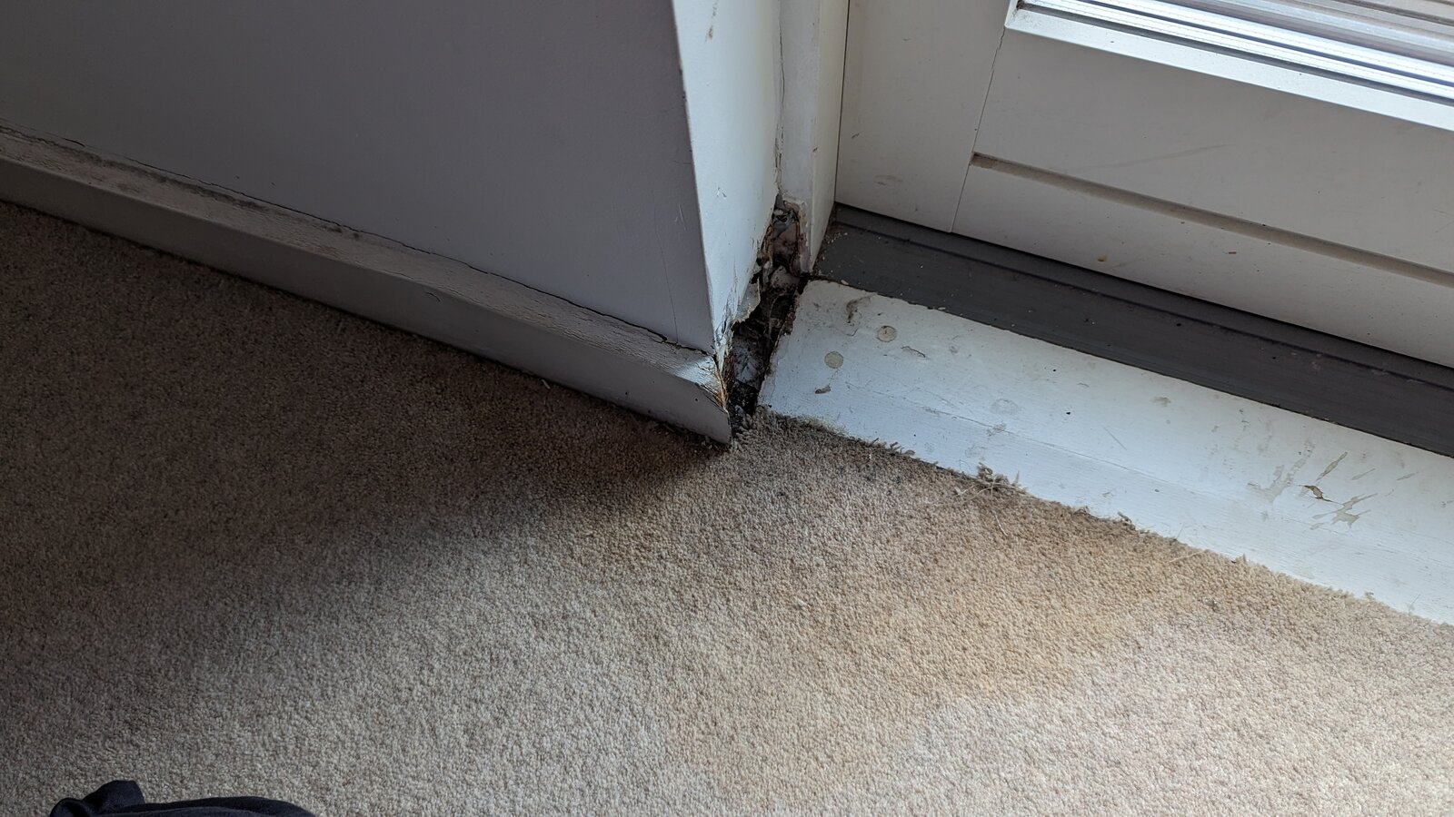

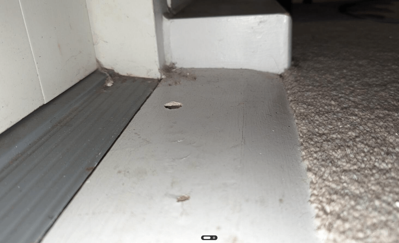

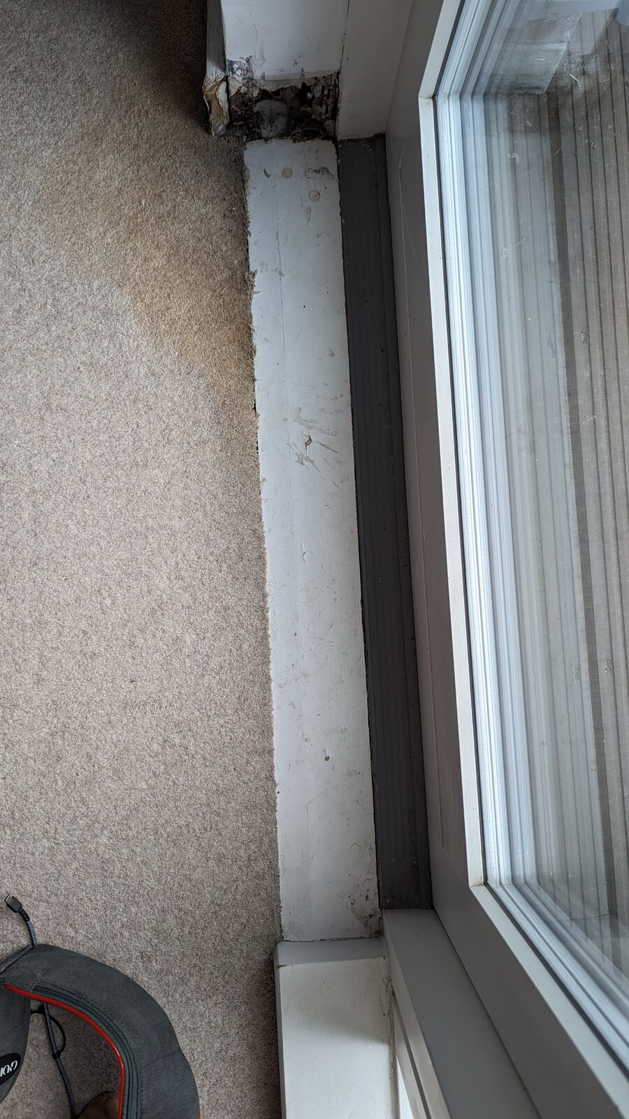

Due to some water ingress, we need to replace the wooden Threshold by a balcony door.
Where can I buy something with this type of chamfer (is that what it is called?)
11cm wide x 92cm long
with a 3cm chamfered edge
Also what is it actually called, (so I can google better)
Thanks in advance

I reckon that’s a bit of standard 120mm chamfered Skirting laid flat
If so I guess it is something like this?
