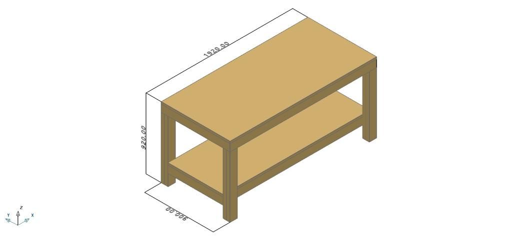

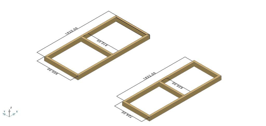

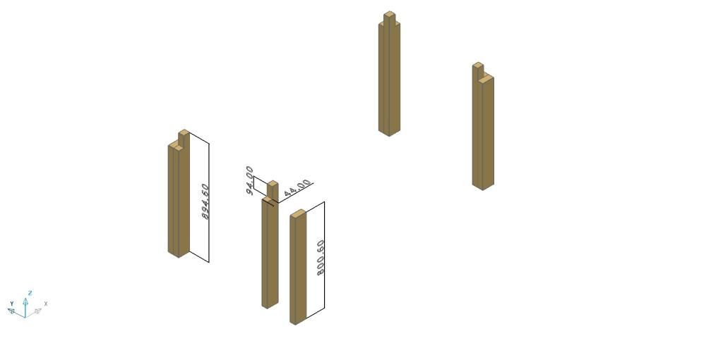

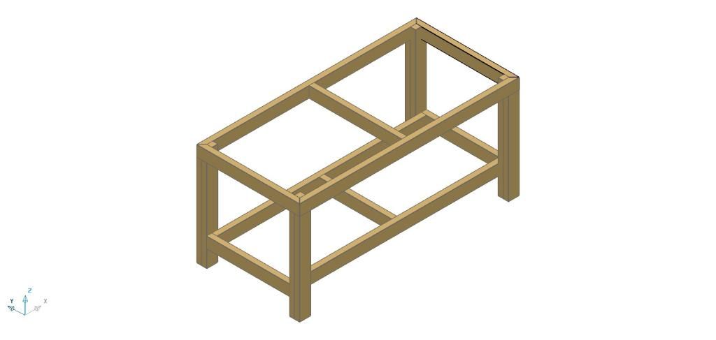

This is what I've drawn up so far so am probably sticking to it or at least something very similar. I don't want to cheap out as i'll be in this house for a while but I just want to make sure I'm not overpaying for the materials I need.
Note: it's actually drawn with a 1" top but which is likely to change depending on what thickness ply is used in the end so that will affect all the other measurements also.

Save more by just buying 2 sheets for £62, glue the two 320 to the 900 top and then use the offcuts elsewhere underneath to just take up the 18mm gap between frame and underside. Save further by using MDF as the other guy said. If youre in it for the long haul, build an MDF one first time and see how long it takes to break it, then make a call one whether to go more robust
