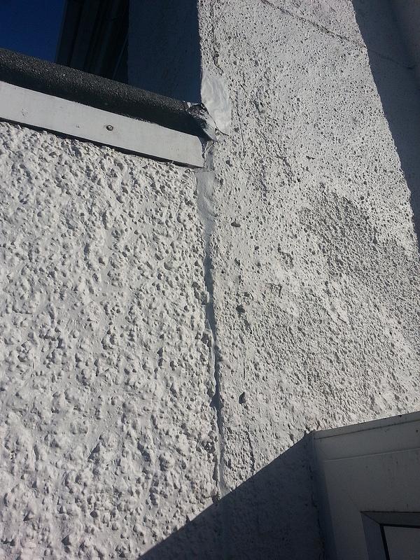

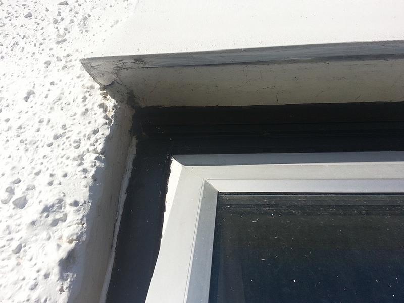

Window frames:

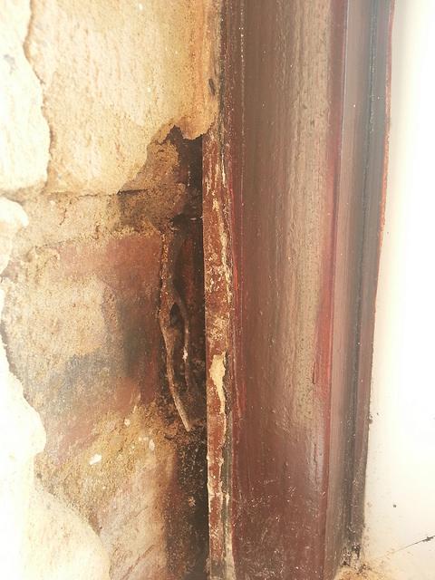

Should a window frame have flashing or something simular? You can see on the pic of a room that hasnt been plastered, that its just window frame on brick.
Looks like its sealed ok from the outside, but is getting quite wet when it rains.
Outside

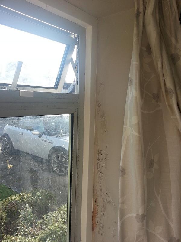

Inside result
Should it be like this, different room without plaster?
Should there be some type of flashing between windowframe and brick?
This is happening on 9/10 windows in the house, so what are my options here?

From the pictures in the original post:
The windows have voids around them since installation, which are as cold as the outside, and warm air from inside has condensed its load of moisture on these cold surfaces - there may also be rain forced in during the storms.
The chimney possibly needs a cowl to keep out driven rain, and/or a fire to keep the flue warm and dry.
