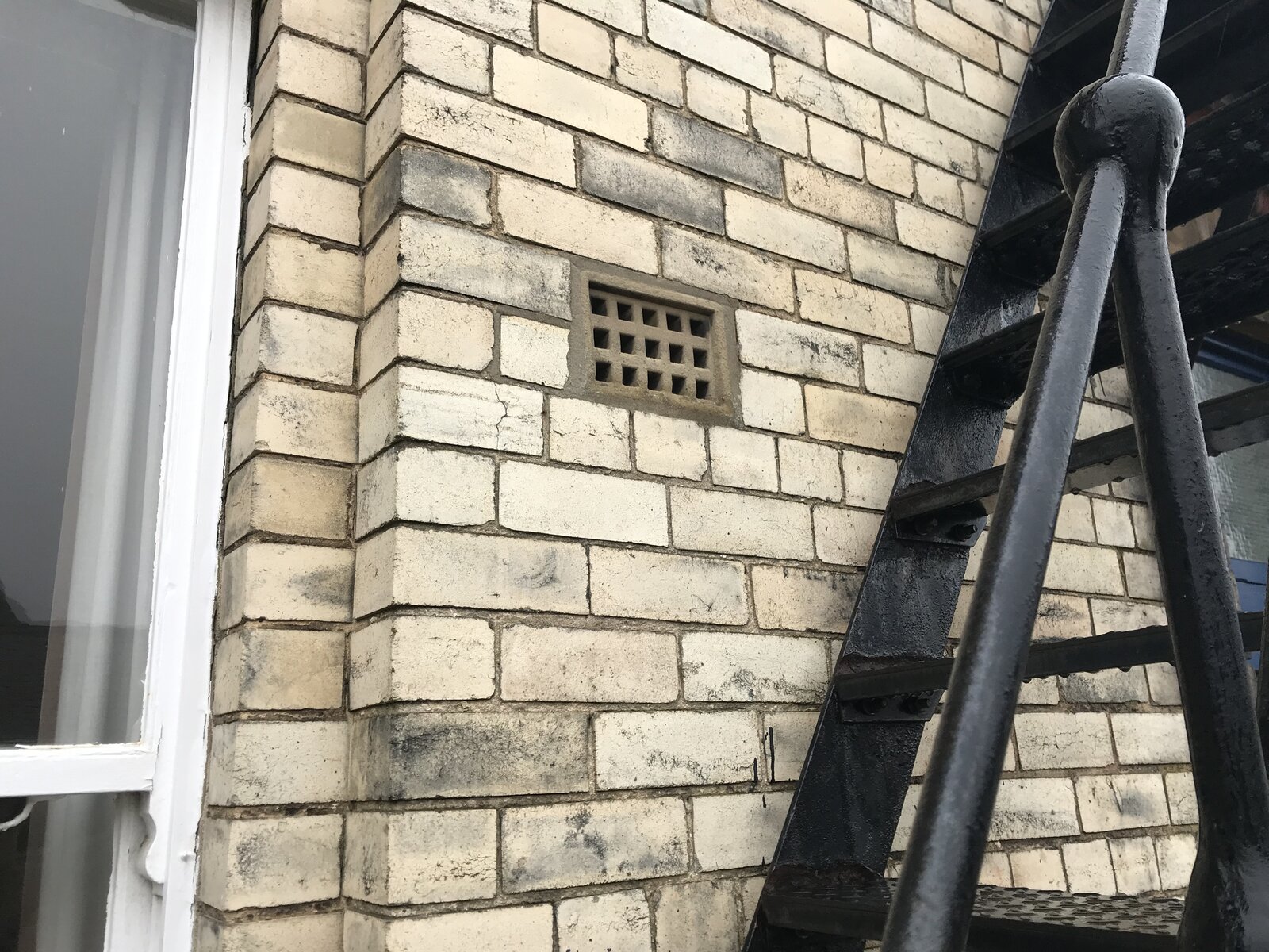

Any idea where i can get bricks to match these old victorian ones in scarborough ? Do i just ask a local reclamation yard ?
They are white/cream style. I want to fill in about 3 air vents i have on the flat. So will need about 3 bricks per vent.

Builders merchants usually able to match up brick type, but may not be exact.
Can try reclamation yards, but might be a bit fruitless as old Victorian building don't get knocked down that often
Gibbs and dandy have a brick library in Pudsey a branch near you might be able to help.
