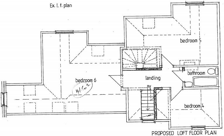

Thanks for all the comments, very insightful. Below is the plan for the house after we undertake the renovation.
I will seek professional advice as I cannot afford to get this wrong, but just for the moment, I want to be better informed and clued up in my mind as to possible options.
The architect has proposed to put the mega flow in the garage as you can see indicated. I was hoping to put the boiler next to it with the flue pointing outside the wall. However, having read MANY posts on this forum in the last 12 hours, I run the risk of upsetting the neighbour whose boundary fence is 500mm away and where there is a fence. Highly likely then that steam will come out their end, so want to be considerate and rethink that idea (I understand it needs to be 600m away for building regs from all these posts). I just don't want a long pipe run going through the playroom to the utility. However, if the boiler is then placed facing the boundary in the bottom right corner of the utility, it will be 1m away from the boundary. Will that be more acceptable?
Secondly, is it possible a second boiler might be needed for the house or would the existing Viessman Vitodens 100-W WB1B 35kw combi be sufficient do you think?
Thirdly, as you can see most of the bathrooms etc are located to the right of the house except for the en suite in bedroom 2. Not all the rooms will be occupied as we are small family who bought into this big project. Is a secondary return needed for this type of house setup if bedroom 2 is not going to be used that much? Is it foolish to have some sort of water heater for just that room rather than always piping hot water there (I'm just brain storming here).
