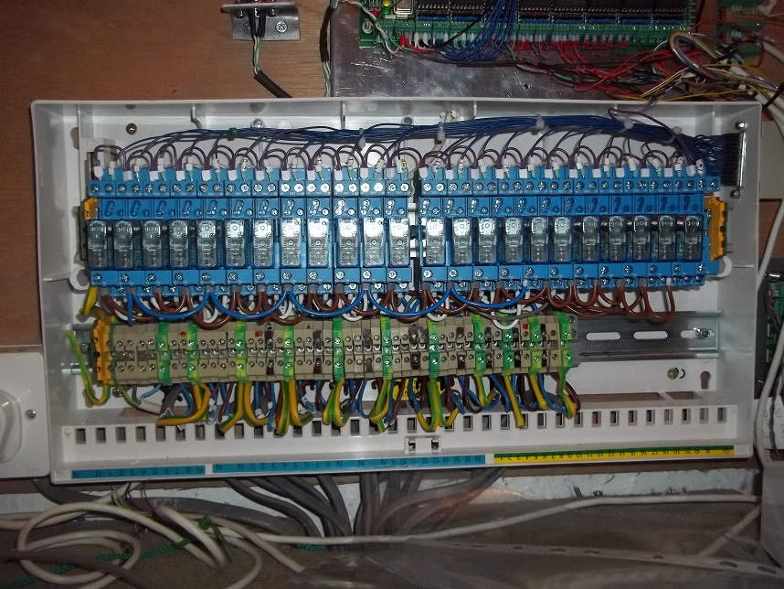

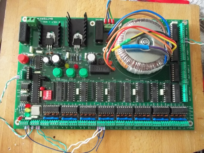

Running cable from each light location to a central controller does have many advantages.
For me the main advantage was being able to use Extra Low Voltage ( 12 volt ) circuits to switches to operate relays This meant I could use 6 and 8 core alarm type cable to the switches, thus avoiding the need to chase out walls for several 230 volt cables.
Having intelligence in the central controller allows multi-way switching, lights coming on and at pre-set times, ringing the door bell turns on the porch light, and many other convenient functions. No Alexa and no wireless linked equipment.
I designed the control processor PCB myself as I am a retired electronics designer engineer and that is what I love doing.
Thanks Bernard. Impressive work!
