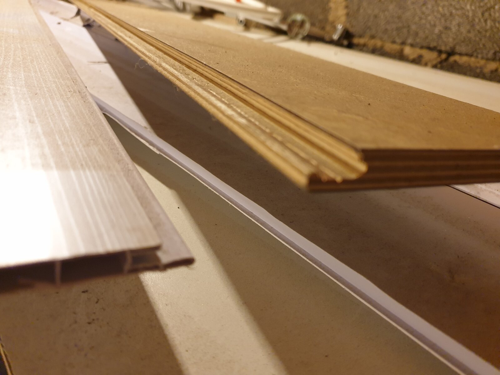

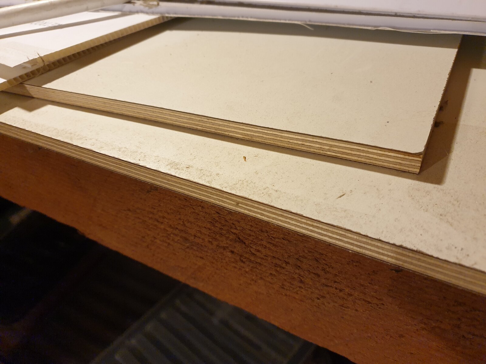

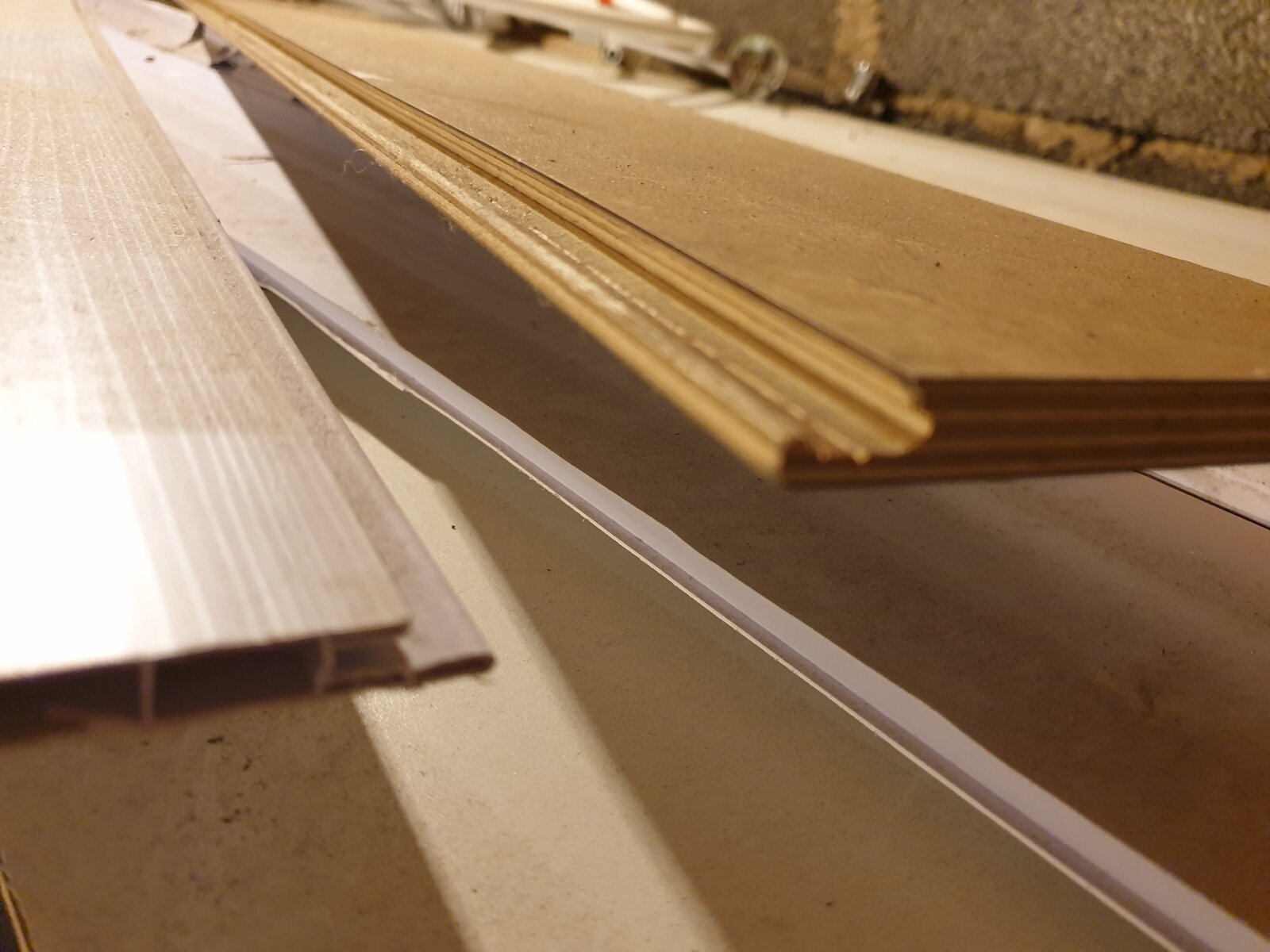

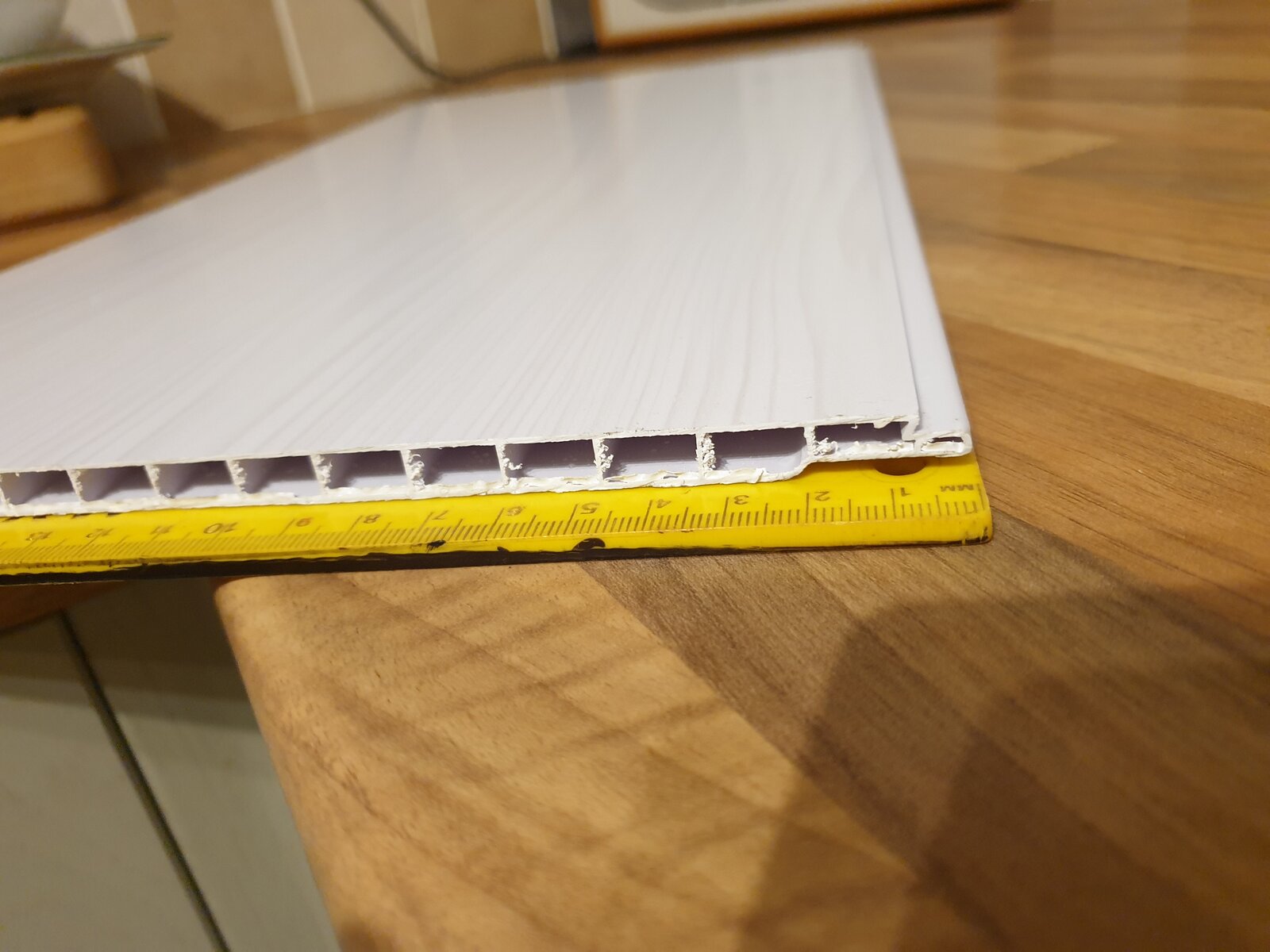

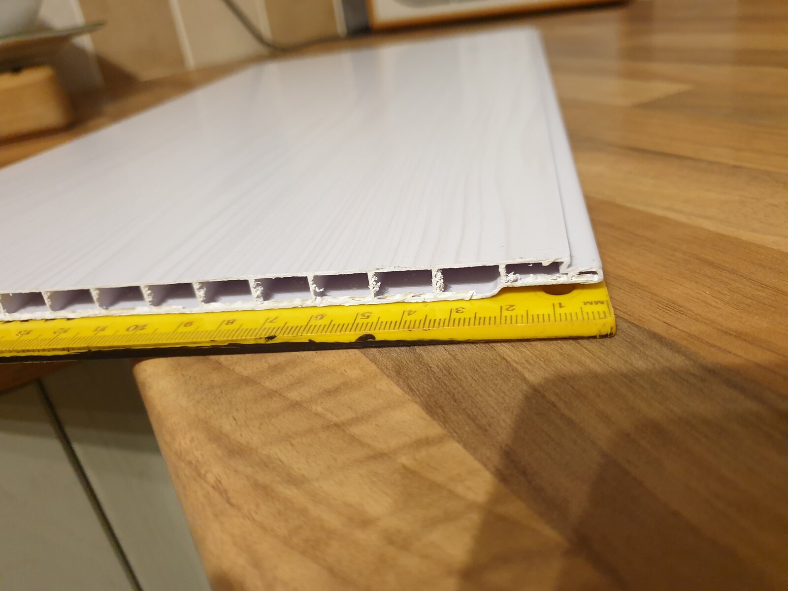

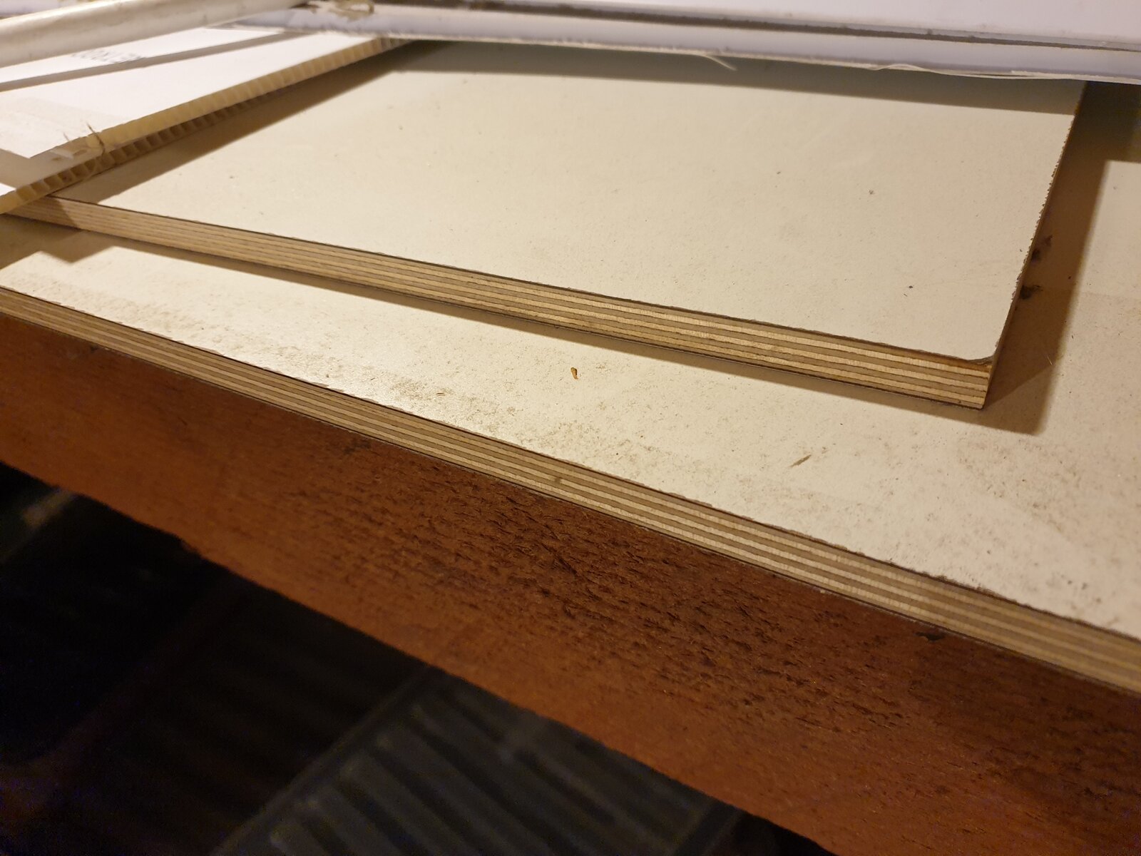

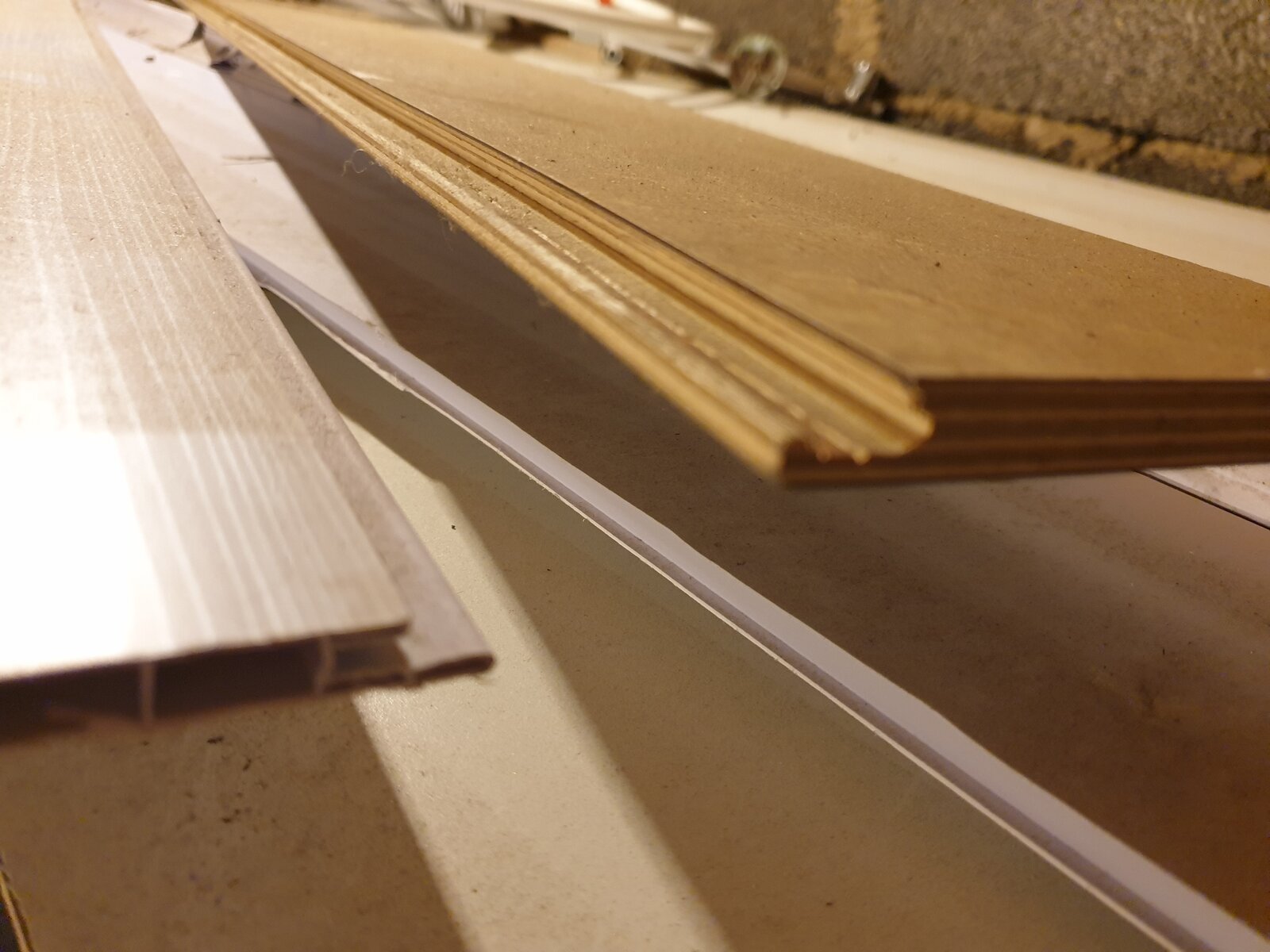

20220228_175024.jpg 20220228_175127.jpg 20220228_180145.jpg 20220228_180152.jpg
The first two pictures are of Travertine Multipanel. It's 10mm thick.
The other two pictures are Multipanel ceiling panels. They are 8mm thick.
I hope they help you to see the construction and how they fit together.

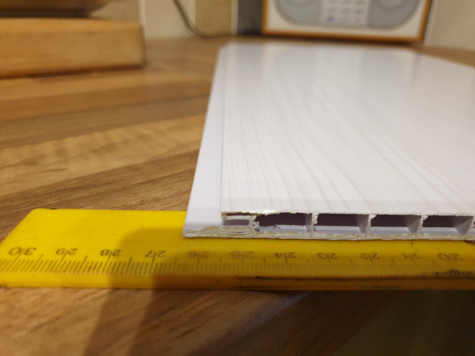

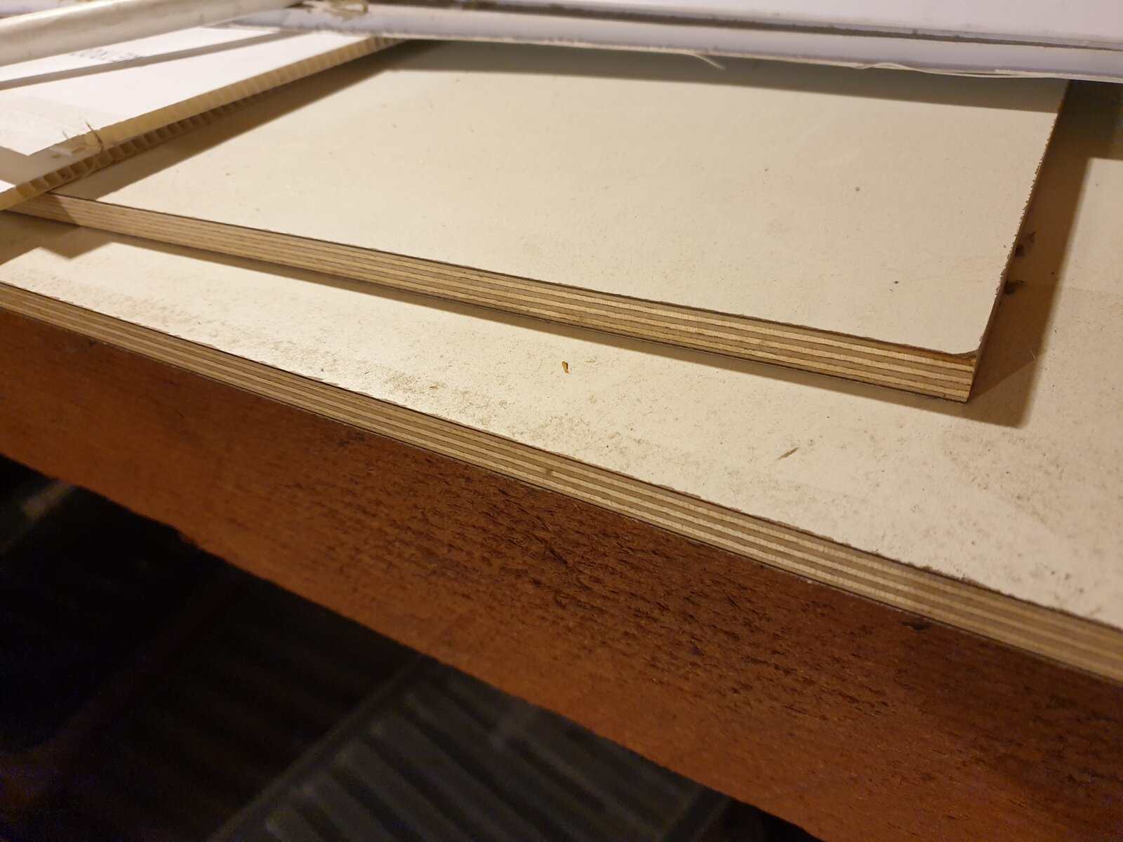

View attachment 262614 View attachment 262615 View attachment 262616 View attachment 262617
Thanks, the multipanel Travertine has some kind of made made wood in it? I would have thought there would be a chance it would become damp inside it due to it being some kind of wood?
