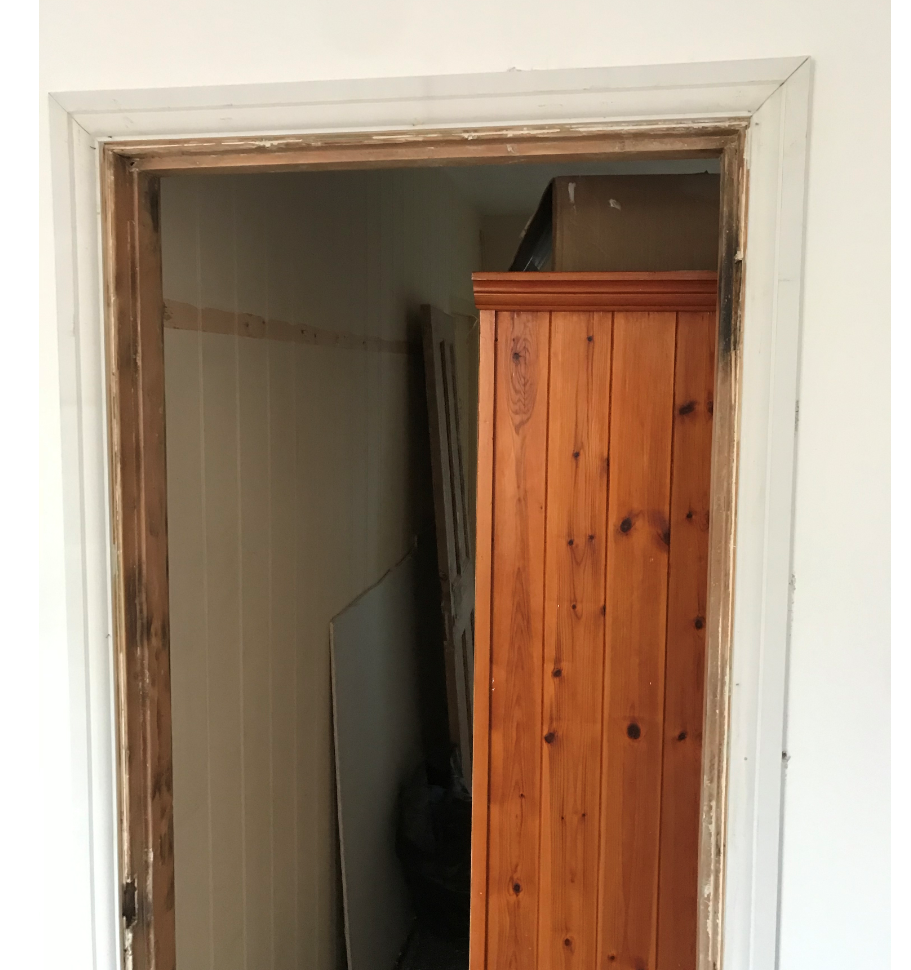

My instincts tell me that the top part goes in first. Can someone provide guidance in this please.

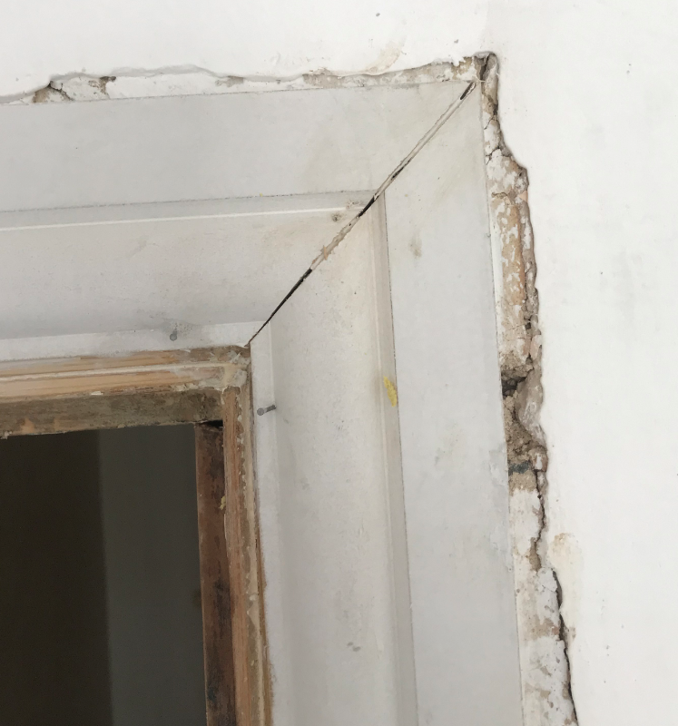

This is how my 45 degree mitres ended up. Is that acceptable gaps and should I use a filler for these or caulk them?
I need to tidy the plaster around the side.

On door casing it should be 45 degrees otherwise your doors will have far from parallel sides. If needs be you can check the angle in the top corners for squareness using a try square and adjust the angle on your mitre saw accordingly (shouldn't be more than a degree or two in practice - anď that sort of difference I can/would adjust by using a sharp block plane on the leg mitres)
Note that it may be necessary to Mitre Mate the corner mitres and pin the tops of the legs well.down then flex the rest of the legs into position (and then pin) in order to either desl with a barrelled frame or a warped architrave leg
Also note that your mitre saw may well not be cutting a true 45° angle and it may be necessary to check and adjust that before making the cuts. On the subject of open mitres and filler, all I can say is that tradesmen simply aren't allowed (OK, supposed) to do that on a build - it's a pull which would mean the archis having to be ripped off and redone. Filler never works for that long as mitre joints sre prone to opening unless you make 'em tight and use Mitre Mate! Even then a few might still open if the timber was badly stored
