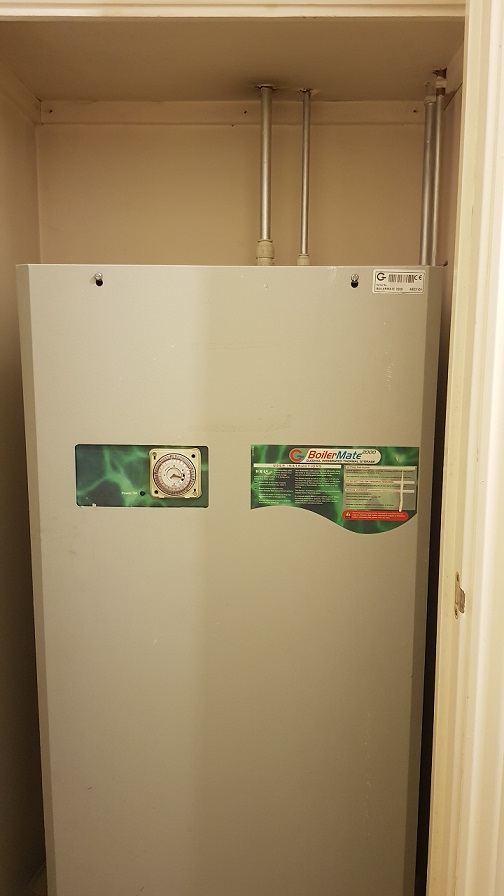

Your Boilermate requires a small top-up tank, but this could be mounted directly above it, not necessarily in the loft. If you can't get up there, look for pipework going up from the Boilermate.
Replacement of the BM with an unvented hot water cylinder will remove the need for a loft tank.
BMs are not great, but your low flowrate symptom may indicate a partially blocked inlet filter, or maybe a scaled heat exchanger on the BM...do you still have soft water in MCR?
As for boiler sizing; if your boiler heats up all the rads, and the rads get your 4/5/6....20 bedroomed house warm, then it's powerful enough. Lucky you to have such a well insulated house! If you do change the boiler then be aware that most (if not all?) modern boilers will modulate from full power down to about 25% power, so an 18 kW or 24kW boiler would probably meet your needs, heat up the system quicker, and cost no more to run (but certainly less to run than a Classic). One caveat on that; a more powerful boiler needs a larger gas supply, so going larger may entail having to upgrade your gas pipework.

There are a few pipes attached with boilermate and are going upwards probably in loft. I have attached the image of it with this post.
To be honest, I am more concerned about the explosions which occur for few seconds in the Ideal boiler when it comes on and less about the water pressure of Boilermate at this time.

Soft water in Walkden mate won’t be scaled. What I tend to do with these set ups Saaz is take out boilermate and presuming pressure and flow rate is adequate which it is likely to be with a boilermate as I’m presuming you’re in a new build and there will be a 22mm main all the way up to the plate is rip out and replace for Unvented hot water and convert system to a fully pumped S Plan set up.
