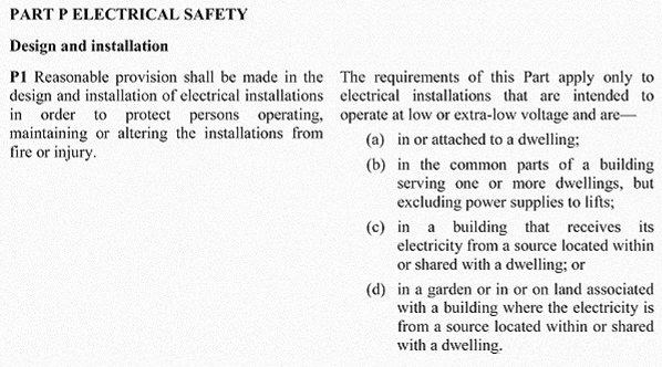

I have .....
- Part P
What do you mean by that? Part P of the Building Regs is only one sentence, so it's hard to see that one can have very much 'training' in relation to that :)
Do you perhaps mean that you are a member of one of the 'competent persons' ('self-certifying/notifying') Schemes and, if so, which one?
Kind Regards, John
Part P of the Building Regulations C&G 2393
"Training" is as much as a few hours reading :LOL:
but with the 60% pass mark, one could skip the reading and just proceed to "exam".
Aren't what you are calling '18th edition' and 'Part P' the same thing?
Part P being a misnomer for the 18th edition regulations course.
Actual Part P of The B.R.
That's all of it; there is no more.
Part P of the Building Regulations C&G 2393 ... "Training" is as much as a few hours reading :LOL: but with the 60% pass mark, one could skip the reading and just proceed to "exam".
Fair enough, but the C&G really should know better than to give it such a title, since its scope obviously must go beyond just "Part P" - since as I said (and you presumably know) ..
Part P of the Building Regulations (IN ITS ENTIRITY) said:
Reasonable provision shall be made in the design and installation of electrical installations in order to protect persons operating, maintaining or altering the installations from fire or injury.

The city and guilds course designation is
Building Regulations for Electrical Installations in Dwellings (2393)
Various training establishments advertise the course as 'part p' to entice students.
The city and guilds course designation is Building Regulations for Electrical Installations in Dwellings (2393) Various training establishments advertise the course as 'part p' to entice students.
Ah, thanks - much more sensible. I therefore withdraw my criticism of C&G !
