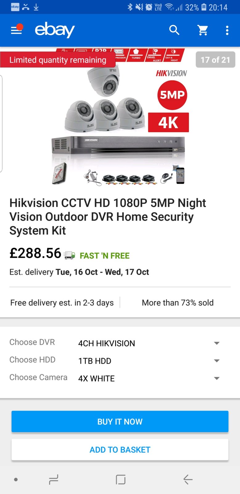

I only really need 2 cameras maybe 3 at most I have just spotted a setup on eBay which looks to an amateur a good deal. See below if it's against the rules to post a link please delete.

I'd be careful about this.
Are these genuine EU model Hikvision from an authorised UK distributor? If they are grey imports you will find they are not supported by Hikvision.
The description is ambiguous. It says they are 1080P, which is 2 megapixels. But then it says 5MP - 5 megapixels. Can they all record at 5MP, or only 2MP?
Also are the cameras actually suitable for your particular application? The focal length isn't quoted, and there are different lenses available. Do you need wide-angle lenses like 2.8mm, or narrow-angle like 12mm?
