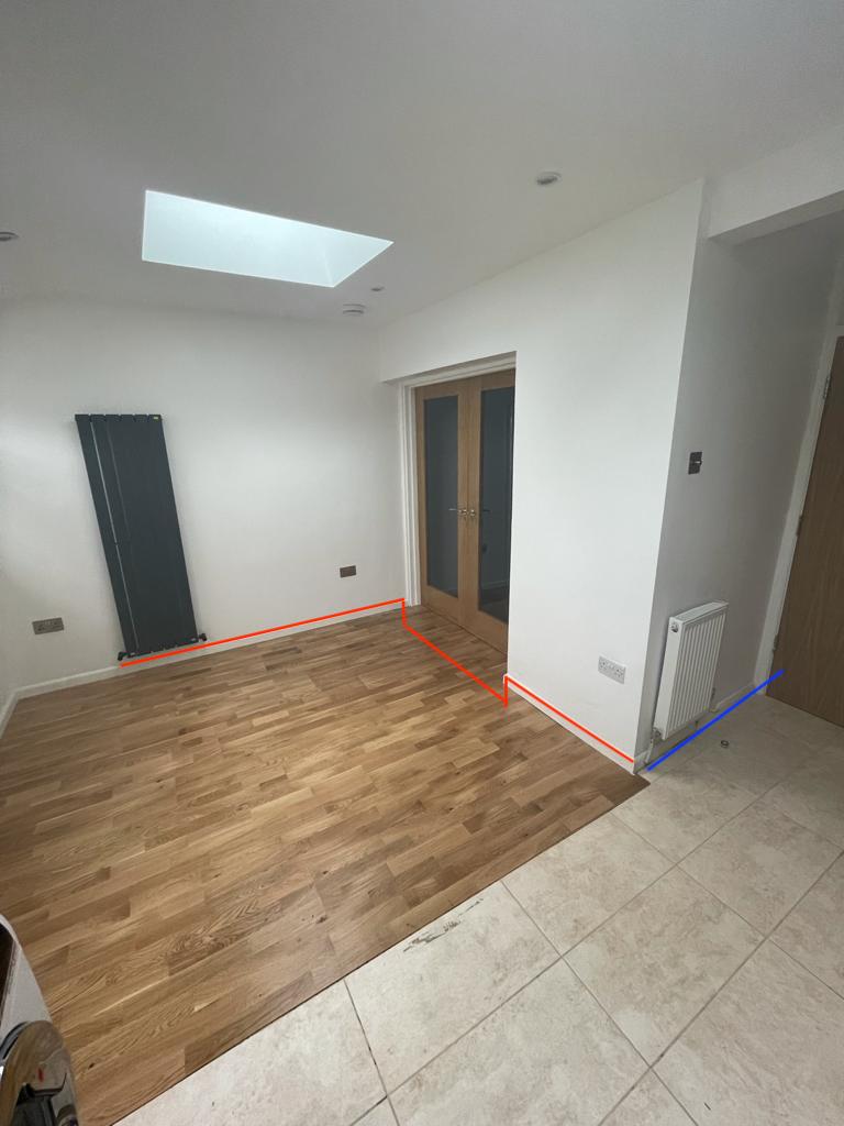

Some update on what has happened. The CH engineer that the builder sent Installed a new circulator Pump and came to conclusion that the new rads were not installed correctly. The builder has told him to rectify the issue .... which I am assuming would mean abandon plastic pipe work to the tall rad (since buried in concrete under wooden floor )and fit a new one.
Now the question is which route should the pipework take?. Attached is picture of the extension. Blue line is the existing pipework.
Am I correct in my thinking that the new pipework to the Tall rad should be as I have shown (red) in the picture?. Is it possible to dig a channel through the concrete by the doorway or that's a no no?
Depends what's wrong with the installation. If they've been plumbed wrong way round that can be fixed (unless only 1 has been reversed, in which case more tricky).
If the pipe size is inadequate then yes new pipe time. You can channel into concrete, it's messy and making good is a pest but doable (long as it's ground support not block & beam).
I also suspect that your sister hasn't paid good money to have a load of pipework clipped to the skirting board- rectification should include having the same standard of finish as current (ie pipes hidden).
Depending on what the walls are made of, which way the ceiling joists go etc. it may be easier to hack chunks off the walls and ceiling, run the pipes up over and down and make good.
Agree with @oldbutnotdead it needs to be re-done to the same standard as the original (except ensuring it works this time of course!). Don't accept short-cut solutions which won't look as nice.

mmm.... what a mess. I am assuming the new guy will want to do his work fully and not have to worry about shoddy work by previous plumber.
From pics my sis sent me during build, I think whole area was filled with concrete. Could channeling not result in a crack all the way to the dpc ?
Regarding the wall (of the extended portion) I think they covered the brick with plasterboard.
