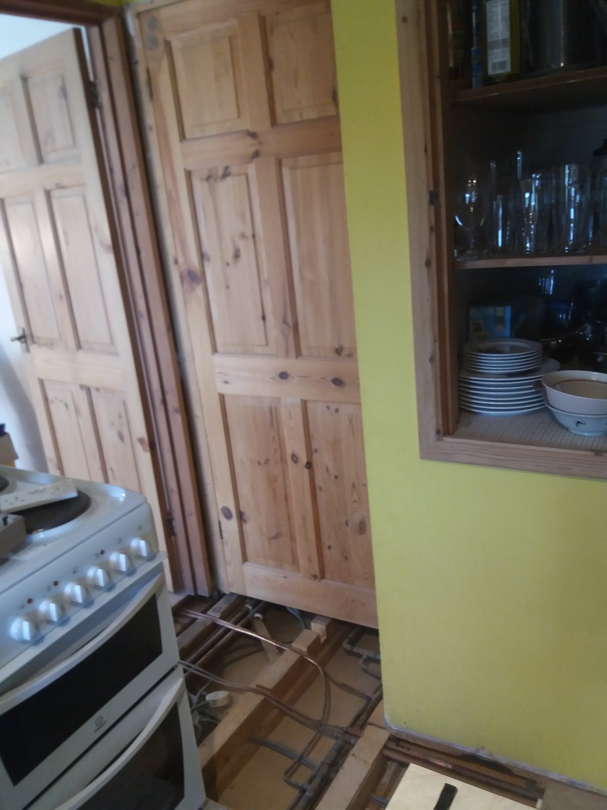

Can anyone recommend a consumer units that screwfix stocks? The prices seem to vary from £80-£230? I have a 3 bed end of terrace with the old style fuse box and would like to upgrade. I probably don't need top spec.

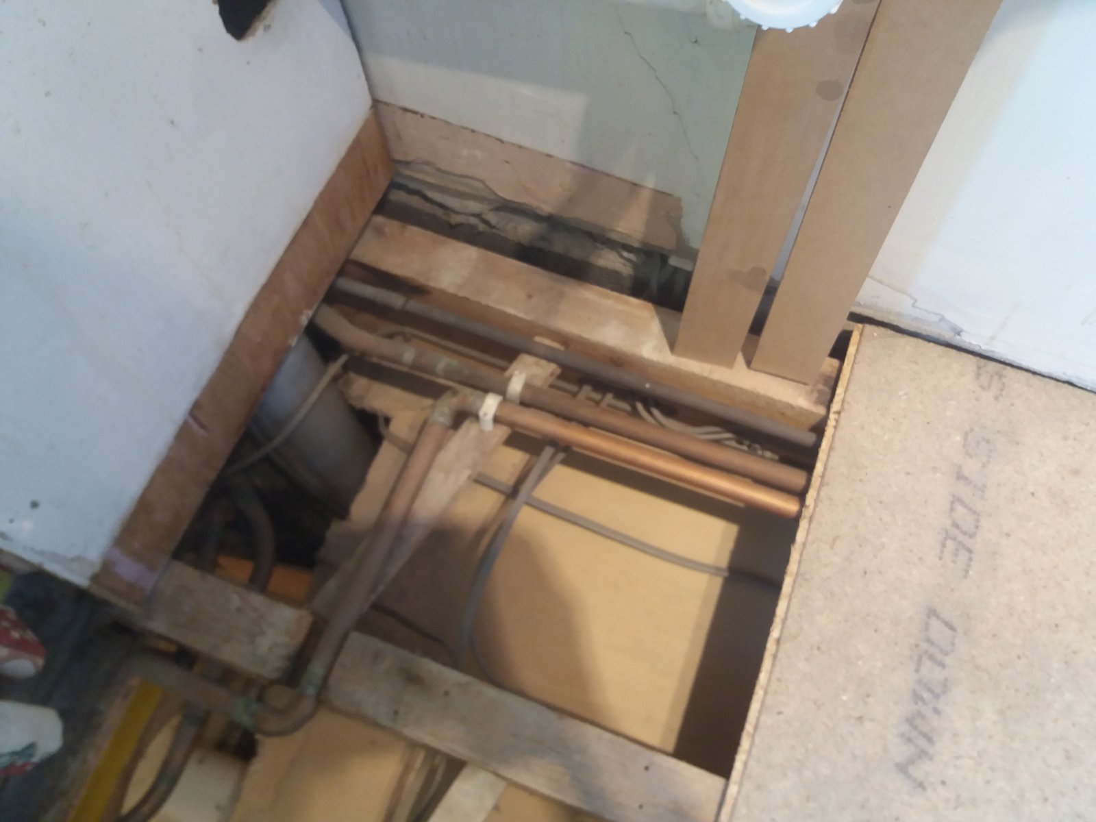

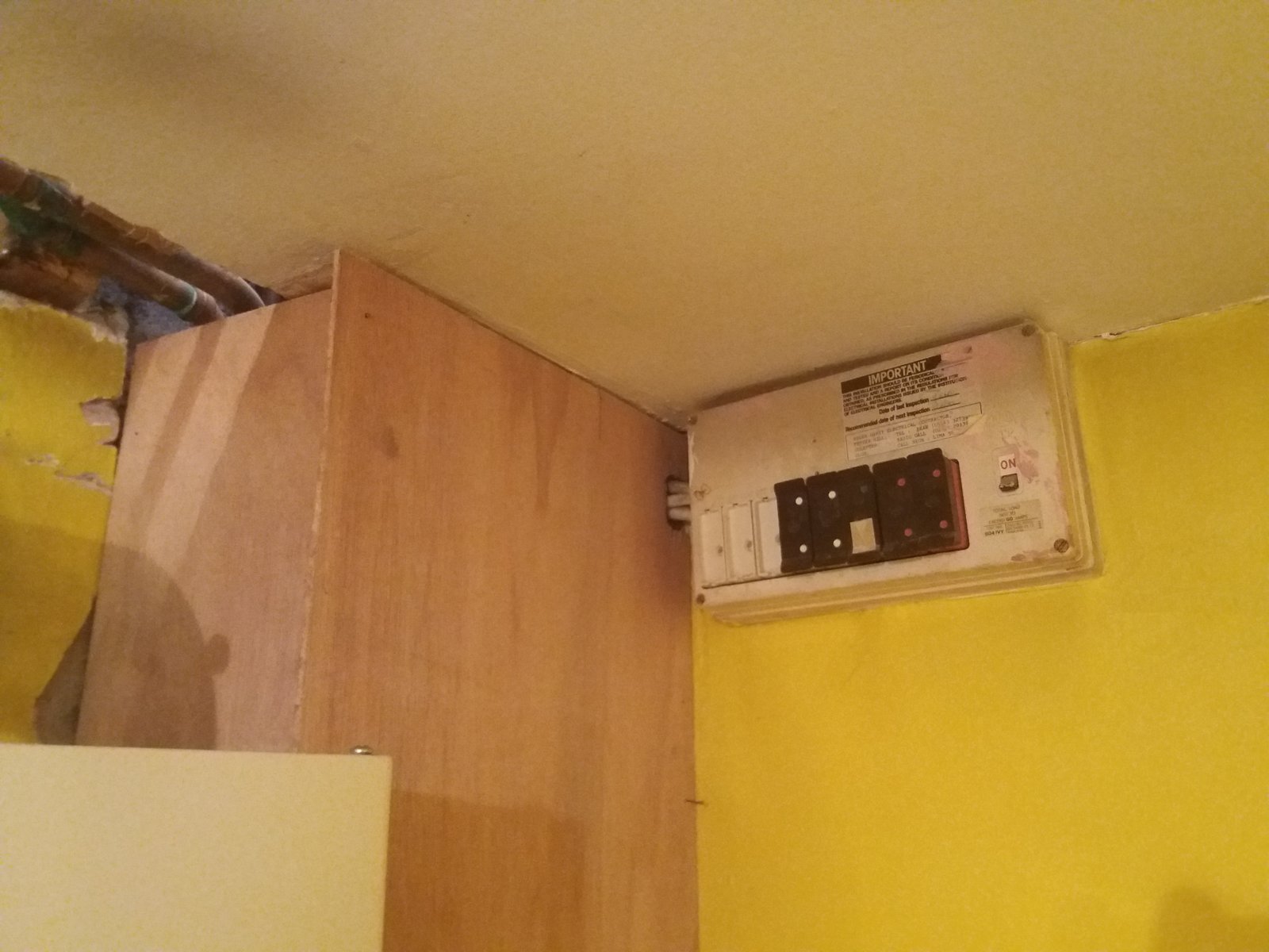

5 fuses in the existing fuse box, boards all up, access everywhere. CU to be installed in room above where existing fuse box is currently sited, cables going up thru existing box-out (which is open).

Fuse box in ground floor room.
Cables coming up in corner of 1st
floor kitchen.
Other end of (tiny) kitchen, CU to be sited in cupboard over stair
well, on left side of middle shelf where glasses are are shown.
