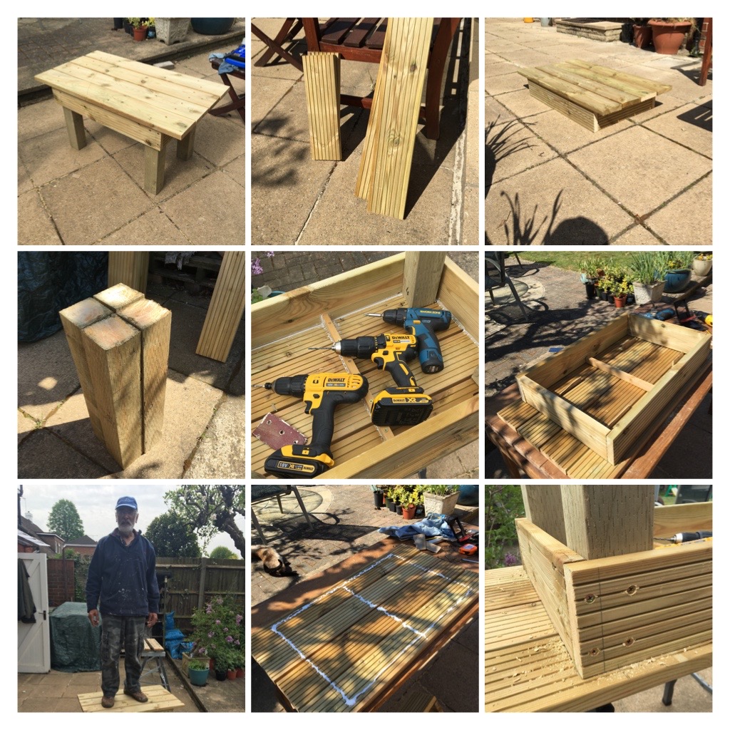

Definitely not paint. I've used Sadolin in the past and been happy with the results.
If possible use pressure treated wood. I used decking for the top (smooth side up) and fence post for the legs - all pressure treated. More rustic than fine furniture but strong. Finished with outdoor water based varnish to seal which i know will need redoing every few years but hopefully no rot.
