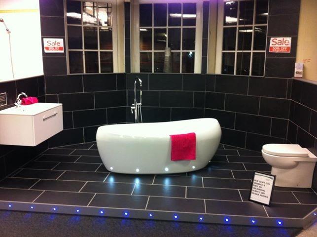

Be best to tile whole room first before fitting any units or pottery as if changed later on down the line means having to re tile room not just changing of any units or pottery plus makes it lot easier than having to cut around when tiling
We do this at the shop means we can change displays without having to re tile all the time ,lot easier to just change the displays without having to change tiles eg lift one sink,bath,loo out replace with another, no re tiling
Hello,
I would personally suggest completing your floor prior to any further work being carried out. If in the future you decide to change the toilet or vanity then you can simply remove these and replace without any flooring concerns.
