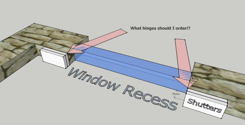

... can anyone tip me off as to what these kind of hinges would be called?
Basically my wife would like me to fit interior shutters to a window, and they should be able to fold back, flush with the wall, revealing the full window when open ....
Be so grateful if anyone could give me a tip!

Apart from the annoying voice, are they different from Parliament hinges?
Some of the ones in the link are Cranked hinges.
Thanks Freddy! Still got no idea how you got those letters to appear in the little search box, let alone in the right order etc., but your amazing link just did it all for me. I'm all made up. Genius.
