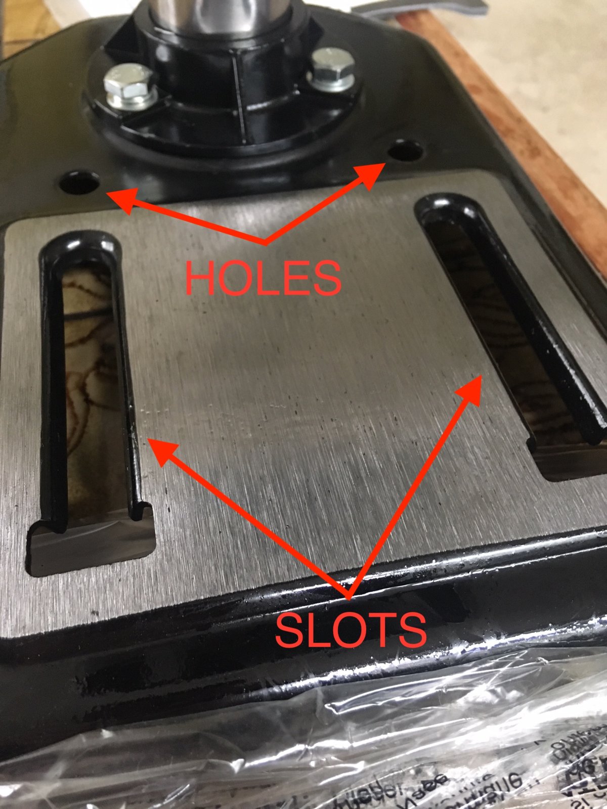

Bit of an odd question this, but hopefully it doesn't sound too daft asking it! Thought it might be best to post it in this woodwork category.
I've got hold of a small pillar drill, which needs to be attached to my workbench. Looking at the base though, I'm unsure what 'holes' I'm supposed to use? Do I use the two slotted sections or the two actual holes behind them? Or doesn't it matter?
My immediate thought was the slotted section, which I guess would mean I could slide the drill forwards and backwards? However, seeing that it is chamfered the way it is, it would mean the bolt heads would not meet flush. Perhaps then the bases slots are for a vice? The bolt sizes needed for either hole are different too, meaning that I'd need different bolts/washers.
Any advice greatly appreciated.
The slots are actually for tee bolts to fit into, which in turn allow a vice to be bolted to the drill foot and moved around.
Usually four securing holes are available, but on this one use the two you have marked - but don't overtighten to such an extent that the base distorts.
John :)
@Burnerman Great, thank you!:) Holes it is then. Regarding over tightening, I thought I might get some rubber washers to add a little cushioning? I'd heard it's easy to crack the base plates otherwise.
The base is cast aluminium and therefore quite fragile - however there should be plenty of contact points on the bottom of it which should prevent any distortion (old traditional drills had a cast steel base - but you couldn't move the bloody things :eek:)
Just check to see that the base is solid below those two holes....if it is, feel free to bolt it down. I don't think you'll really need any rubber washers but I'd try to use penny washers on the bench underside.
