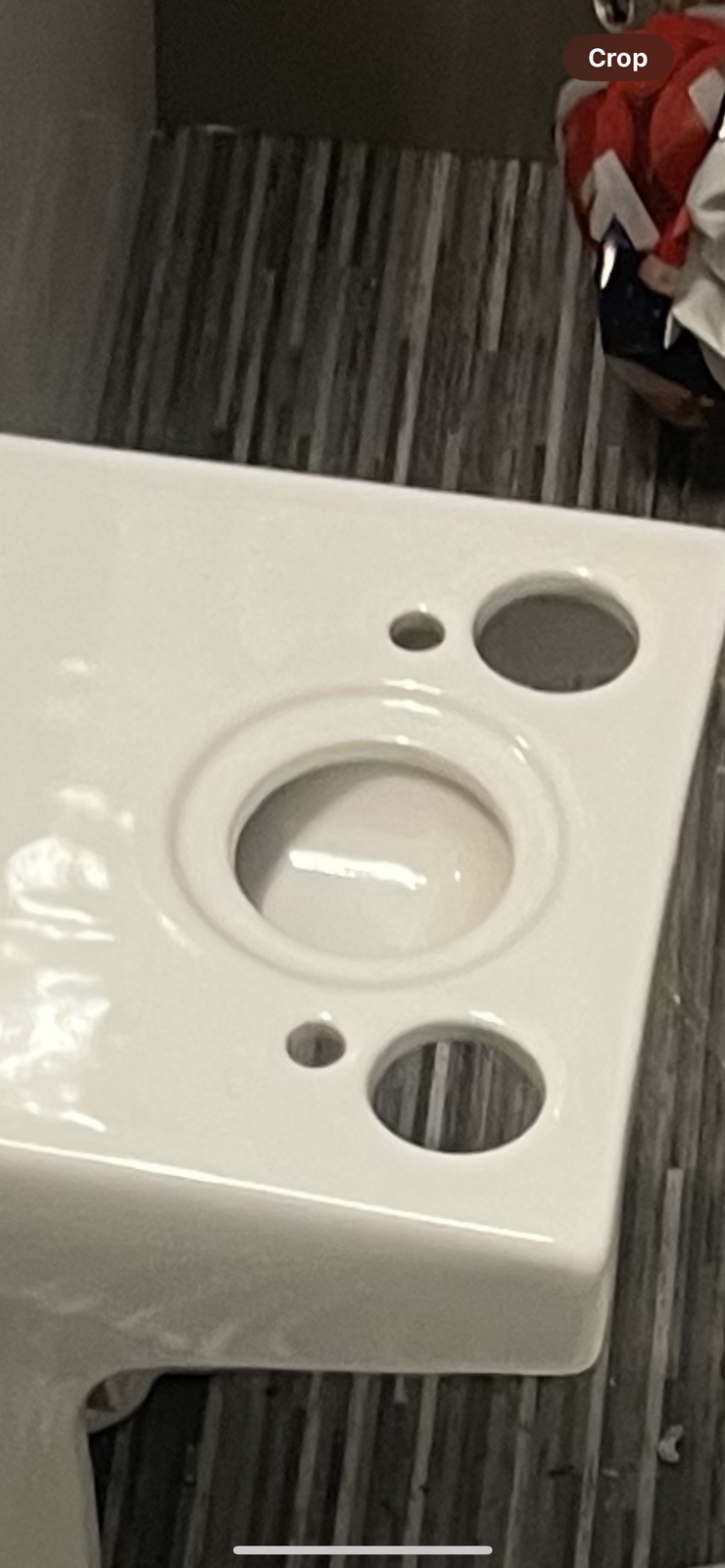

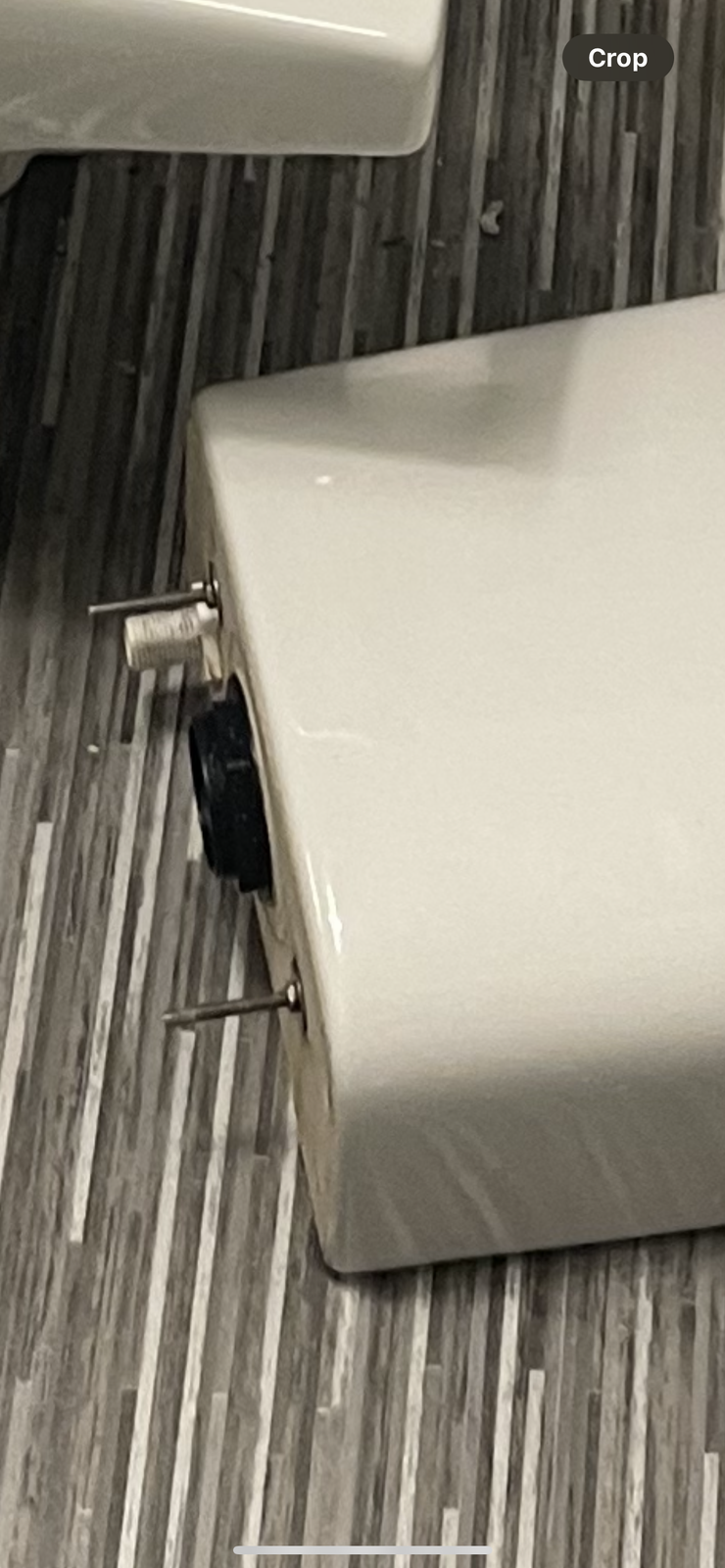

which ideal standard coupling kit do i need? the code on the inside of the cistern says j5234 iss ithink its a tempo toilet? the outlet hole 2"
do i need a flat or raised plate?

One that fits ;) You just need a doughnut as long as you have the butterfly nuts and the washers for the bolts.
Seriously though, measure the inside and outside diameter of the pan flush hole and match it to a doughnut. Most of the IdealS' are 110/75mm if I remember correctly.
You don't need a coupling kit ,just a donut washer. The bolts in your pic should have nuts and washers to use on the underside of the pan.
Great thank you makes sense that you just use the bolts already attached to the cistern
