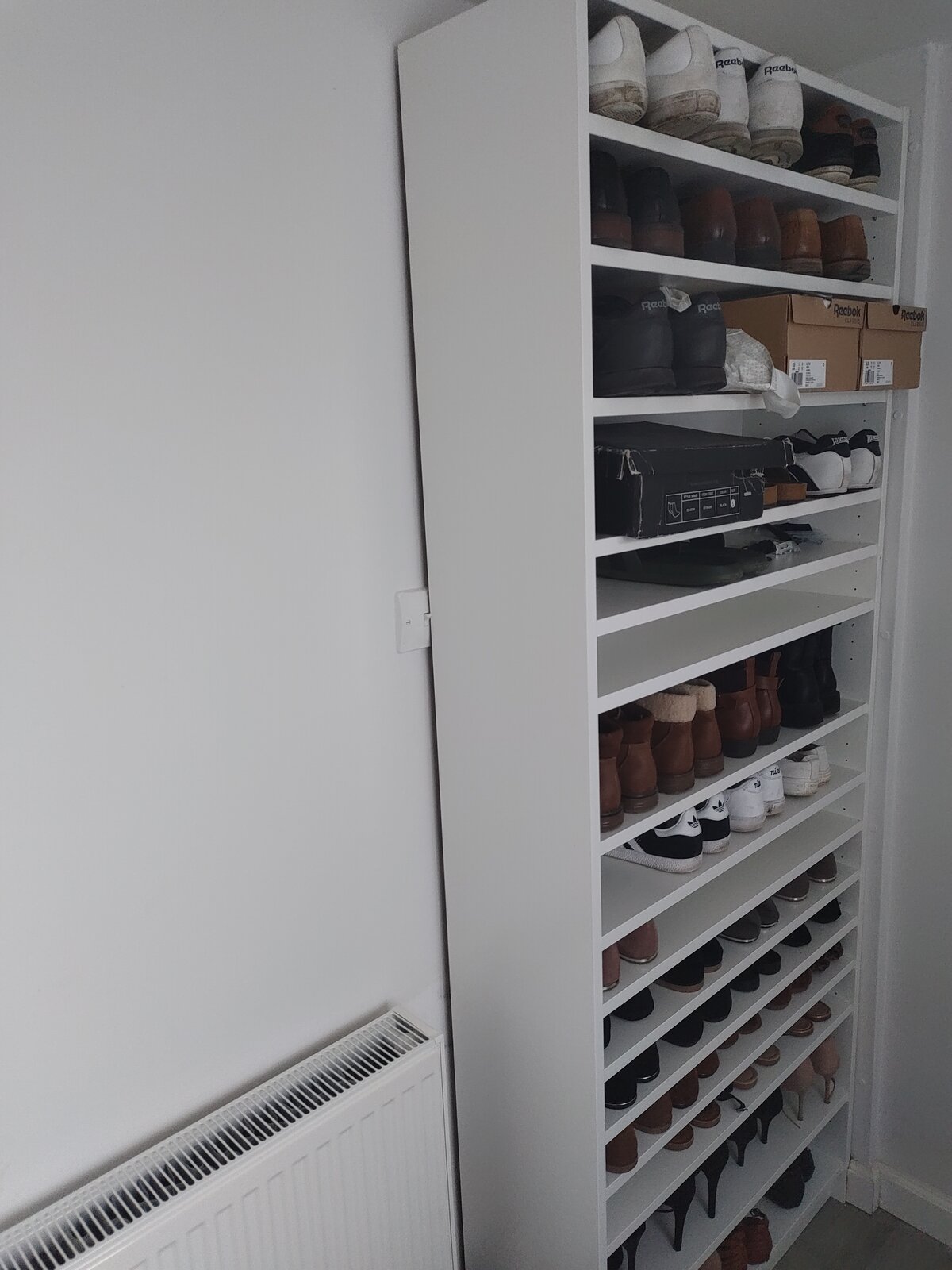

Hi guys. I wanted to give an update. I bought a used billy from facebook marketplace for £20 and bought another for £20 for extra shelves (extra shelves from Ikea are an extortionate price).
Anyway, I have a new problem now as per the photo below lol.
I have posted my issue here: https://www.diynot.com/diy/threads/do-offset-light-switches-exist.603858/
Thanks.
