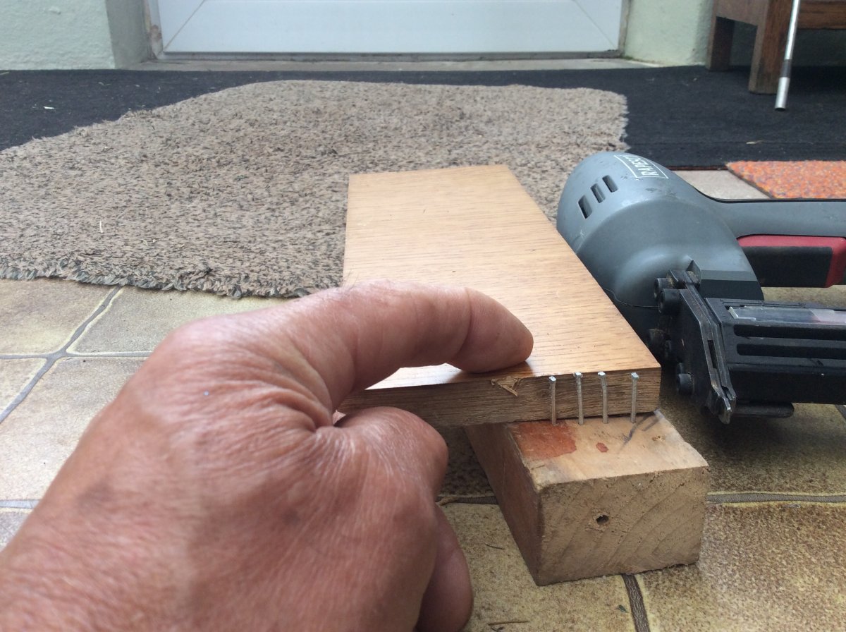

Hi all
I'm working on a "hobby" kind of project at the moment which requires me to hammer in a multitude of approx 35-40mm nails to a depth of about 10mm in MDF. This leaves the nails sticking out by about 25-35mm, so they don't need to be driven all the way.
It's fairly laborious and I was thinking a nail gun would help me achieve the results in much less time.
I don't want to spend a huge amount of money, not do I want an air driven device.
What kind of nail gun should I be looking at for my requirements? Any suggestions on specific models?
I doubt you will have much luck - nail guns are for driving nails all the way in.
There are tricks you can do with a 1st fix nail gun to achieve this (useful for shuttering at times) but it still requires a first fix gun and they don't come cheap (£350 and up). The other issue might be nail length - 1st fix nails are 51 to 90mm long and nobody makes shorter ones
In order to fire the nail the safety mechanism has to be in contact with the wood your firing the nails into so this would have to be held back in the fire position?

Edit: Just tried on mine,if the brads are thin then they bend slightly as the top bits are not suported while being driven.

Thanks. Judging by the photo, it looks like it could perhaps be feasible then. Unfortunately, I don't want to spend in excess of £75 on something that only *might* work. Tough one!
The technique is to cut a 6in strip of hardboard or thicker plywood and jigsaw a notch in the end. This is placed on the surface of the workpiece and held with one hand whilst the nailer or pinner is used with the other hand. The nose piece of the nailer/pinner is tested on top of the hardboard before pulling the trigger. It works with 1st fix nailers and also with 2nd fix nailers (16 gauge) into softwoods but 18 ga us probably too thin and the pins will quite probably bend. DO NOT get into the habit of holding the nose back and firing any nsil.gun or staples as you really are inviting a very painful accident. Either way getting a 4mm nail 10mm into a surface is probably asking too much because the nail.needs to be supported by the timber at the point of entry. The thinner the nail, the more the support it needs
