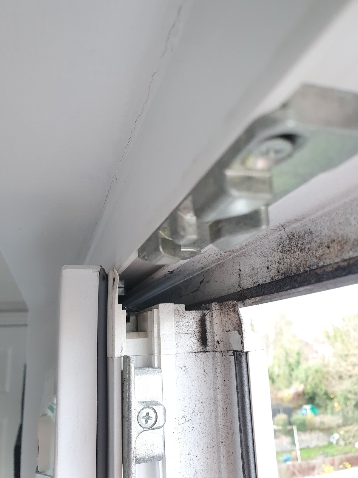

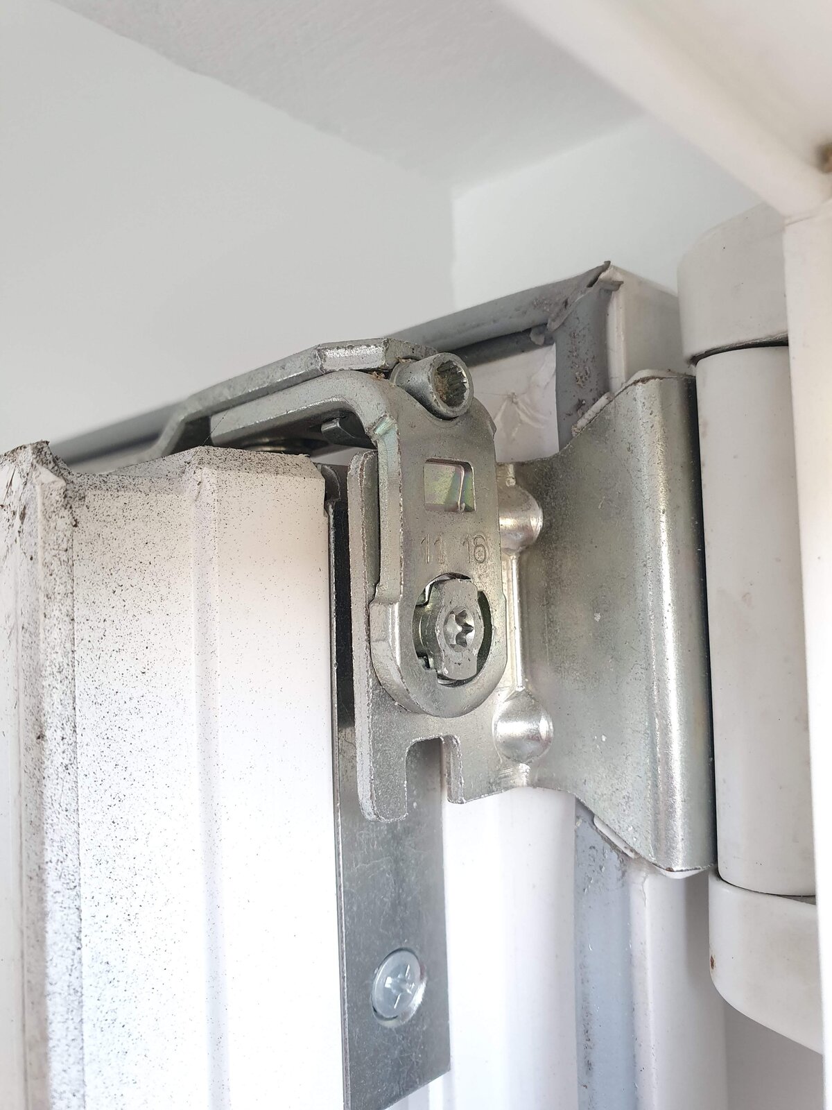

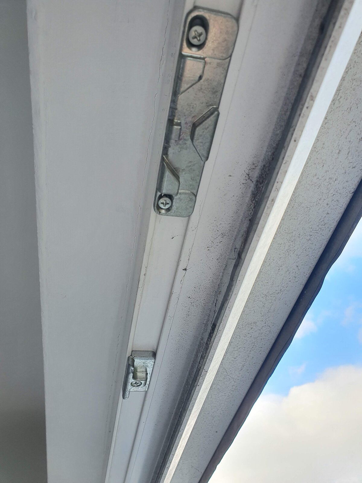

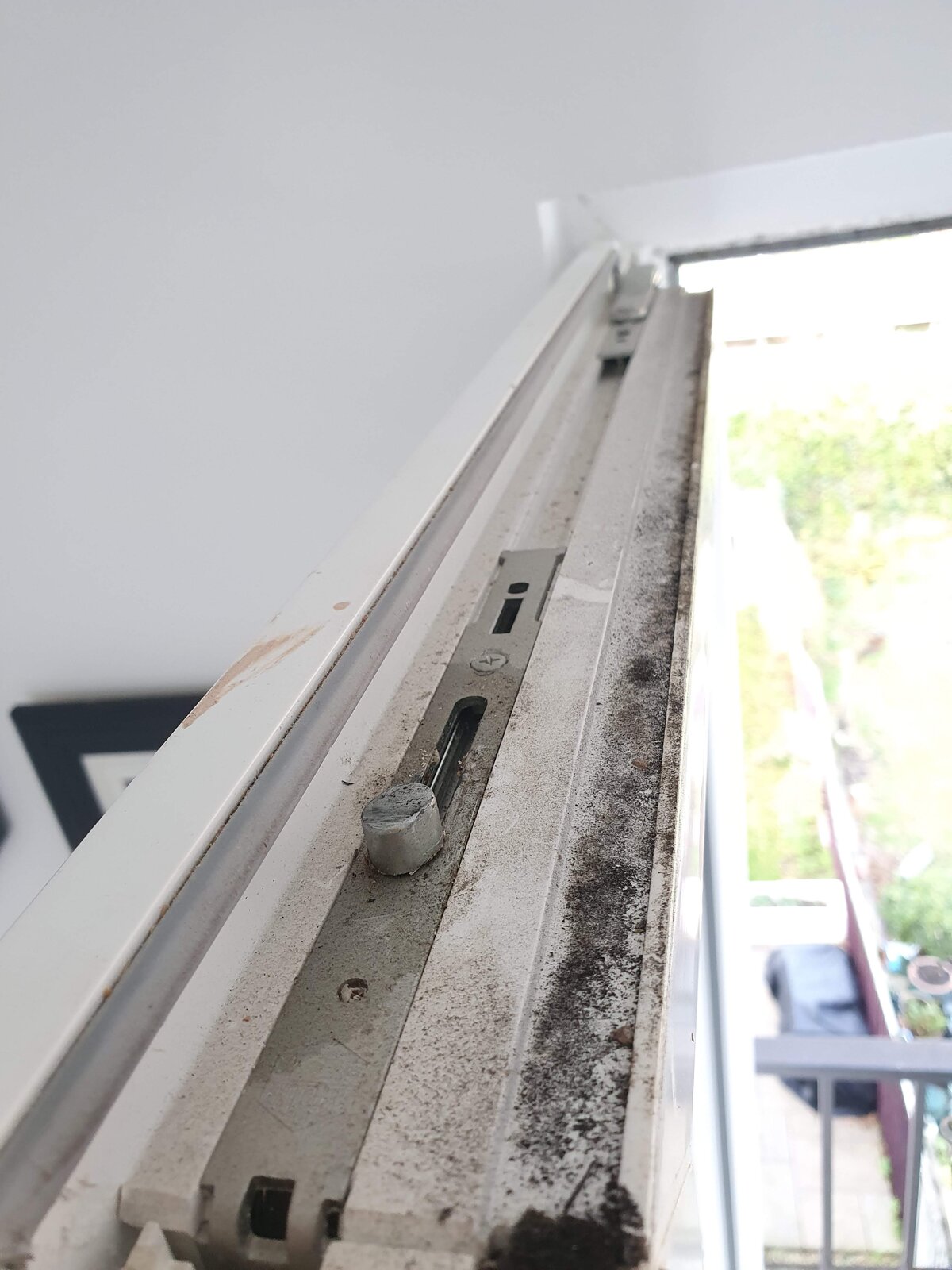

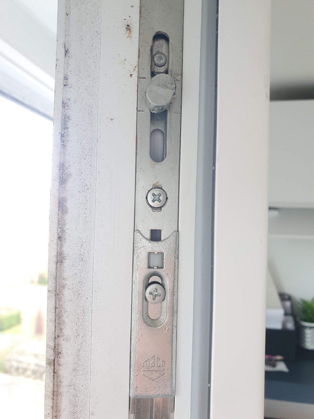

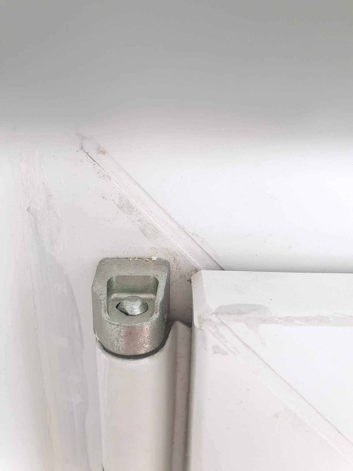

Which of these hinges, if any, can raise the door? Don't recognise them from anything else I've seen
23 Jul 2012
6
London

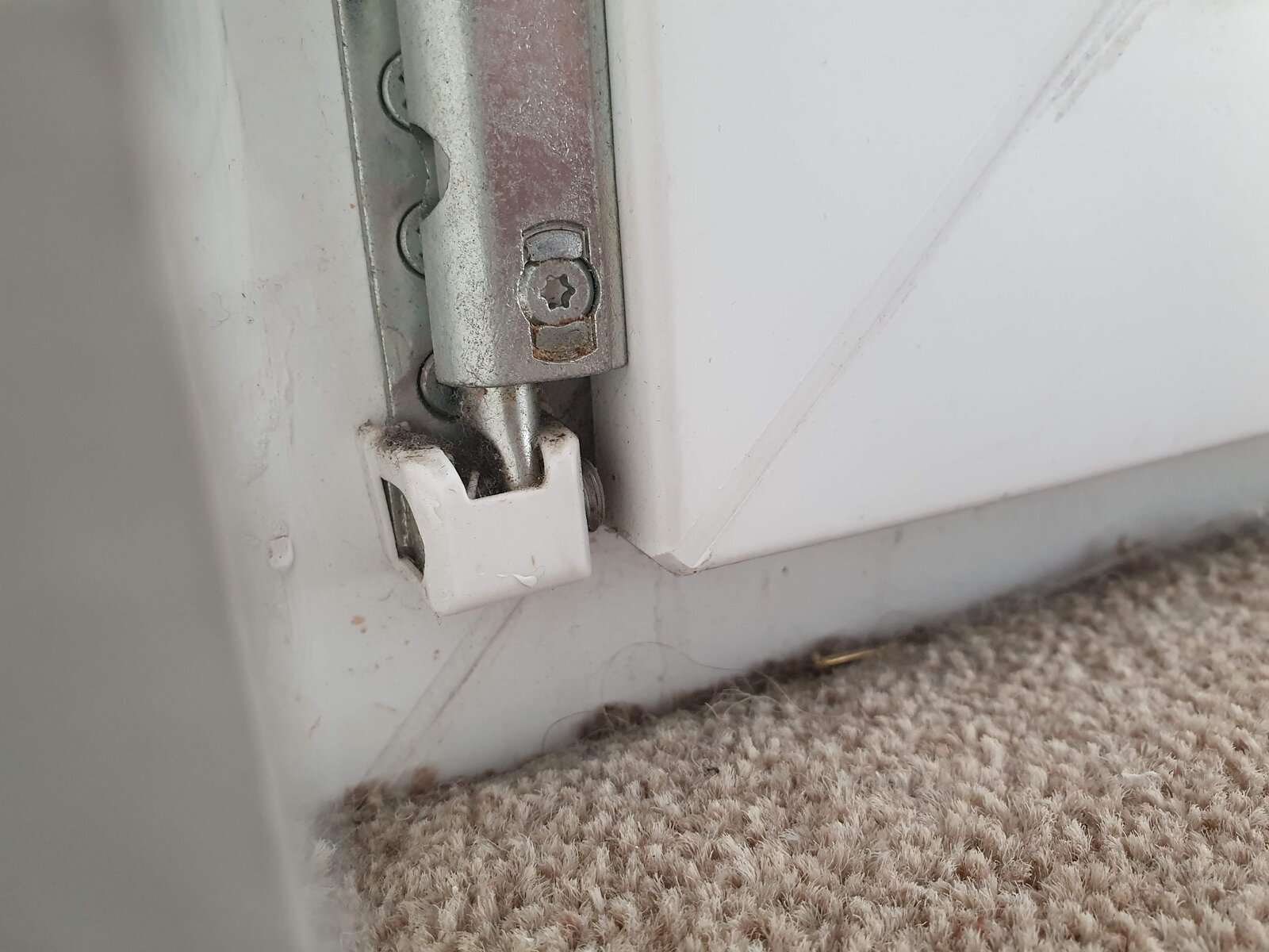

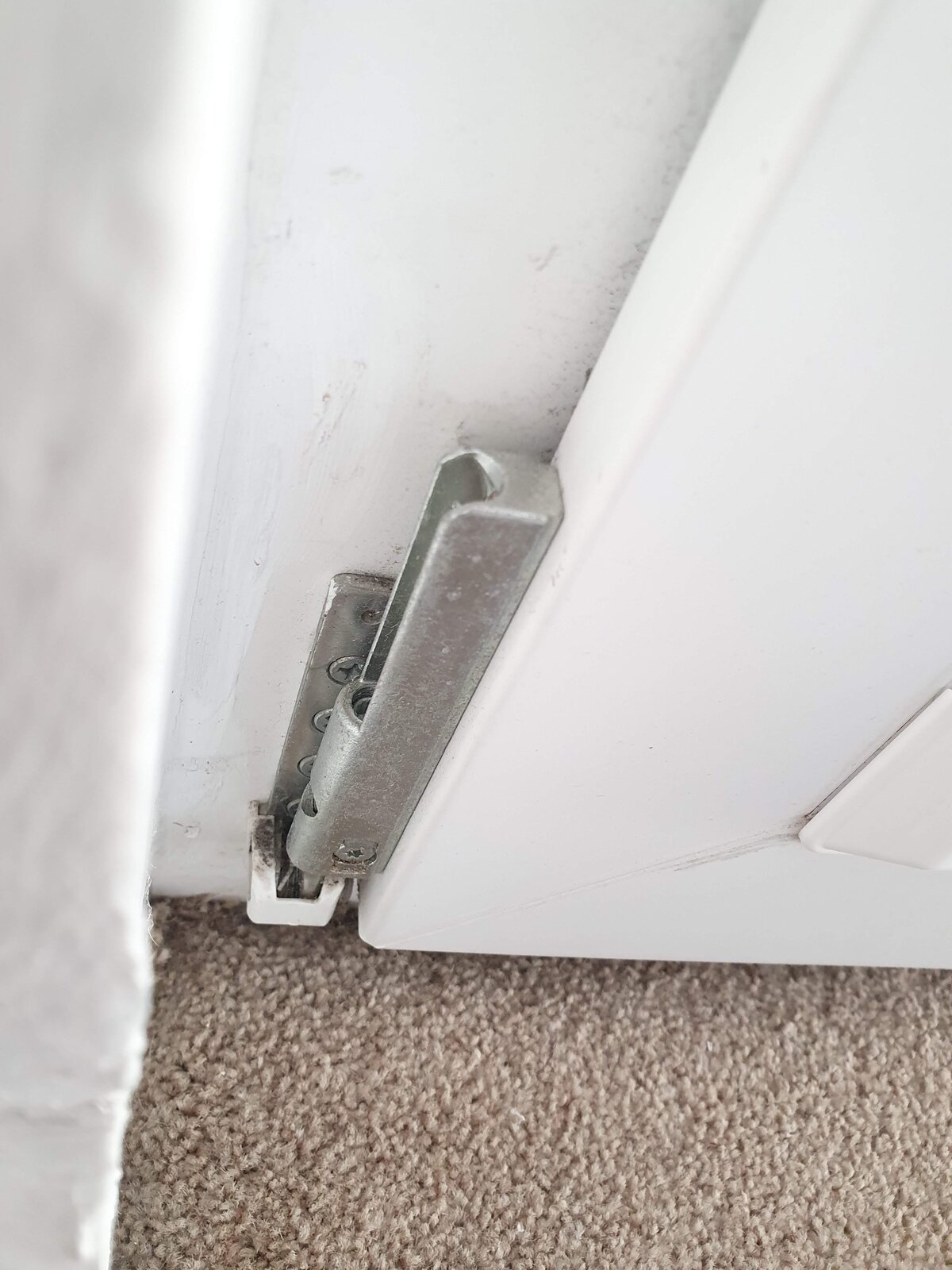

So I need to raise the door as the top locks don't quite engage properly so the top is pretty loose and any gust of wind is a big problem. However I can't seem to see anything quite like these hinges in all the usual places. The most likely suspects (bottom hinges) almost look like they could raise - there is a star shaped screw deep down but quite hard to access) but the top ones are a bit of a mystery to me too, presumably all hinges have to raise otherwise it can't rasie at all? Any suggestions welcome! I tried just packing out the latch on the underside of the top of the frame, whihc would also basically work ok I tihnk as it would at least make the lock engage, but the cacth is in some sort of set of rails / channel so can't be moved down by putting a spacer between it and the frame.

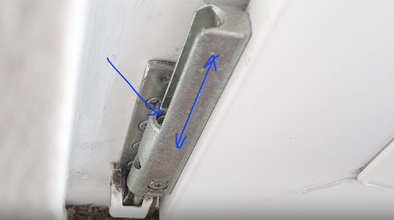

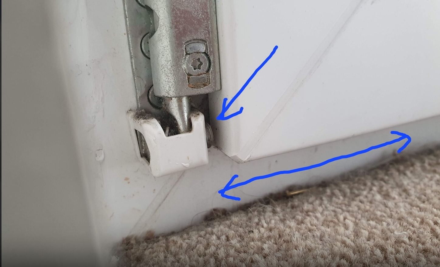

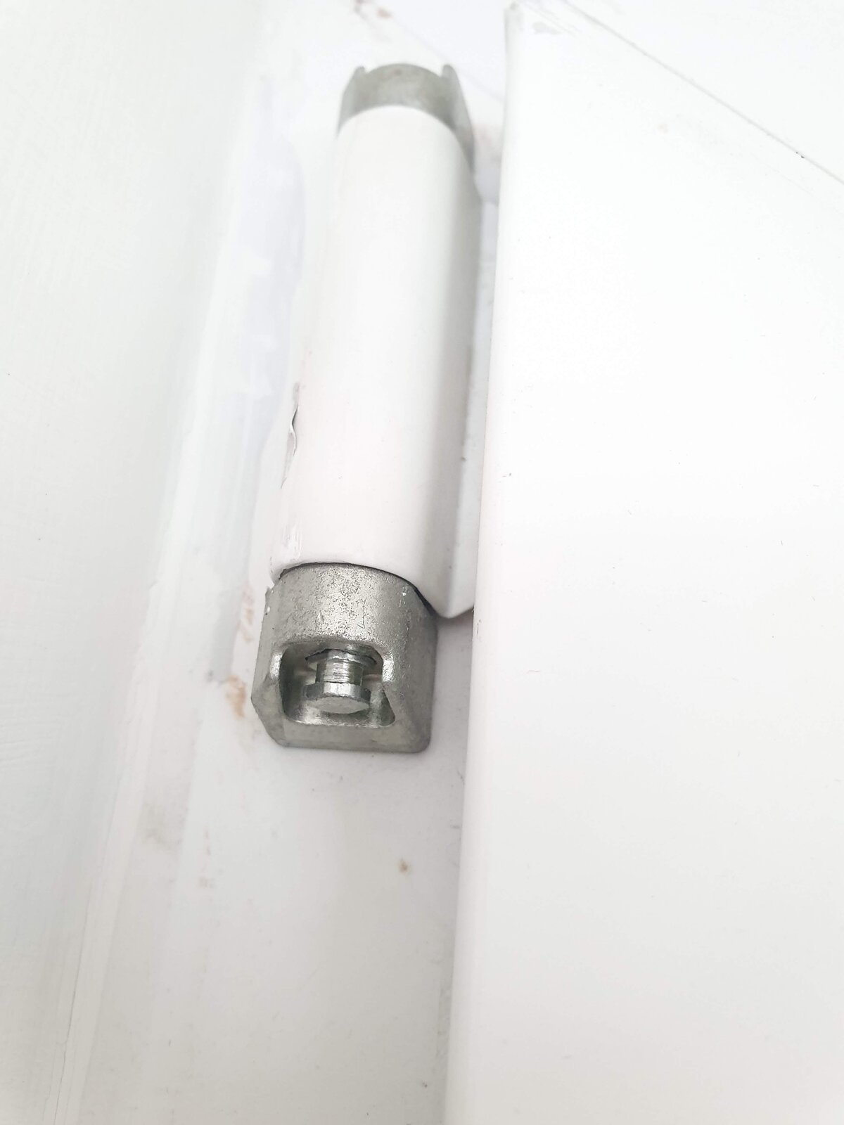

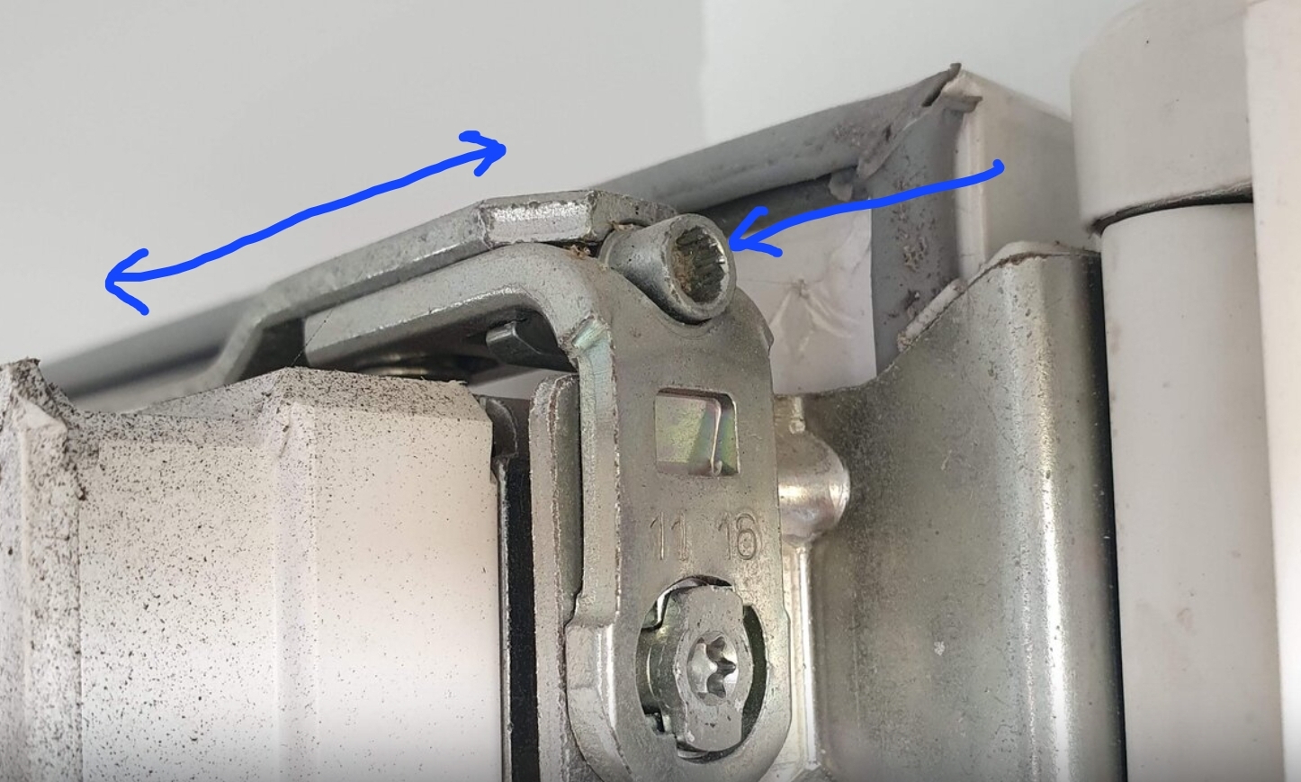

This might be a door to you but its actually a tilt and turn window being used as a door, the hinges and locking mechanism is certainly tilt and turn stuff not the usual door hinge, anyway adjustment as follows.....
Up and down
Bottom of window/door sideways adjustment

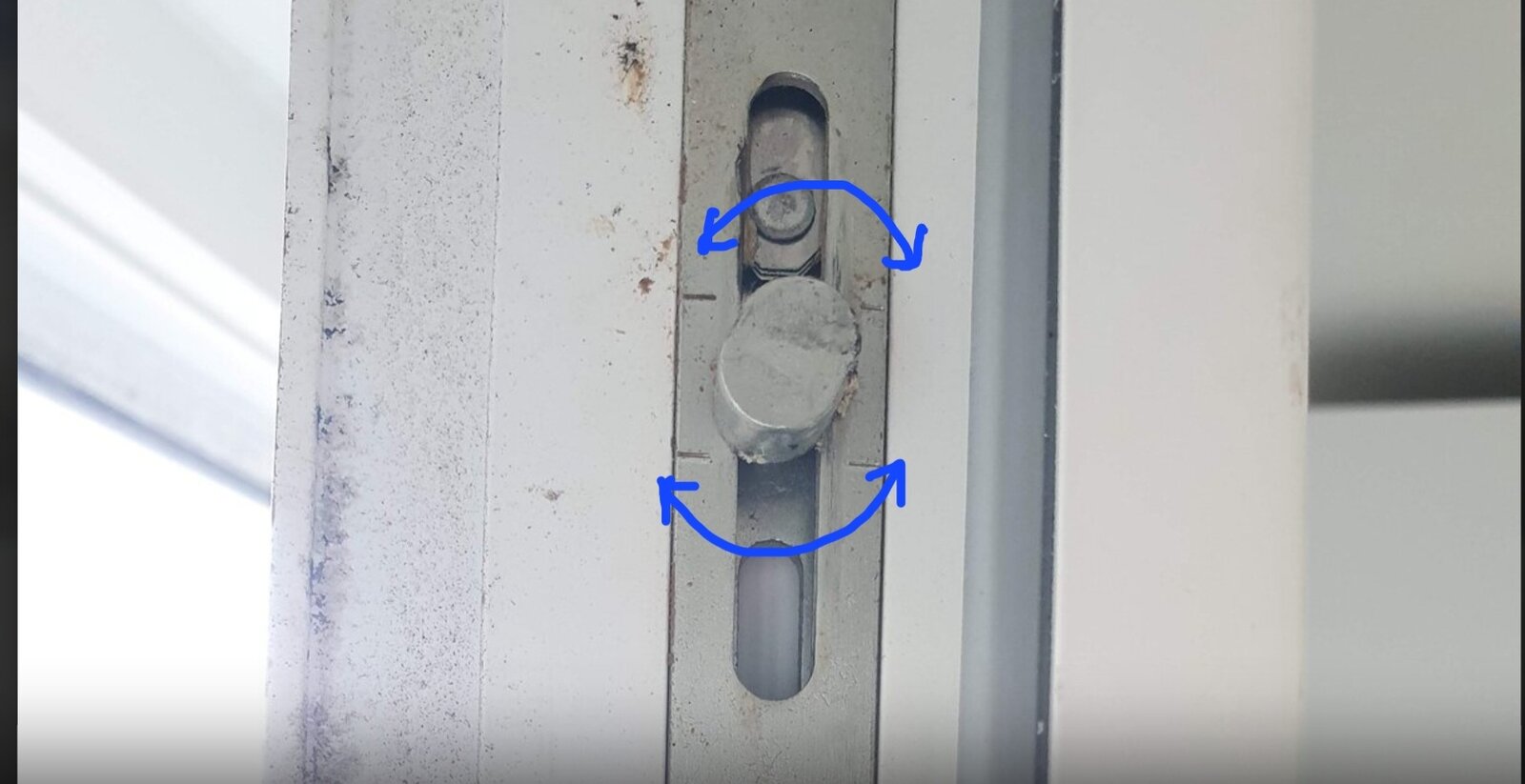

Top of window/door sideways adjustment

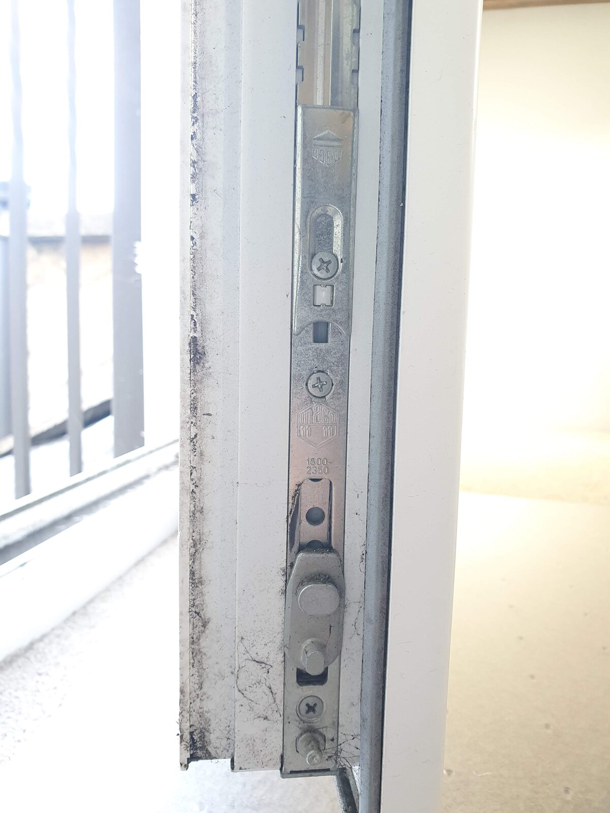

Compression on rubbers adjustment, this goes for all of them
