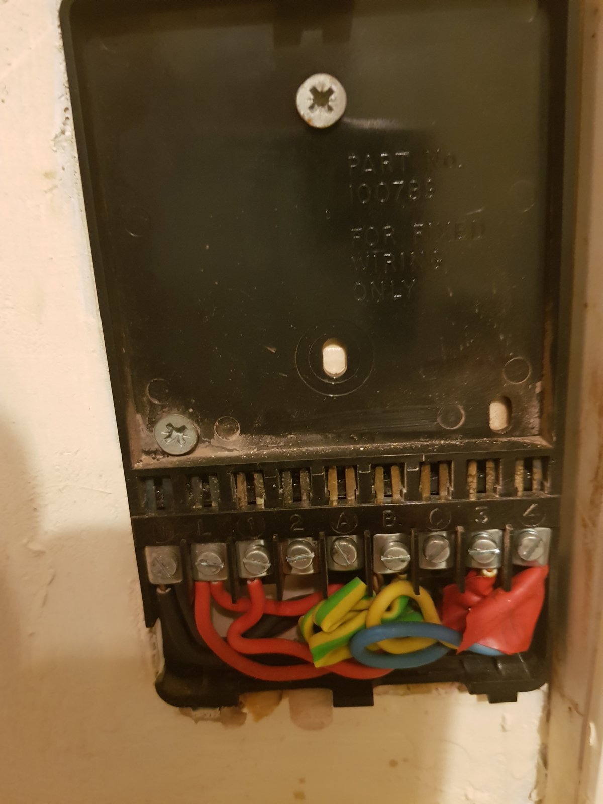

I'm a newbie first post sorry if it's been answered but did a search and could not find answer to my question.

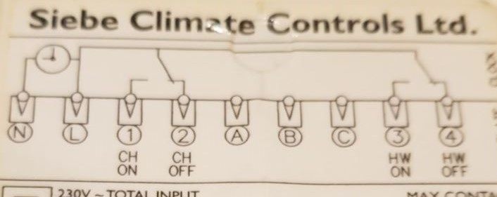

I have a gravity fed system not sure which plan. I want to install a smart thermostat don't know which is better for me either Nest or Hive , leaning towards Nest. I have a Gloworm Energy Saver 50e and a drayton SM905 timer.
I need to know how to wire the thermostats up and which is better for me . I want independent water from heating .

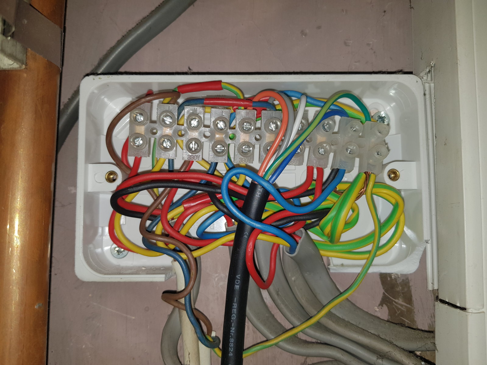

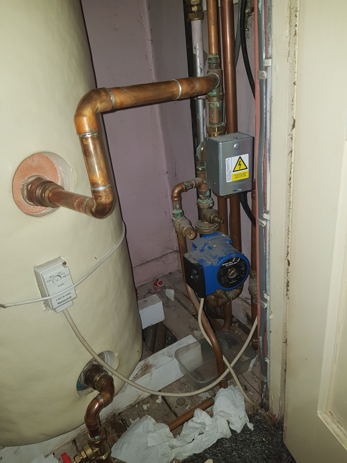

I have attached pics of existing system.
I hope someone can help.me with the wiring and tell me if I can install Nest if not will Hive work.
Eggie99
Your heating is bog standard Y plan, either will work. It has pumped heating and hot water not gravity.

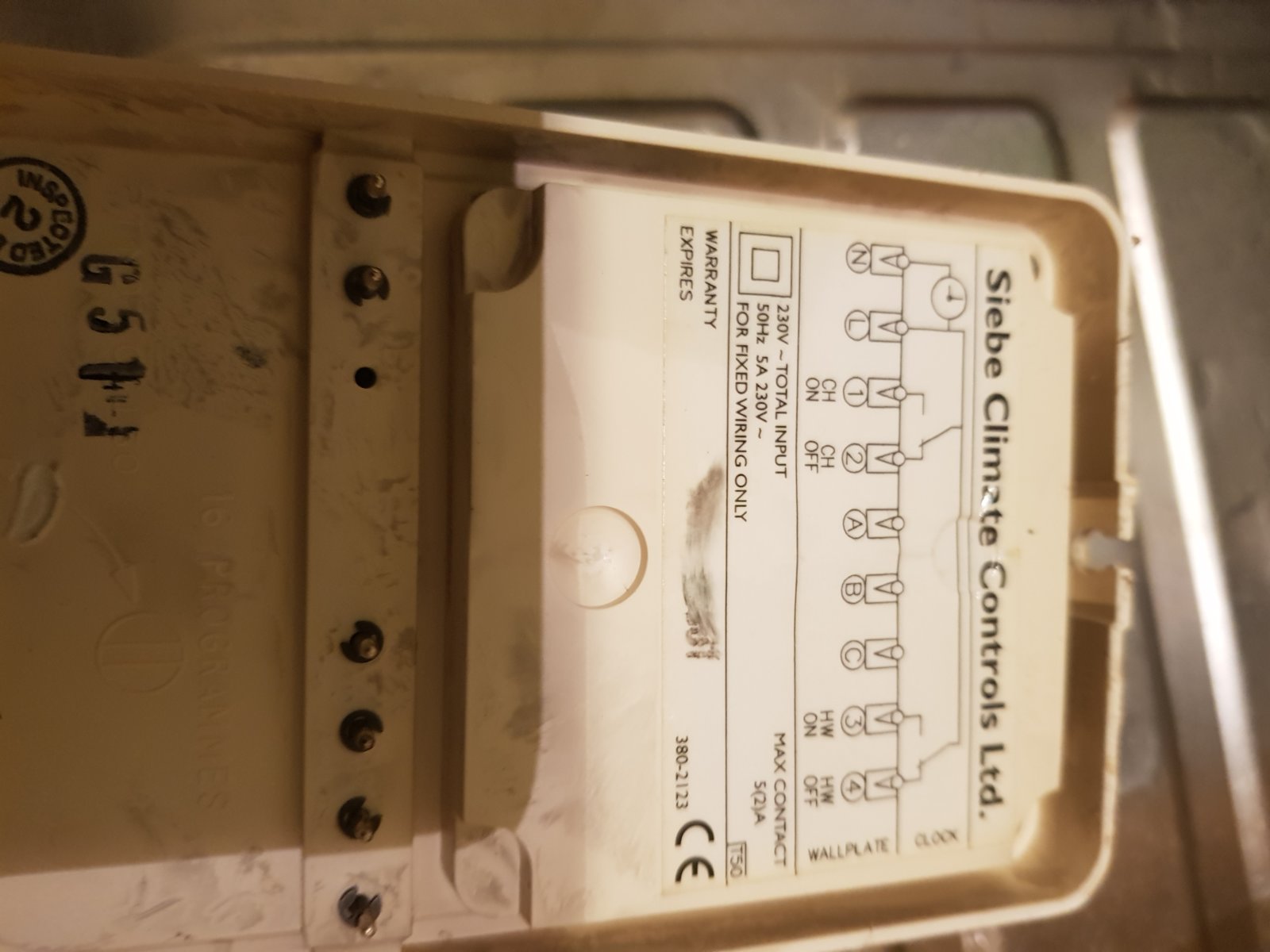

Can you supply any wiring diagrams for the Nest and Hive to see which is simpler to wire. Since I am a novice at this stuff, can do simple like for like but don't know how to go about with these Stats.
Also which wires in my Drayton SM905 control the room stat , cant seem to work it out as I need to disconnect my room stat.

Hi
Thanks for the reply but just need to know where the wires from pic 1 connections which the timer go into which connections in either Nest or Hive connections.
Eggie

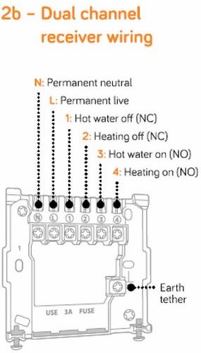

To Fit Hive
The existing programmer connections are as per your photo below:
The existing wires move from the terminals of the old programmer to the terminals at the Hive Dual Channel Version that have exactly the same function. This can be determined from the Hive diagram below.
Terminals A, B and C of the existing programmer don't serve any functional purpose other than to connect the wires in each of them together. From your photo it appears that only B has been used as an earth terminal, so they would go to the Hive earth tether.
You will also have to decommission the old room thermostat. It can't just be disconnected, otherwise the heating wiring will be permanently 'open circuit' and not work. So a wiring modification will be required to bridge the existing thermostat live switching wires. If you need any help with that post back details of the room thermostat and the wires connected to it.

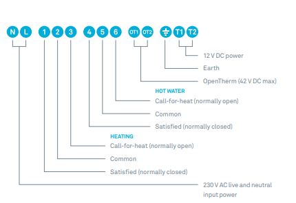

To Fit Nest
Your existing programmer connections are as per your photo below:
The existing wires move from the terminals of the old programmer to the terminals at the Nest Heat Link that have exactly the same functions. This can be determined from the Nest diagram below. The terminology is slightly different, but the function is the same. For example: "CH ON" (existing programmer) is equivalent to "Heating call for Heat" (Nest)
In addition the two Nest common terminals (2) & (5) need connecting to Nest (L)
The Nest thermostat can either be powered from a separate plug in power supply or by wiring it to terminals T1 & T2 at the Heat Link.

Yes, you can bridge the connections at the stat if you don't mind leaving it in place.

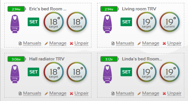

I made a mistake, in hind sight I think I should have gone for some thing like EvoHome it would not have been much more expensive, in fact it may have been cheaper, I have a lovely computer display TRV-report1.jpg I can see the temperature of 4 rooms, however I don't want to see what the temperatures are, I want some thing to read there is a target above current then run boiler, or all targets are at or above current so turn off, however it seems I don't have that option. Even with Nest all I can do is get Nest to follow a TRV or a TRV to follow Nest, and the whole idea was to have rooms at varying temperatures at varying times.
This was my aim, however it did not happen as shown, main problem was the house holds too much heat, turning it up and down simply does not work, turn to 16°C at 10 pm and when ready to turn it up at 6 am it has still not cooled to even 18°C.
So yes the electronic heads have stopped the living room over heating when the morning sun comes through the bay windows, so were worth fitting, but as to geofencing forget it. So use a thermostat on the wall to stop the boiler cycling, but wall thermostats unless modulating are no good to control even a rooms temperature never mind the house. The TRV controls room temperature, the wall thermostat really only switches boiler off to stop cycling as the weather gets warm, so why bother with a smart thermostat.
