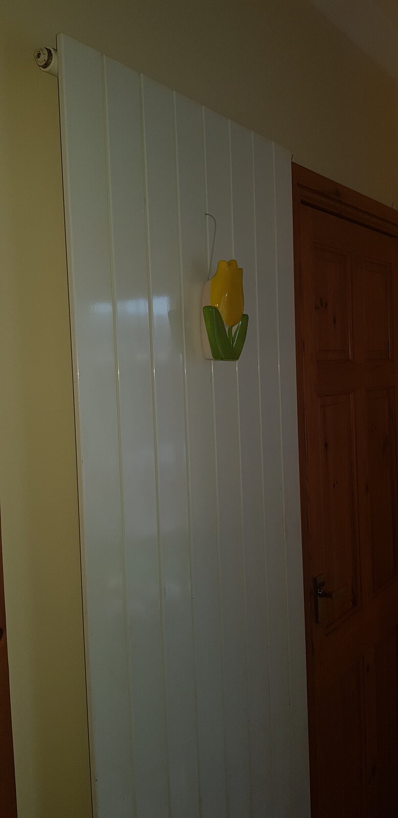

Without hijacking the thread, any recommendation on vertical designer radiator similar to the one in the picture?
I bought it 15 years ago from screwfix and gives out a lot of heat in a very thin design, but they don't have them anymore.
There designer rads, the now defunct Quinn versions are still available as the company that bought them out has continued the designer ranges

Are they good?
Heard that vertical designer radiators can be a pain and not very efficient.

My parents have got what you've got in the picture above or at least very similar and the heat output seems to be adequate for the space (my dad done the calculations can't remember what was required)

Can't find any quinn vertical radiators for sale
