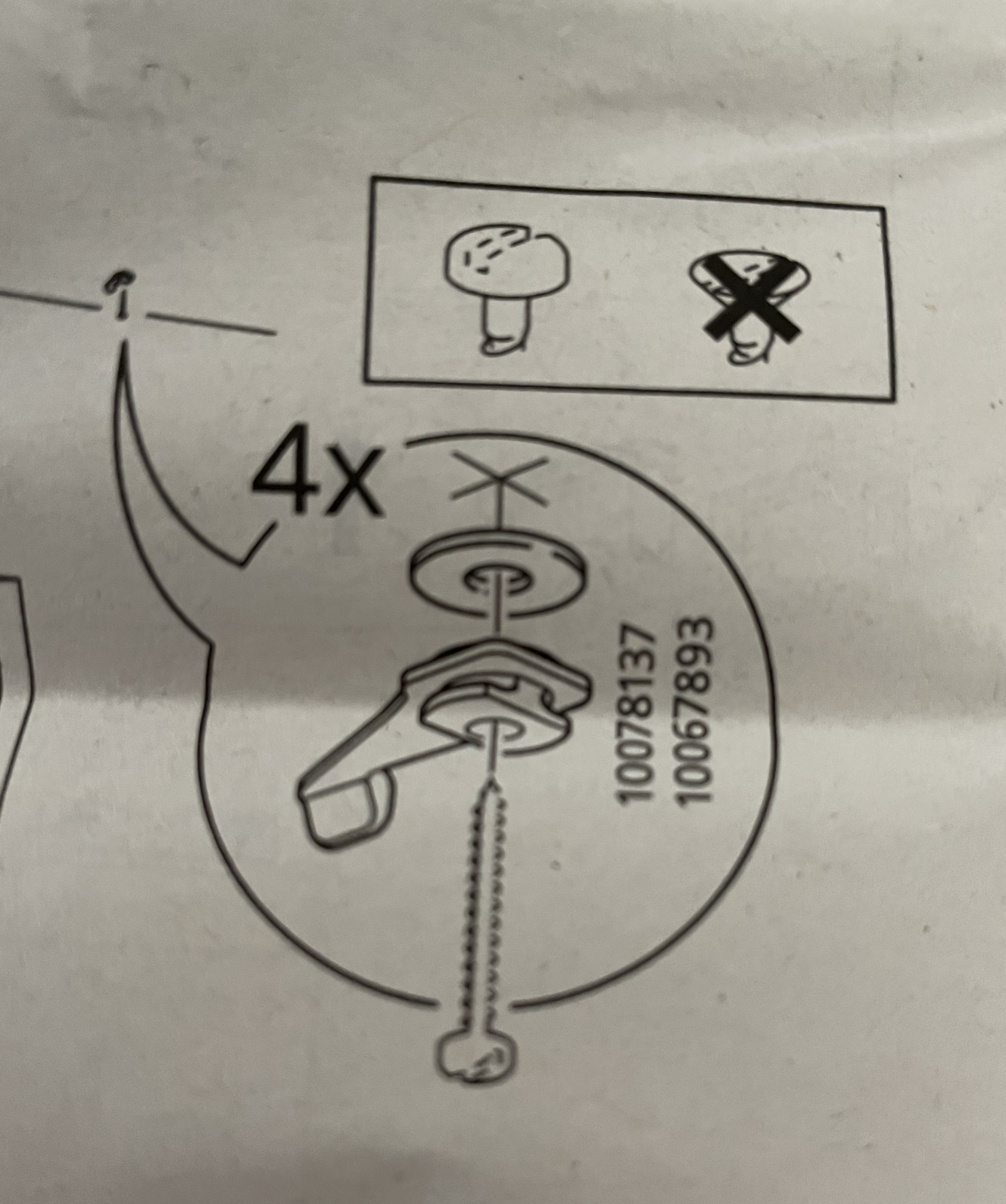

I've previously asked about putting up a curtain rail into my ceiling. I've found the wood beams and I've been told to use wood screws.
Upon visiting B&Q I was met with an entire shelf full of screws and I do not know which one to pick.
Any advice on what to pick?
Here's a picture from the instructions, seems it needs a rounded head?
Pan head screw. Often sold as a self tapping type screw.
Length=Fitting+12.5mm plasterboard+30mm Ish into wood.
Also needs to be narrow enough to go through hole.
Thanks for your help
