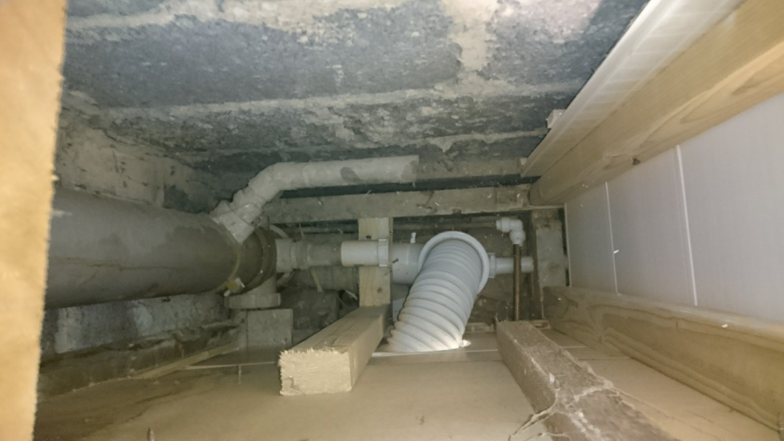

3-The vertical cavity referred to above houses the soil pipe. In the upstairs bathroom there is an opening to the cavity which shows the soil pipe capped off and another open pipe going up, is this supposed to take the smells from the soil pipe up to the loft?

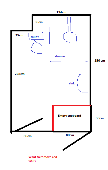

5-I want to board the loft for storage, get electricity to the loft for lights and (if viable) have a tv. The wooden roof planks restrict space. What kind of tradesperson can I contact to get them to be less restrictive? Can I do it myself?
6-The bathroom has a 80cm x 80cm corner taken out beside the door for the old water tank (now removed). Who can I contact to get this wall removed so I can reclaim the space in the bathroom? At the bottom of the cupboard are what seems to be decommissioned remnants of openings of forced air system (like https://cdn.hswstatic.com/gif/how-to-troubleshoot-a-forced-air-distribution-system-3.jpg). Can someone chop these off or will I have to live with it boarded up in the corner of the bathroom (and have a sink over it for example)

5. Need to get a structural engineer to visit, take measurements and make a plan to remove "offending" supports. Unless you want a loft conversion, you won't need steels to remove a couple of supports, so if you're good at following plans you could do it yourself. Most time an A frame is all you need, but a structural engineer needs to confirm it.
6. If you get the structural engineer around ask him. It's a matter of understanding if anything supports something or not. Any competent builder should know.

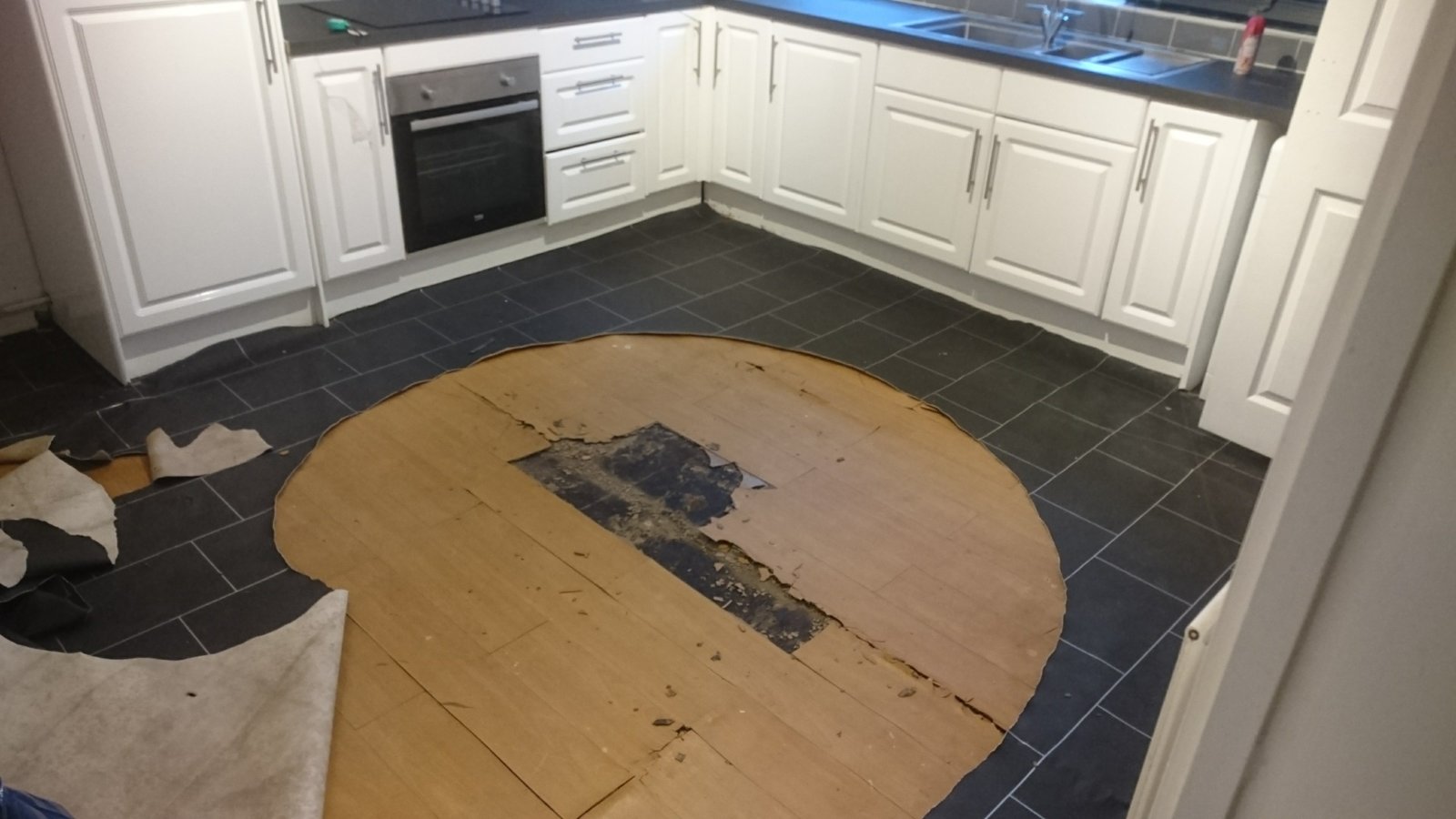

1. Before replacing need to understand why floor is damp.

3. Take a picture, difficult to say

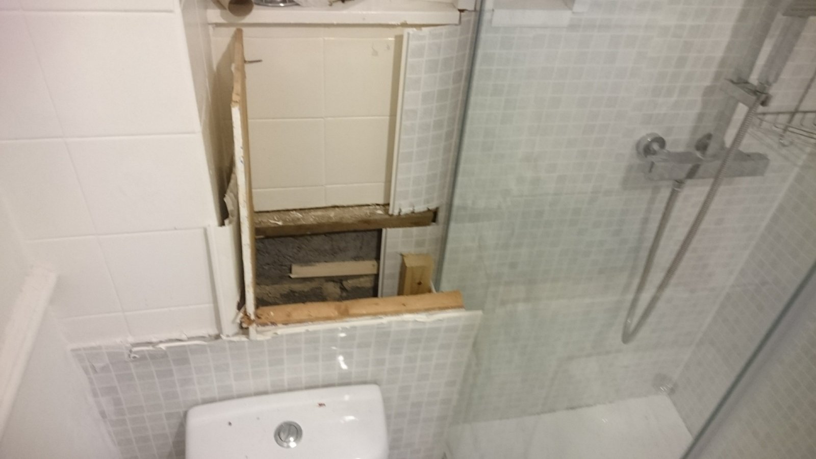

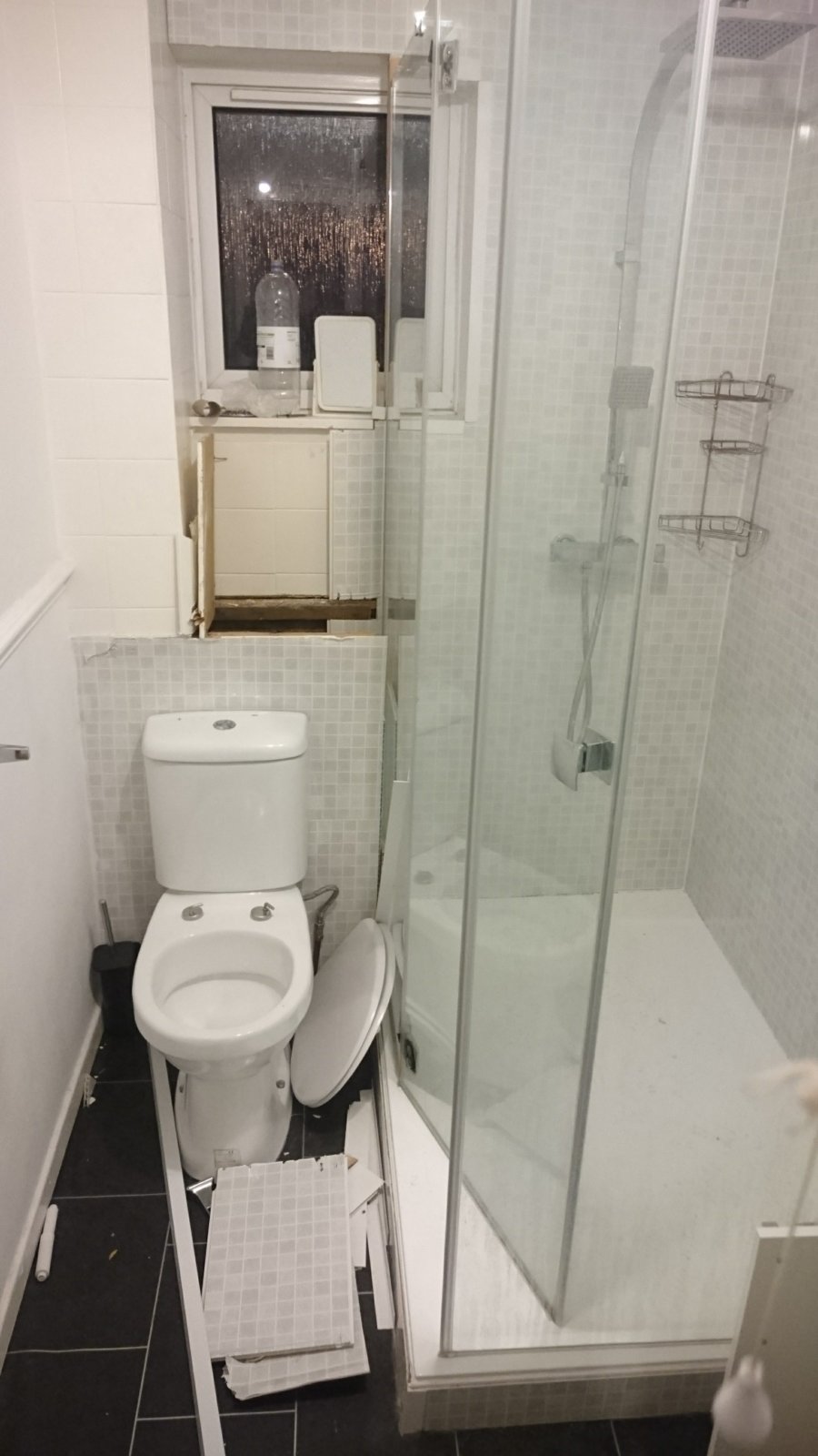

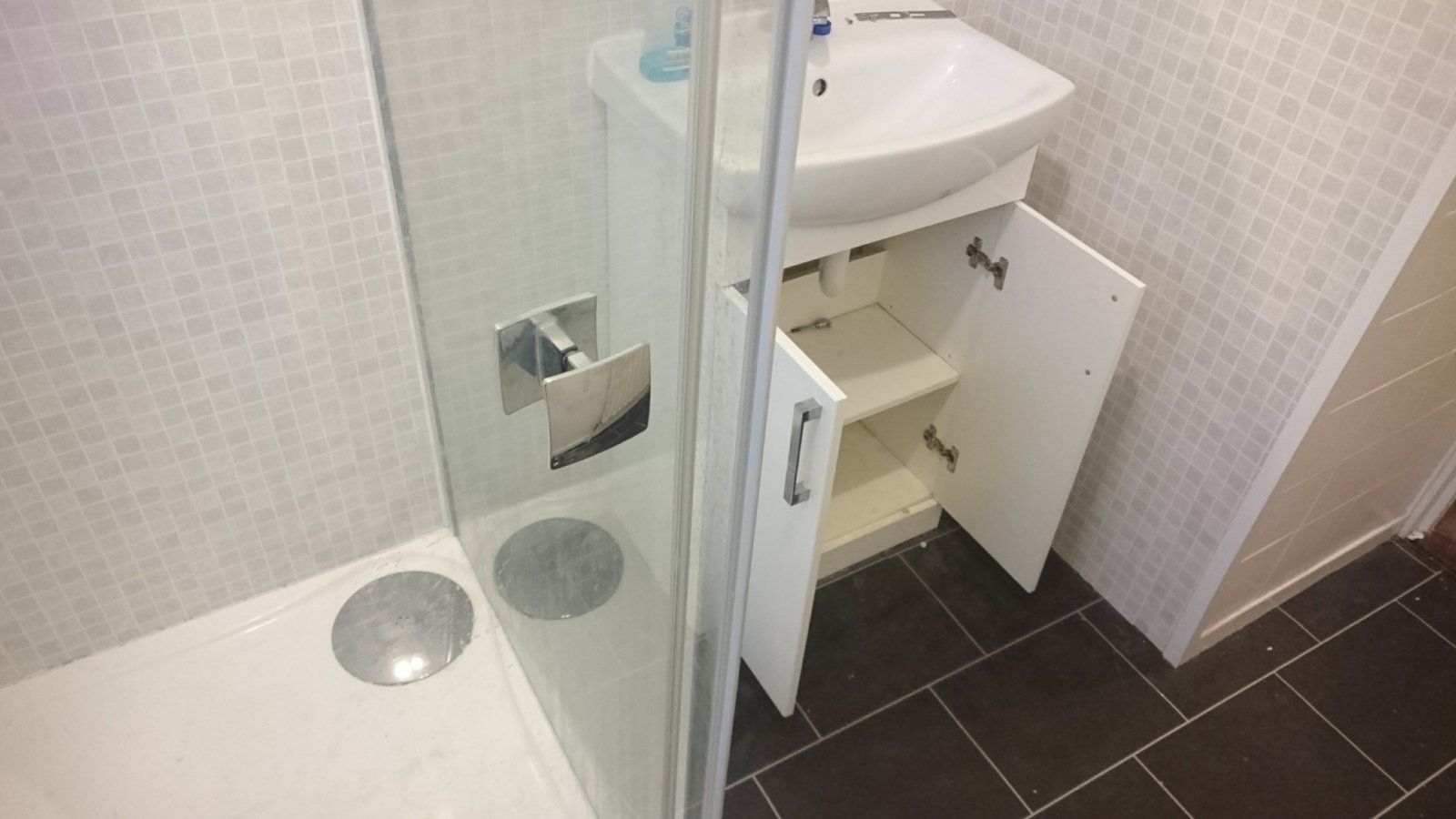

Here they are:

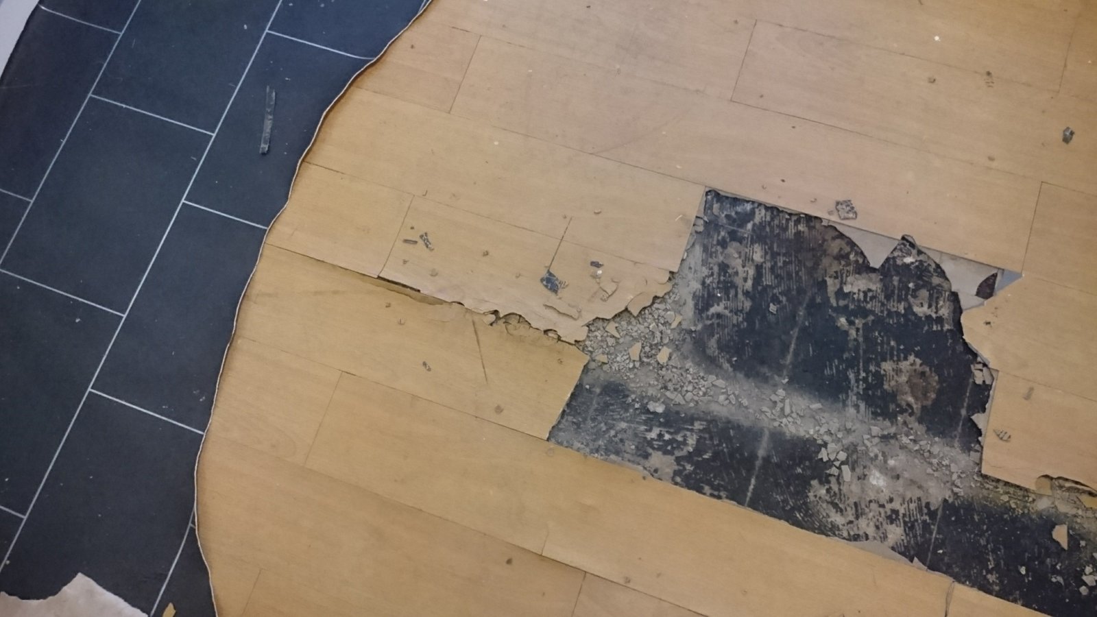

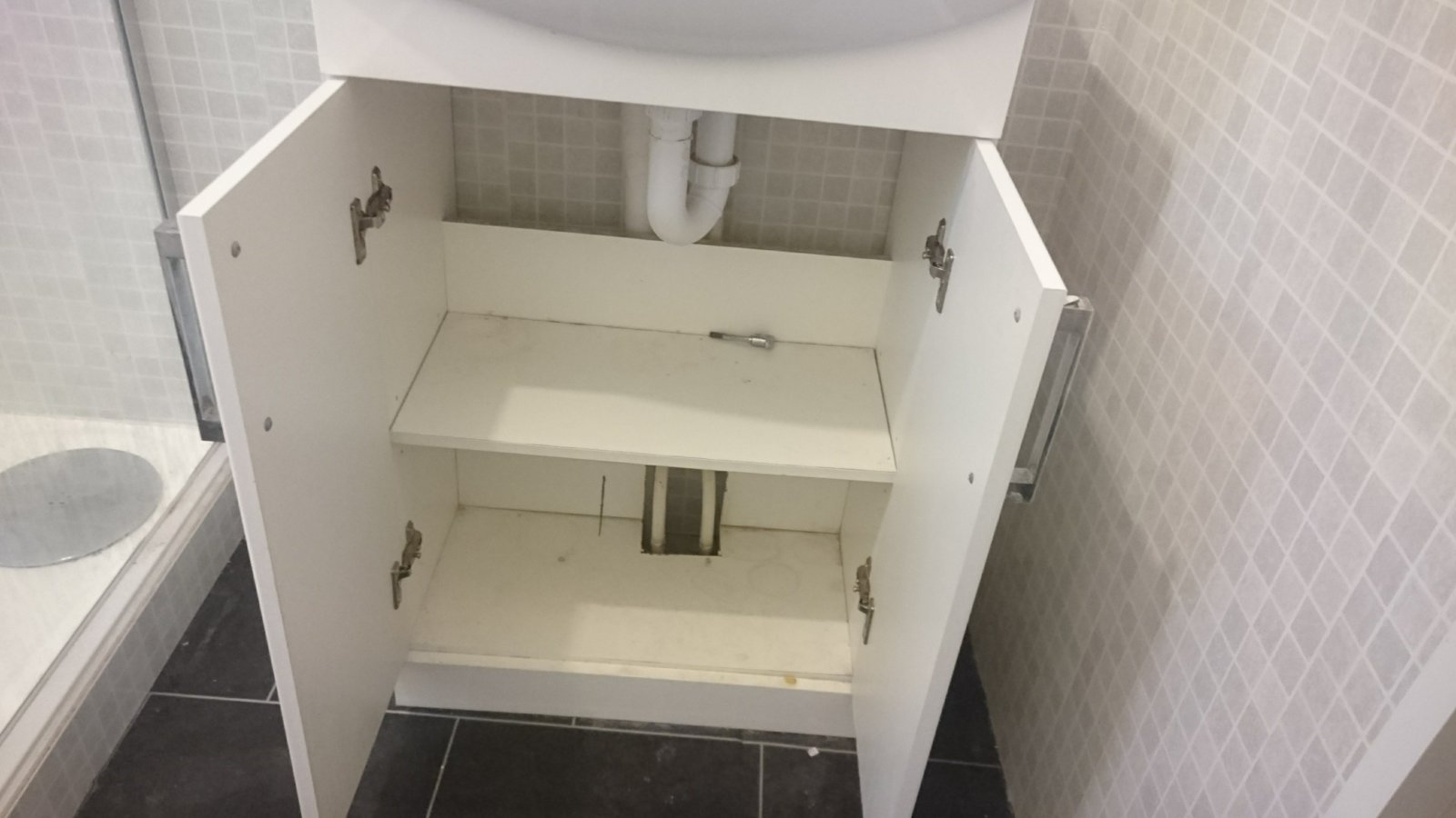

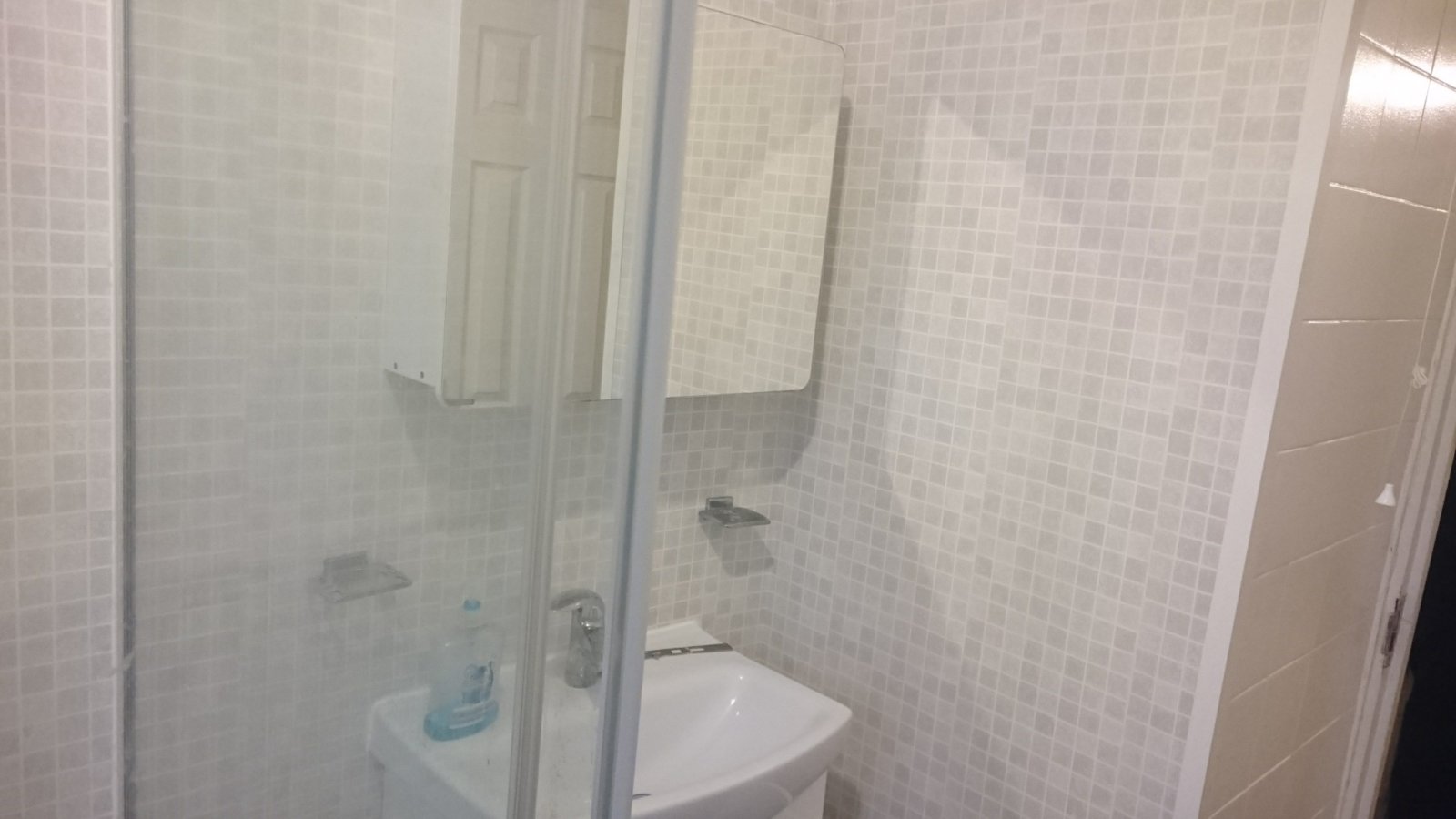

Haven't got time for a good look as I'm at work but there's some lovely bodges going on there!
Vinyl on top of rotten laminate
Shower door opens on to the toilet
Toilet waste fudged
What do you want to tackle first?
Toilet waste fudged

I want things done properly in the order they should be done.
Ideally, I want the bathroom done first, but I'm happy do do whatever needs to be done first.
Thanks.

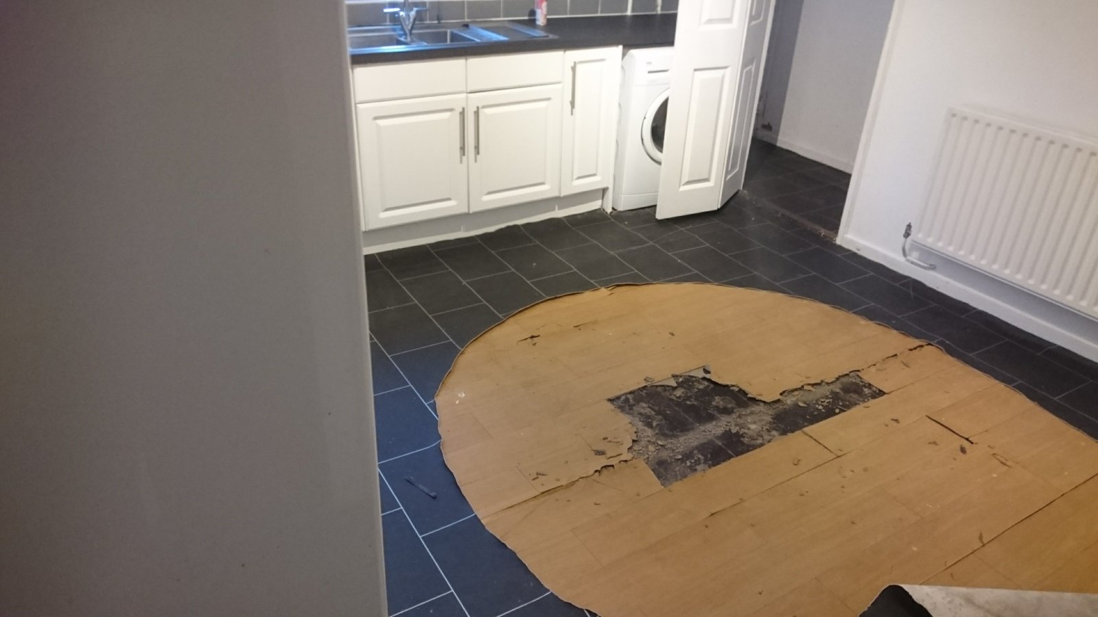

Personally I would get the kitchen floor sorted first , the bathroom although a bodge is livable for now
What type of flooring would you like?
Just noticed your folding kitchen door appears to have been hung the wrong way around
Honestly? I couldn't care less, as long as I can wipe it clean. I'd rather not wood though, kitchens are obviously prone to moisture/liquid spills and I don't want that rotting the floor. I'd pay slightly higher for a longer lasting finish. I know the spongey roll type (is it called laminate?) is more forgiving to dropped utensils but I prefer tiling...what ballpark figure cost am I looking for for both options? room is about 4m x 4m

I have started major woks on the house and would like to revisit/update this.
So basically I removed all the flooring and it looks like thin laminate planks was used. It was damp all over. There was remnants of what looked like black adhesive (builder said it was bitumen). It looks exactly like the pics in this thread https://www.diynot.com/diy/threads/concrete-floor-with-bitumen-paint-more-bitumen-or-seal.486497/.
The floor was very damp when I removed the laminate from it
He said that the dampness in the floor was because it was concrete.
He told me to buy 5 backs of setcrete floor levelling compound, and mixed it and poured it on the floor up to the kitchen counters. He will put LVT tiles on top.
So my questions: I assume I need underlay with DPM under the LVT. Is this enough? or have we made a mistake by laying floor levelling compound over the black stuff?

No help to you , but I just noticed your bathroom looks EXACTLY like a bathroom I saw on homes under the hammer the other day!
It had the exact same layout with the exact same shower door in the exact same badly positioned place!
I do feel for you, there are some shocking tradesmen out there.
