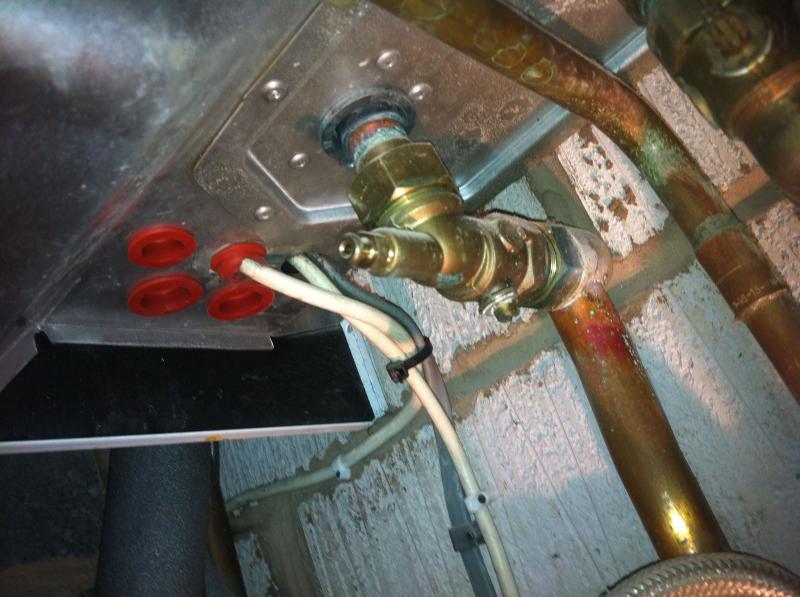

Thats for the reply.
I actually meant the main 22mm flow and return iso valves.
I just took a picture:
Or are these not the type of valves which leak?

thats a vaillant ecomax. Don't touch those valves ! they are ballofix type the worst kind.

Ok mate, thanks!
How do I go about closing this then?
I'm trying to flush my CH system with this guide: //www.diynot.com/wiki/plumbing:flushing_heating_systems
which states:
Before beginning flushing, we need to close the circuit through the boiler so that water can't short circuit through the boiler and has to flow through the radiators. In most cases the boiler isolating valves will be available and shutting one (the flow) is sufficient, leaving the return connection open to give a pressure reading from the boiler pressure gauge (you don't want to risk excessive pressures).
or will it still work?
Cheers,
Adam

Surely you're having a laugh, Ball-o-fix are the worst for leaking,
Run the hot water tap with the control knob set very low but not off, and whilst the boiler is running turn the power off. That will leave the diverter valve in the HW position so water shouldnt be able to travel through the boiler.

The water temperature knob? Also, will the diverter valve got back to normal itself once I turn the boiler back on?

yes on the boiler, there should be a control for the hot water temperature. turn it down. just to save leaving to much latent heat in the heat exchanger when you turn the power off. The diverter valve will sort itself back out when you turn the boiler back on.

The Vaillant iso valves are some of the best on boilers!
The worst are on the Pumas and Halsteads!
Any valves can leak but the Vaillant less likely to than others!
