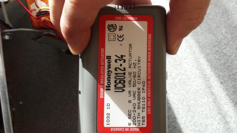

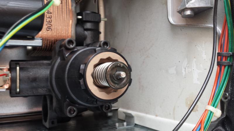

hi guys
the cartridge valve is very very sticky, sometimes stuck half way when i remove the honeywell diverter head off.
what cartridge do i need? is the part number 174200 correct?
thanks
hi
nothing wrong with the actuator.
when i remove the actuator off. the valve stuck in. the spring wont push it out. i had to pull the valve out. its jamming/seize up. sometime it stuck half way.
so i need a new cartridge.
The one I have for this is part number 174201 - 3way cartridge for VC series valve only
