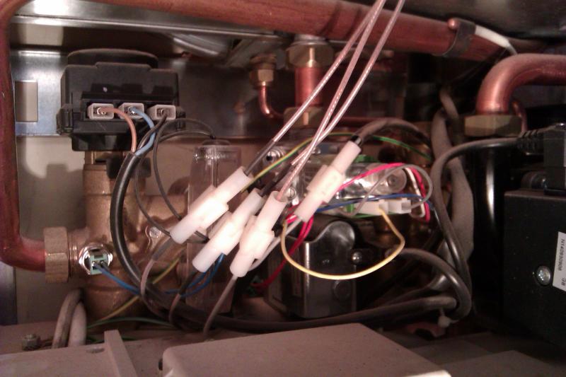

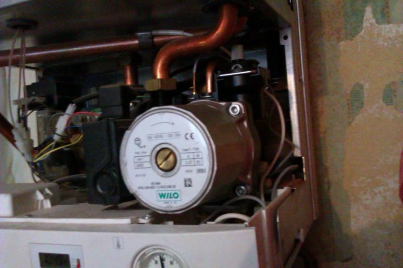

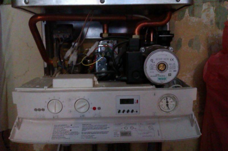

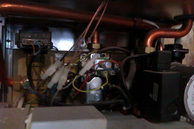

Hi anyone, I have a Biasi M96 condensing boiler which has recently started whistling really loudly whenever I turn on the hot water at the taps or the shower. I was wondering if anyone has come across this before or help pinpoint the reason for the whistling. The sound is not produced when the heating is on but only when I run the hot taps. I am assuming that this is linked to a valve of some sort within the boiler that controls the flow of water or there is something to do with air flow.
If you do a simple test for me then that will enable me to identify the most likely cause.
Turn power to boiler off and see if it still makes the noise.
I also need to know year of boiler or have a photo of the inside lower parts by the pump.
Last four digits of serial number are the month and year.
Tony Glazier
Hi, Thanks for the response. I have done as you asked and powered down boiler and then tried the hot water. This did not make the whistling go away. I have taken a few pics and they are in my gallery under the title BIASI. Also as of yesterday I have also noticed that there is a clanging noise whenever you switch off a running hot water tap suddenly. Its as if there is a loose valve or something along that line in the boiler as that's where the noise emanates from.
