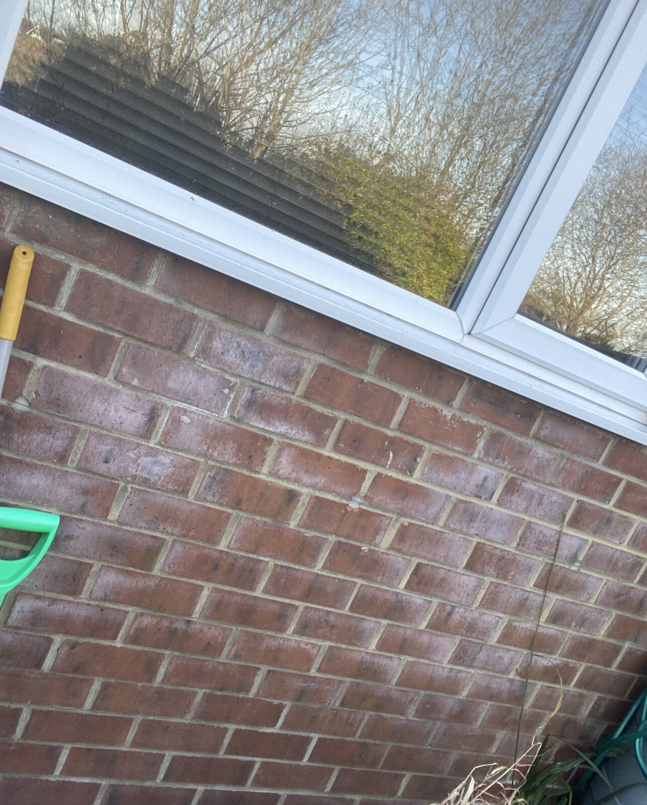

We have an extension that's about 16-20 years old that has just had a white chalk like substance appear pretty much all over the front of the extension. It is just like chalk when I touch it.
Anyone any idea that this is? And how I get rid of it?
Thank you
Picture attached - thank you

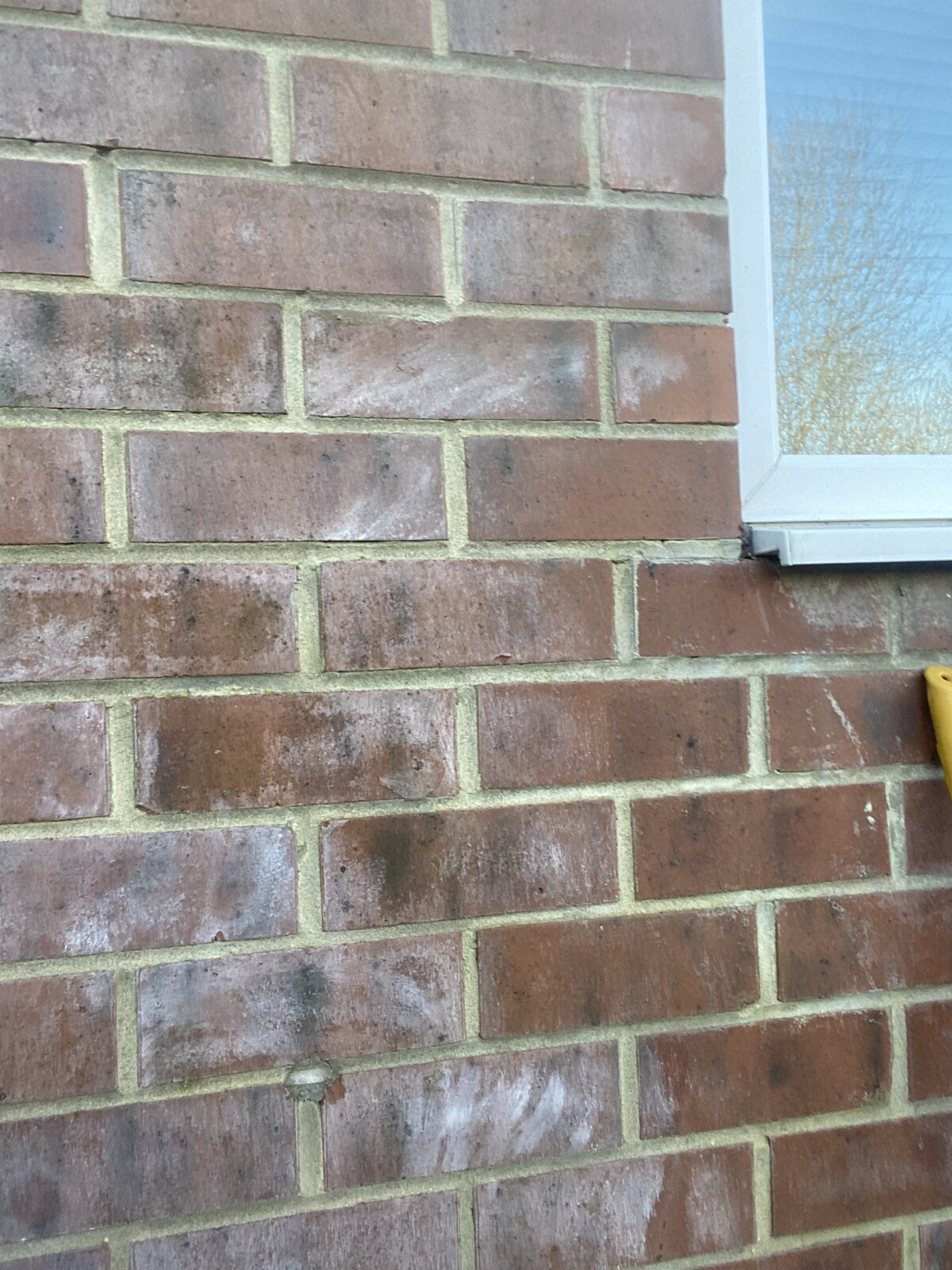

It does like like efflorescence.

Is this the first time it has appeared?
I have seen people recommend brushing on 50/50 dilute vinegar.
Thank you. Yeah first time. All appeared over the last week.
Might have been a result of the excessive rain that we have had recently... Again, not my area of expertise, so I will defer to others. Best of luck.
Its efflorescence alright, and it's a phenomenon which means it appears randomly at any time but is usually associated with the wall getting saturated.
I can tell you that you will never get rid of it, no matter what you try and however much you google for miracle cures. It will go (or stay) of it's own accord.
The only thing you can do is dry brush it to minimise it. Whatever you do, do not try and wash it off.
Thanks @^woody^. Is it harmful to the house at all? We have had horrific weather recently and we are at the top of a hill and this side of the house gets hit quite bad weather wise. I have got a hard brush that I will try on it. Will avoid water on it then.
No, it's just unsightly.
It's salts which water brings to the surface when it evaporates, and just leaves the salts there on the surface. You may be lucky and it disappears of it's own accord.
Use a stiff brush but not too hard if the bricks are sand faced.
