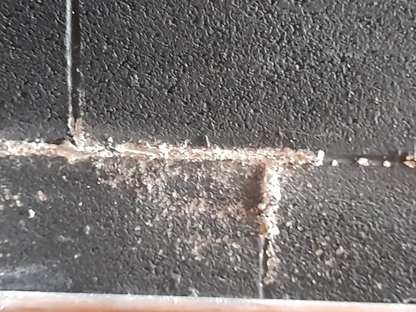

A few years ago I put a false floor into the garage to use the room. Beneath it I put down damp proof sheeting. I then used tanking paint to paint the wall up to the damp proof course sheet level.
A few months ago this started to happen, just in this corner. I assumed the outside might be to blame, so repointed the mortar on that corner but the issue continues.
Looking to find the cause and remedy please

Looks to be effervescence , caused by damp washing thru the salts in the mortar .
Efflorescence - effervescence is what your Sterident does! :whistle:;):sneaky:
Suggests you have damp problem which needs sorting first then the salts coming thru will eventually stop ( but can take months).
Is in the garage extension. Guess I need to get someone to look at it? No easy fix? Considered using some kind of exterior water repellent but could that trap the water in the brick?
