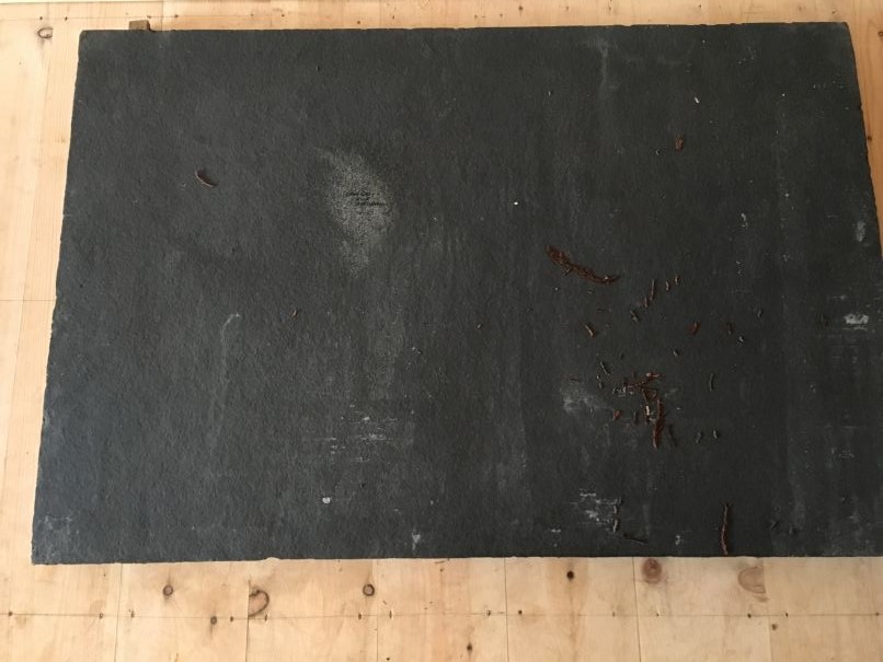

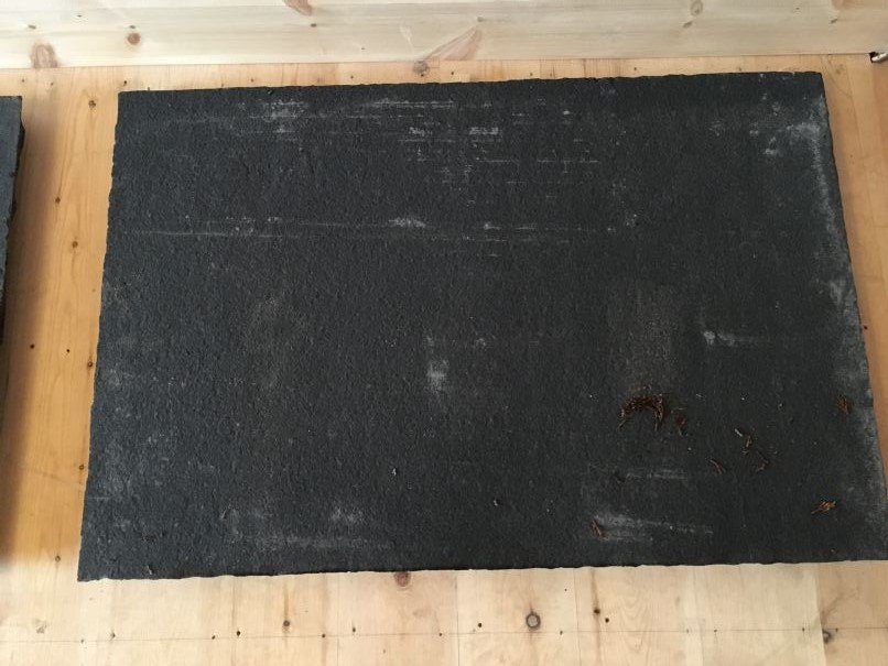

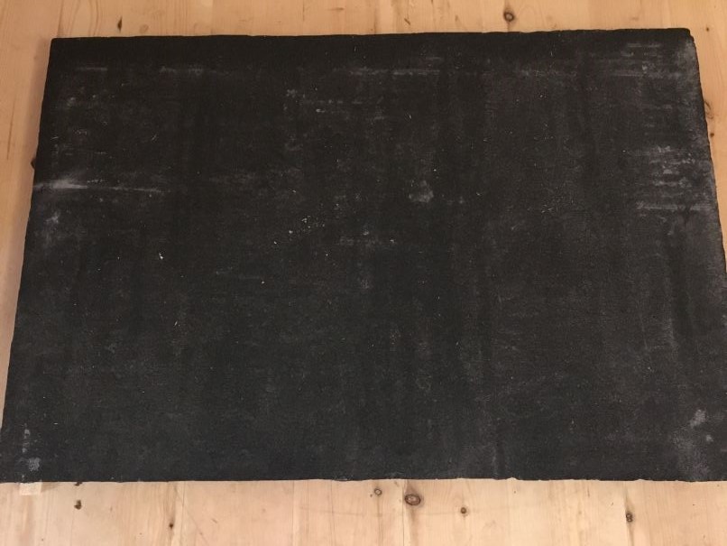

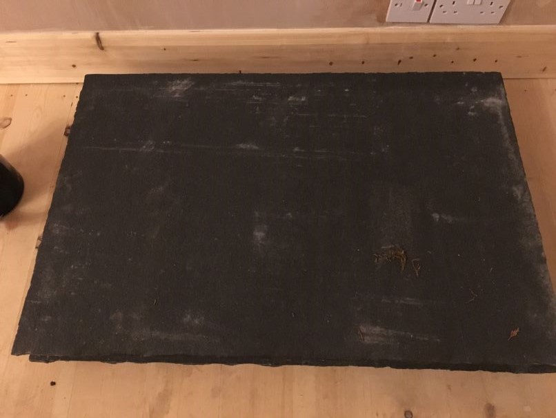

The flags...

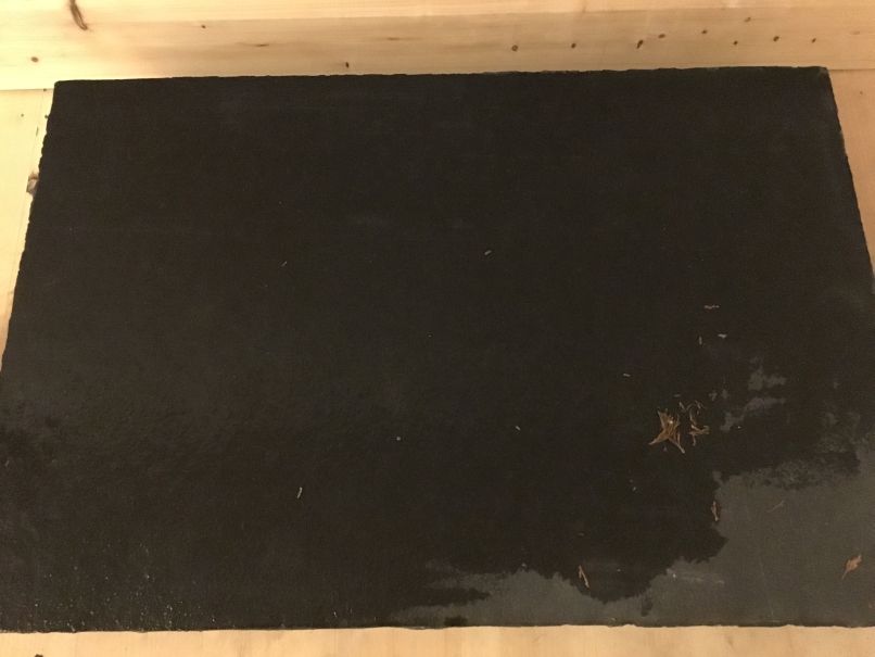

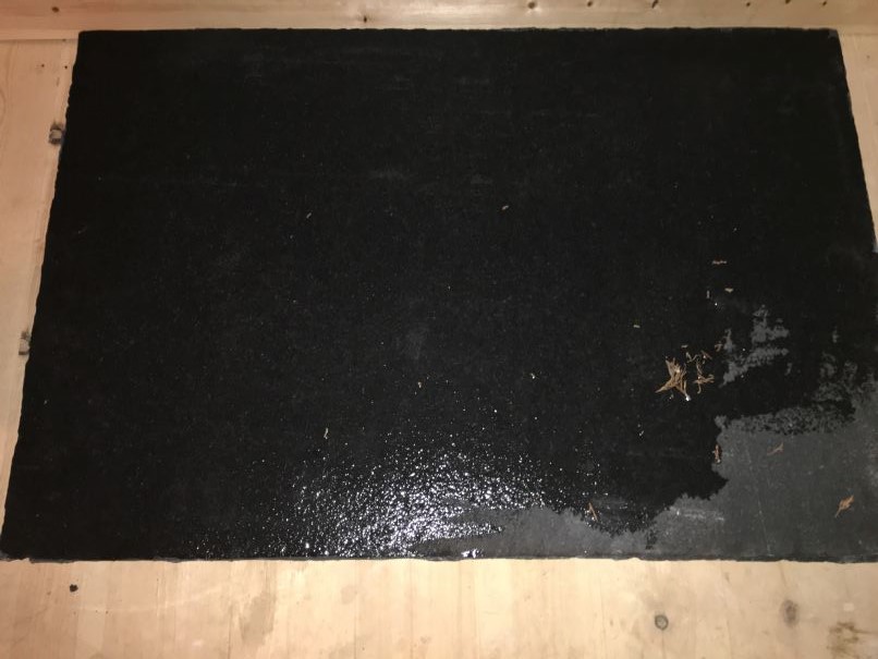

Then today i tried out the water thing to show to you what i mean....
The next pics are of the SAME flag. Dry, wet with & without flash....
What i want to avoid is these flags being put down & having all this horrible stuff showing through once the fire is installed. If i need new flags then so be it.
Try some sealer on one of them. You'll probably find it has a similar effect on the appearance as wetting it.
Assuming it does (& removes the white 'stuff'), what would be the best process here?
Sealing before laying?
I would've thought that this would surely have to be the process because once the fire is on, it's going to be a royal PITA sealing it.
But i don't want to just assume.
